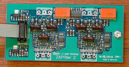

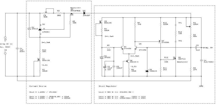

The White audio labs amps used Zetex BJT transistors for the front end with a IR mosfet output stage and sounded very nice. I will try to dig up the part numbers later. I believe Nelson Pass also uses some of the BJTs and mosfets for some of his designs. I like the mosfets for current sources, upper transistors in cascodes, and as followers. They are easily available from Digi Key and the website has good Spice models for most of the devices that I have looked at or designed in. I just received some 1 watt SMTs with an Ft of 165 MHz and an Hfe of about 400 from 10mA to 1 A. Another designer on the forum got pretty excited by the data on this one as well. Several the devices seem to fit into region between small signal and small power transistors. Here is a regulator I found that uses the Zetex BJTs. I think the End Millennium XP Amplifier might use them as well.
http://www.soundlabsgroup.com.au/lc..._millennium.htm

Another couple Zetex users
http://www.altavistaaudio.com/solid1.html
http://www.soundlabsgroup.com.au/lcaudio/lc_audio_zapfilter_mk2.htm
