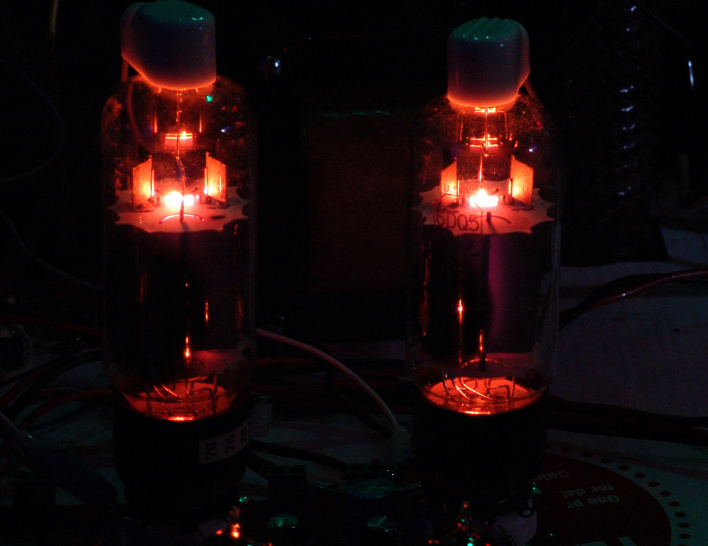

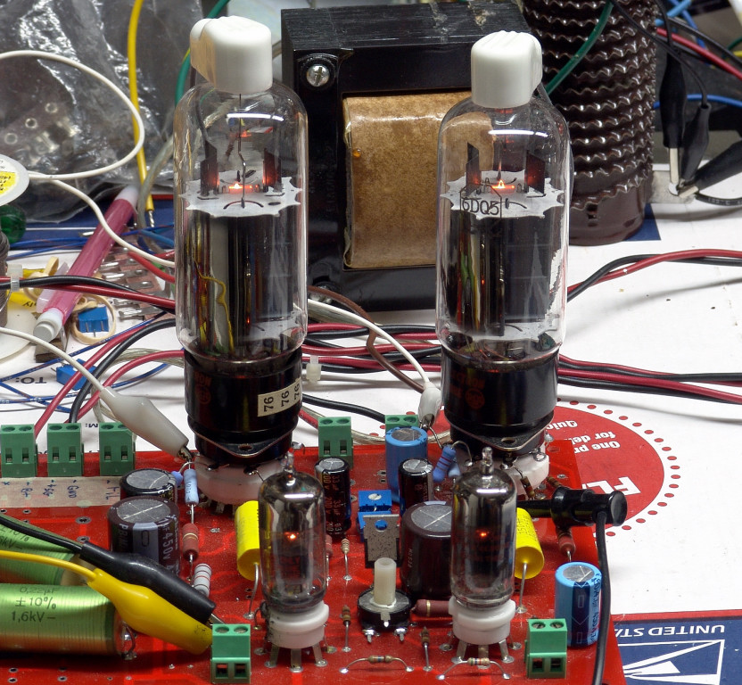

OK, it is Sunday and for the first time since July 4 I am not at work. So....time to make 'em glow. I had guessed that the 6DQ5 would make about 100 watts at 550 volts and a 3300 ohm load without melting. Speculation on the bias current was 30 to 40 mA.
So I wired a pair of 6DQ5's into the red board, set the screen supply at 150, the plate supply at 550, and adjusted the bias current for 30 mA. I applied enough signal to get 1 watt and tweaked the bias current and the balance for minimum distortion. 0.37% distortion comes at 33 mA and more or less current raises the distortion although it remains under 0.5% from 27 to 50 mA.
I then applied more crank. As the input signal went up, so does the output power and the distortion. 50 watts makes 1.89%. 100 watts gives 3.27%. I usually state amplifier power as the power at which the distortion crosses 5% which comes at 107 watts. Crank it till square waves appear reads 129 watts although this is not an accurate number.
The tubes show a faint glow if left at 100 watts for several minutes in a dark room. Since the power goals were met at 550 volts, I see no reason to go higher since more glow would appear, or the bias current would need to be reduced.

The red board uses both local (Schade) feedback and Global Negative Feedback. I am using the local feedback which is a resistor from the plates of the output tubes to the plates of the driver tubes. This lowers the output impedance without sucking the life out of the sound. I am not using the GNFB on this board since all of my listening tests have sounded better without it despite slightly higher measured numbers. Applying negative feedback will not reduce the available power output. It will reduce the total amplifier gain so that you will need more input voltage for a given power output.
