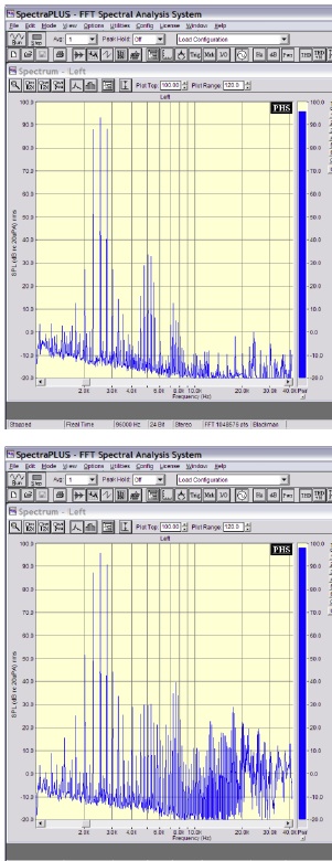

I don't know a lot about it, and the weighting or importance of frequency vs. audibility. I was shown this plot as a distinction between two different types of components. The second order harmonics are lower on the second component. But the third, and IM are much higher.
It is a complex signal of three different tones, two of them down in level from the first.

Remember: there can't be IM distortion without harmonic distortion.

Jack, if the harmonic distortion is low, then the IM distortion is low, too. At least in most cases. Remember: there can't be IM distortion without harmonic distortion.
Of course you are right, and comparing speakers by multitone measurements gives good results, although I am not sure how to weight some of the difference: is high IM at 4 kHz more audible than high IM at 400 Hz? I don't know, but I assume it has something to do with the usual maksing effects, which are somehow related (but not the same) as the equal-loudness contours, and so I would say that the 4 kHz IMD is very important, while the 400 Hz IMD is not so audible. Maybe someone else can shed some light on it.
HD and IMD are just different views of the same issue - nonlinearity. It has been shown that there is no correlation between HD or IMD and perception. Thats not to say that nonlinearity is not audible, just that IMD and HD don;t tell us anything about it that is relavent to audibility.

Earl points to this already. IMD and HD have the same cause, that's non-linearity. If there's no non-linearity, there is no HD. If there's no HD, there's no IMD. It's just that simple.
If you measure low HD, you likely will measure low IMD.

I don't understand what you mean by this. Levels of IMD and HD don't tell us how audible nonlinearity is?
That's what I mentioned above: you have to apply weighting to those numbers, otherwise you just can tell which device is more linear than the other.
Take two drivers, one produces 0.1% F2 at 1 kHz/90 dB, the other one 0.5% F2. If you compare both, the latter one looks horrible. If you apply proper weighting then you realise that both distortion levels are not audible. So why take the better, probably much more expensive driver? No question that we WILL take the better one, because we are all completely insane 😀
It's the same with IMD, just much more complicated. Which tone modulates another tone at which order of intermodulation? Which signal is best for testing, bass sweep, voice sweep, 2-tone, dense/sparse multitone with high/low bandwidth? Very difficult.
