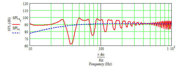

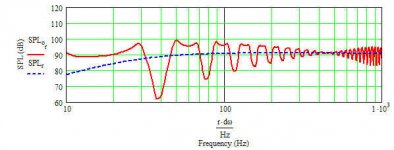

Being a rather pragmatic sort, I don't have any interest in wasting my time indulging in 'flights of fantasy', especially when trying to help folks meet an audio performance goal, and haven't asserted that it can for sure be done, though from experience with making house shaking bass I postulated how it might happen if the driver's published specs are 'close enough' and the room isn't a complete acoustic sieve down low.
To hear infrasonic frequencies requires a rising response with decreasing frequency, so hearing them below ~16 Hz is pretty much out of reach, but to just 'feel' it we only need to energize the structure, which doesn't necessarily require as much SPL. I literally cosmetically busted up my home from floor to ceiling and structurally damaged it to some extent with BW limited ~16 Hz pipe organ music at ~live levels, but sweeping it with a sinewave generator to find resonant modes didn't consume nearly as much power.
Anyway, I just 'ran the numbers' for a straight taper TL to see if my experience based 'postulation' had any merit and with the above caveats and further assuming MJK's WS is reasonably accurate down this low (it's 'close enough' IMO), I'm satisfied that I'm somewhat more firmly 'planted' in the real world WRT this driver/app than you.
L = 341.56"
CSA = 306.25"^2
zdriver = 7.5"
At ~60.54 ft^3 net, it's ~ the size of the average closet (at least where I live) and calcs nominally flat from ~5 - 30 Hz/90 dB min. half space sens, so when folded up so both the driver and terminus are together at the bottom, then once the optimum distance is found from the corner's apex to complete the BP there should in theory be enough in-room acoustic sens to offset the driver's otherwise mechanically limited gain in the 10-25 Hz BW and enough peaking at Fp to excite 5 Hz. Only one way to know for sure though..............

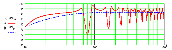

Hara said:I think a more realistic goal is output to ~13 hz which is the fundamental of a helicopter. However, now I'm probably wanting up to 40hz, with a much better frequency response.
Greets!
Then a MLTL tuned to 13 Hz is your best option IMO, though at ~12 ft^3 net it's still going to be pretty big by most folk's standards.

Wow... you actually came up with the curve I was originally looking for. I'm still trying to gain some intuition using these models. The insight I learned so far was that widening CSA usually lowers average spl, lowers the extension, and somewhat flattens the response while tightening does the opposite. I have been experimenting with somewhat of a large port for a MLTL and was able to shorten the line a bit given a different set of design goals.
I'm glad at least the curves shows the somewhat viability of using TLs for really low extension, but rather than pursuing this pipe dream, I now am raising the tuning frequency in order to have real world usability.

BTW, I'm trying to simulate the super low sub with your parameters. A CSA of 306.25 "^2 is 1974 cm^2 and thus 2.48 * Sd of 805 cm right? Also, zdriver would be driver offset so the center of the driver is 7.5 " below the closed end?
For some reason my graph shows a downward sloping response starting at 30hz maintaining a 5db increase relative to the IB model.

I use Convert.exe, which calcs 306.25"^2 = 1975.803 cm^2/804.248 cm^2 = ~2.4567*Sd.
Right, 'zdriver' is just half the driver's overall diameter (o.d.), which is acoustically the same as end loaded, putting it right at floor level for max boundary gain.
Don't know why you're not getting the same plot. I used the measured specs on the pdf plus the 'Sd' I posted.
