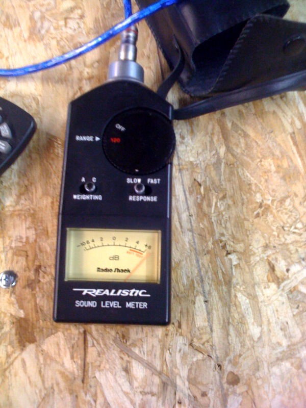

what'd he say??? Not sure I heard that....
130dB in the living room just isn't practical in most cases.......
Who said anything about practical? I'm doing this for fun. 😀
In all seriousness, I am building a monster of a home theater system, not a monster of a PA system. I am confident that the planned subs will come very close to 130 dB in room at 20 Hz. Hornresp tells me so. If I successfully measure what I have, model what I measured, and build what I modeled, I will get very near what hornresp predicts (to be honest - these are some big "ifs"). If not, the discrepancy is mine to figure out.
Honestly, they will rarely get pushed to 130 dB and certainly could not survive running at that level all night long. My current ones peak at 120 dB at the listening position at 30 Hz, but the response looks like a rollercoaster both above and below (exactly as predicted by hornresp....).
I know the planned mains will get to 120 dB in my room - my current system reaches 115 dB (listening position) crystal clear (before power compression and distortion sets in), and my current ideas add 6 to 10 dB to the 1W efficiency of my current MTMs while more than doubling the power handling capability.
The last tapped horn sub I built (documented over in the collaborative thread) put my SPL meter over 120 dB from 30 Hz to 160 Hz during in-room testing when it was corner loaded. I still had a bit of amplifier power remaining. Total volume of this cabinet (external) was just over 7 cubic feet. Hornresp says I should be able to reach 130 dB with this box corner loaded at 500 W, but that is well past the thermal limits of these drivers. I am more than pleased with the results, but I know I can do better.
I'm pretty sure I can get to 130 dB with more (and larger) drivers, more watts, and a pair of bigger, better enclosures corner loaded. As usual, I've got everything but the enclosures and the time to make them. If I don't get what I'm after with this try, I'll do a jbell on the failed attempt: I'll pull the drivers and speakons, smash up the boxes, roast some hotdogs over the remains and try again. 😀
