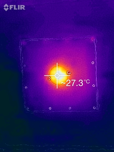

Tricky to focus. At least mine is, and the laser guide is above the sensor, so needs compensating for. But in principle, a useful tool.
Interesting idea, but since you don't want the precise temperature just what's hot or not how about a thermal imaging camera, they are just hundreds of $ not thousands nowadays, you can even strap them on your portable telephone:

You can identify overheating parts, but many parts fail at normal operating temperature. Freezing them not only shocks them mechanically, but also puts them back below normal operating temperature for a moment. Thermometer won't help there.
