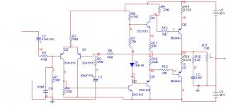

Here's an old Quasi design (lifted from an old thread of mine and drawn from memory).
This uses NPN devices as the outputs... but it's exactly the same for PNP... all the devices would be swapped, NPN for PNP etc and the supplies reversed.

QUOTE Thanks for your reply MJF so your saying that these are PNP's in the output stage?
the a1015's are the LTP but I don't know what the NPN 1815's do.
..........yes,2sa940 is pnp,150v,1.5a......................
.........yes,the c1815 should be the vas and/or driverstage transistors.......
