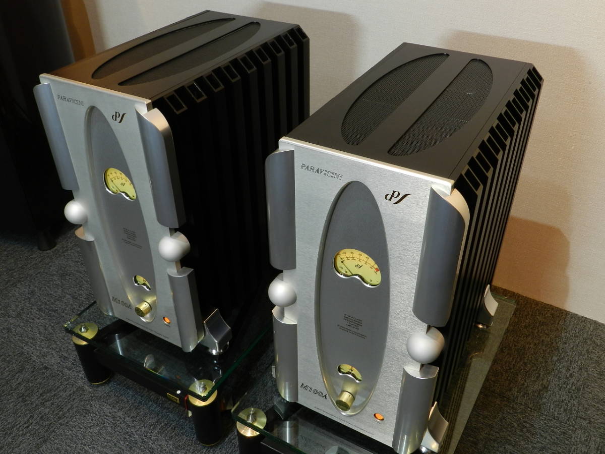

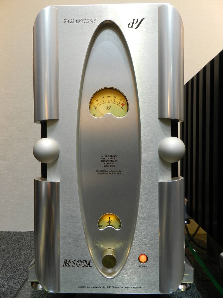

A commercial Product of a single ended version with transformer was design from Mr. Tim de Paravicini (EAR M100A)
https://www.diyaudio.com/community/threads/o-h-schade-1938-meets-mosfet.144105/ (post #20)
https://www.stereophile.com/content/earyoshino-m100a-monoblock-power-amplifier-measurements
https://hometheaterreview.com/ear-paravicini-m100a312-tube-amp-reviewed/
https://www.hifinews.com/content/paravicini-312-preamp-and-m100a-monoblocks
https://web.archive.org/web/2009012...ravicini_m100a312_tube_amp_reviewed002186.php
https://web.archive.org/web/20050302224226/http://www.envogue-24.de/Neue Seiten/ear/M100A.html

from EAR's M100A are still no information in detail to find except this review:
https://www.stereophile.com/solidpoweramps/earyoshino_m100a_monoblock_power_amplifier/index.html
and this description:
https://web.archive.org/web/20080222081440/http://www.envogue-24.de/Neue Seiten/ear/M100A.html
go also to post #8 under
Are there simplified schematics and internal images anywhere ?

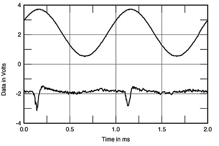

P.S.: the distortion character from the diagram (last attachment - from fig. 8, review in "Stereophile") could indicate a fault in a component.
