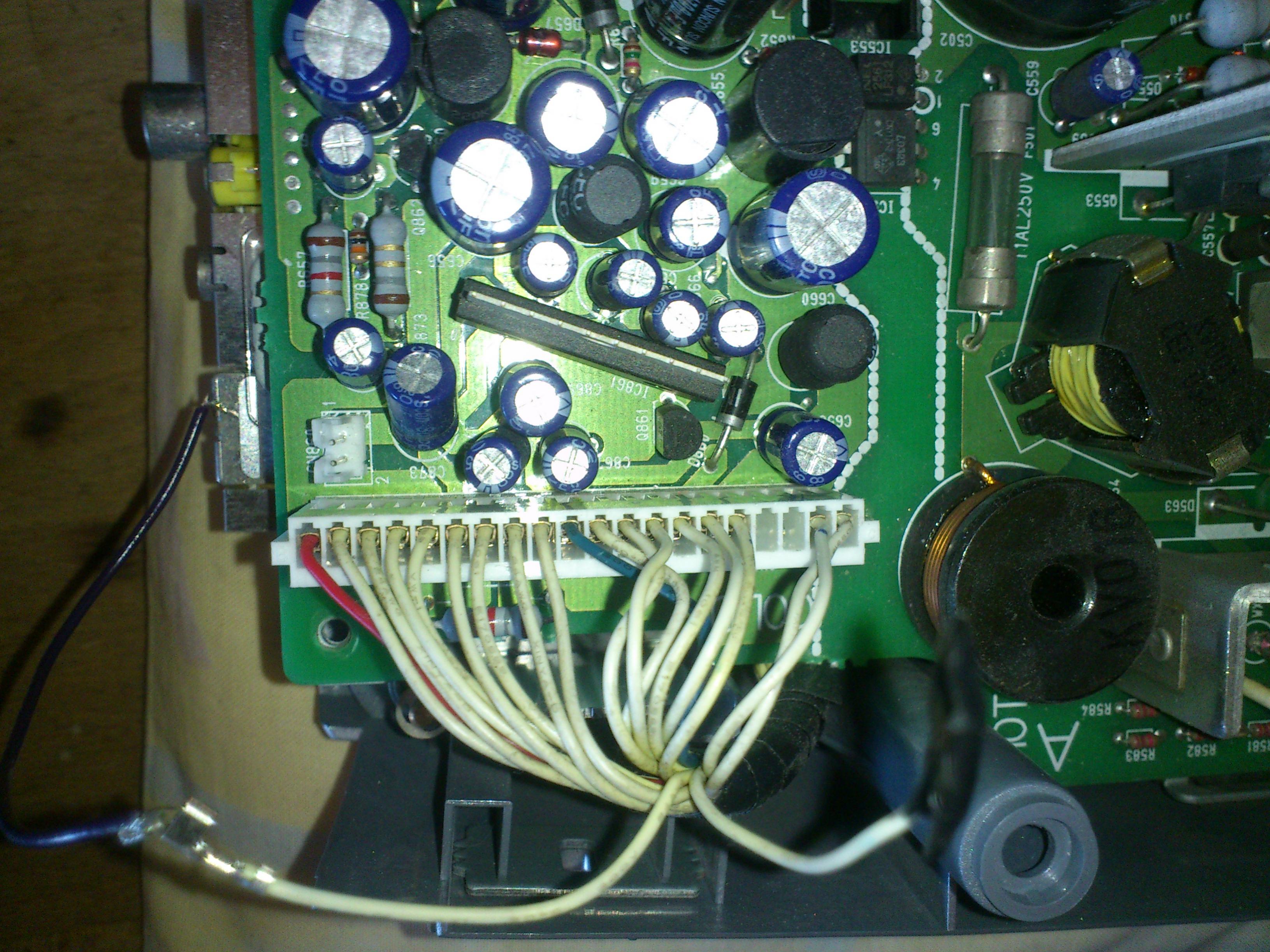

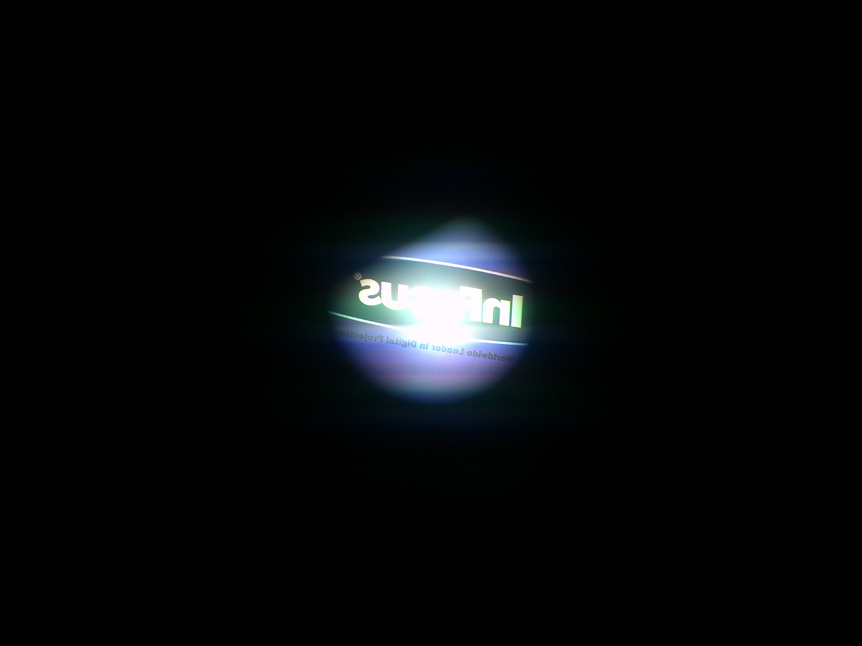

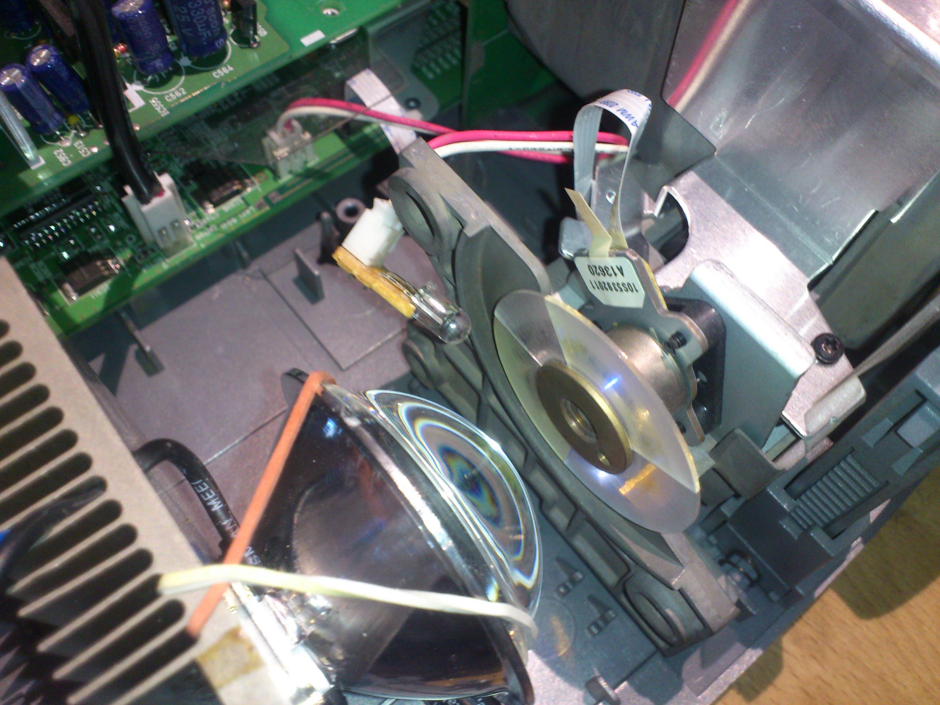

I have a Infocus X3, it is exactly same like X1 or X2. Thanks to Crazifunguy, I have moded the ballast successfully and very easily, no need to add or subtract any electronic thing. Using 55W xenon car lamp, I am able to watch a good quility picture in dark room. But the light is not enough for lit room, it should be totaly dark.
Sending some better quality pictures of ballast mod, for people who could not understand in previous posts (page 2).

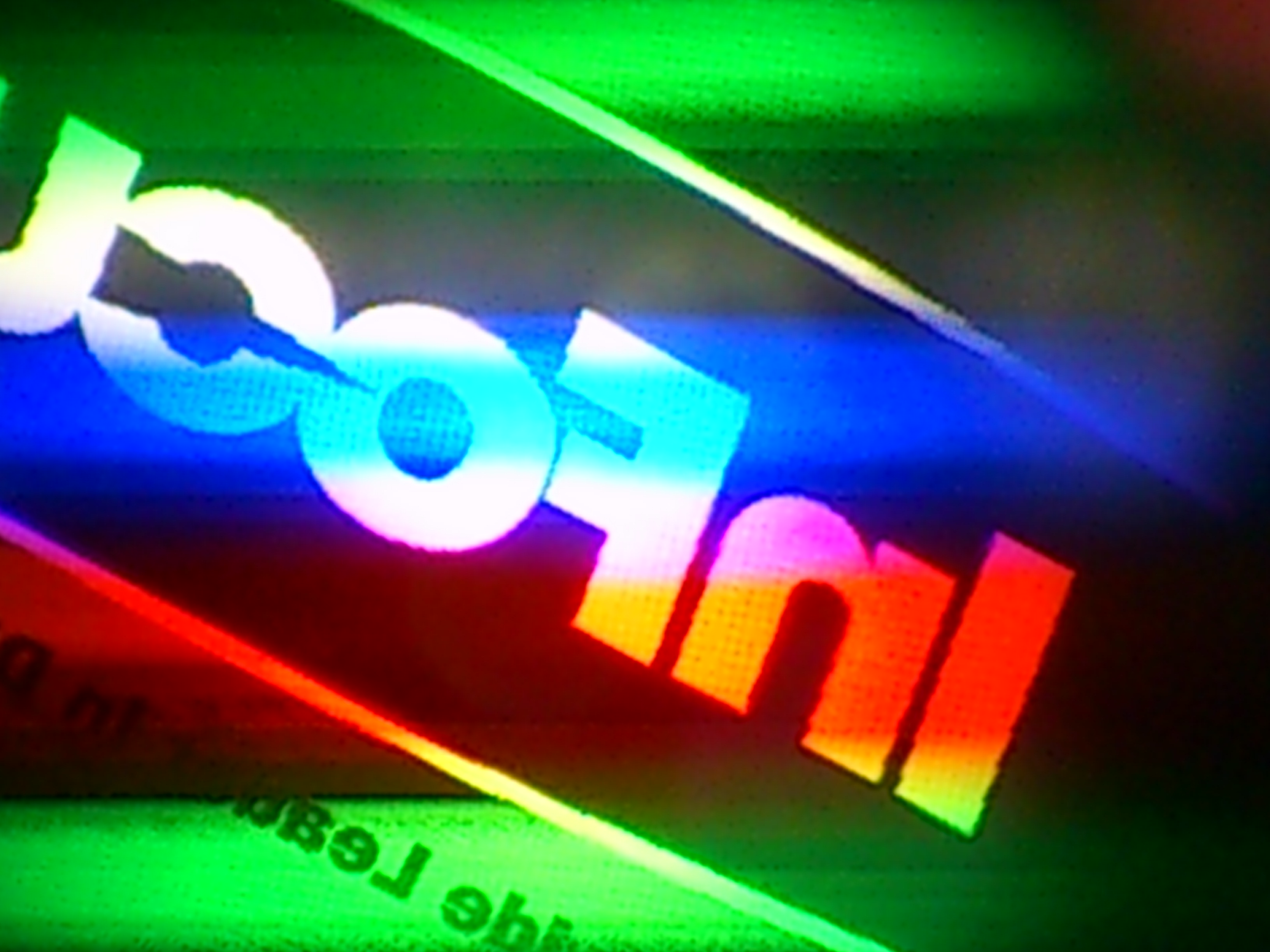

Hello. I need help.I managed to bypass the ballast. Fan and color wheel spins. The LED flashes green and then stays lit.All input is tried. The optics for this attraction: Look at the picture. 🙁
Black and white dots. What could be wrong?
Can you help?
Thank you.
(I use google translator, sorry.)

Greetings.
Still does not work. Maybe the DLP chip is not working.
What can be done. Anyone encountered this error?
What I did:
-lamp-lit to GND
-lamp enable to pull out
I am a very upset ...🙁🙁🙁
Thank you.

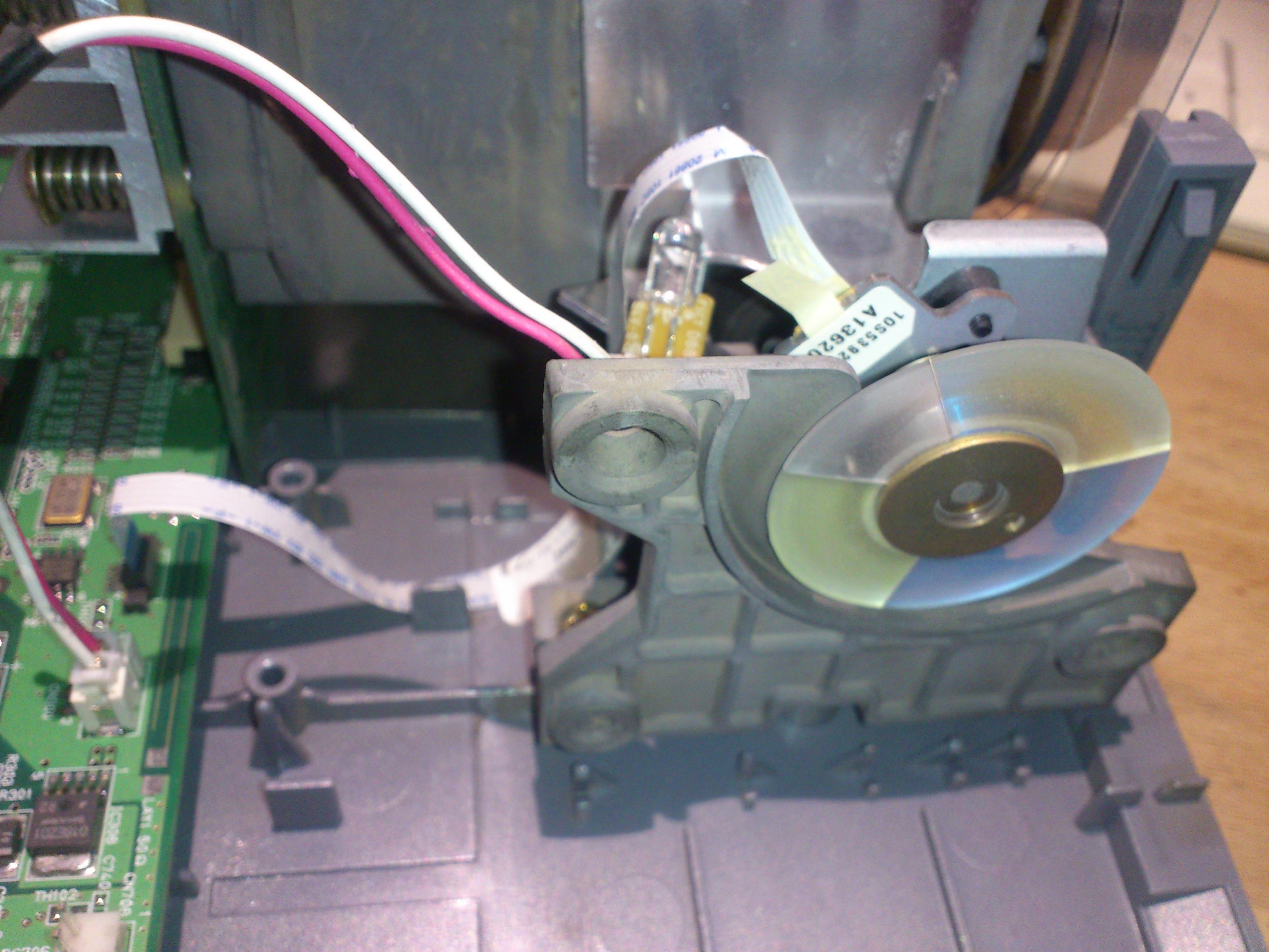

I think the problem is solved.
The light tunnel watching a optodioda.
If there is not enough light, not to image.
The question that can be disabled somehow?
Thank you.
I have a question about the above quoted post and images.
I have an Infocus X1 and it has a 20 pin plug on it. Does that change what pins I should ground and separate at all to bypass the ballast? Is it still the 1st and 3rd pins going from right to left?
thanks!
Well after some following of the circuits and some testing with my meter I found that that pinout was way off. I must have a newer revision. It ended up being pin 14 through a 10ohm resistor to ground lets the projector turn on and stay on. Now I need to pick a lamp source to play with. LET THE FUN BEGIN!!!!
