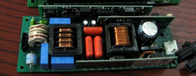

I have this one
Thanks for the image........are you offering the item as a part for sale?
I need to rectify the optics issues before I can be confident the projector can be resurrected.
I am hoping the second LP640 (still to arrive yet) will provide a bumper crop of salvageable parts (of course, the projector needs to have failed for reasons other than this one !!)
