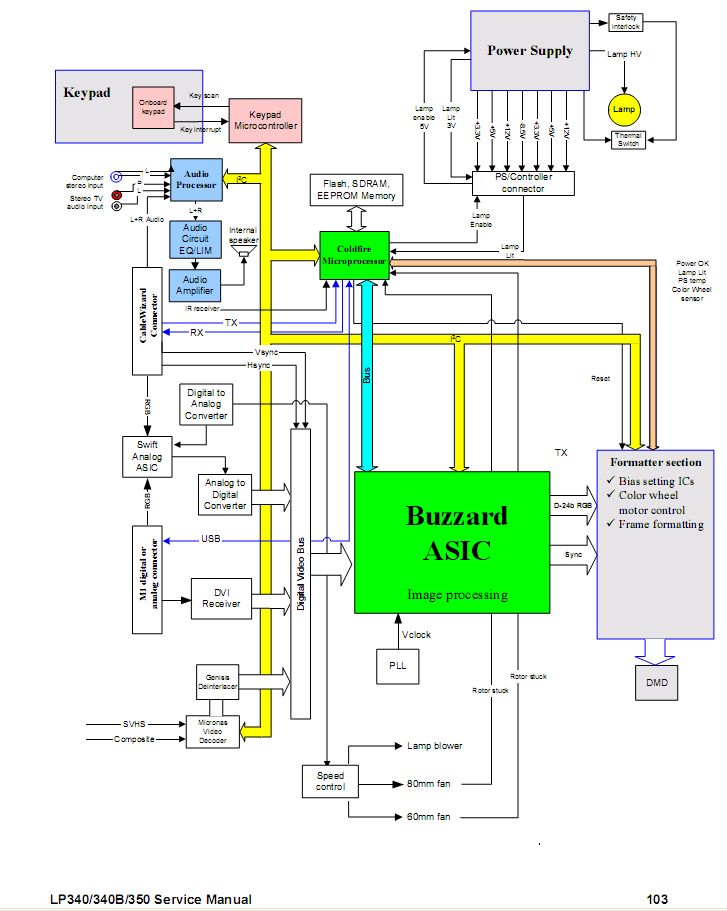

I have a Infocus LP350 and there are many threads related to it but I found the pinouts which is very different from X1/X2. It was soldered on Both Boards, thru and thru.
I need help figure out which of this pinouts should I short for me to relamp with a 2300lm led?
Should I connect pin 8 (lamp lit) to pin 9 (Grd) and remove/unsoldered pin 2 (lamp enable)?
