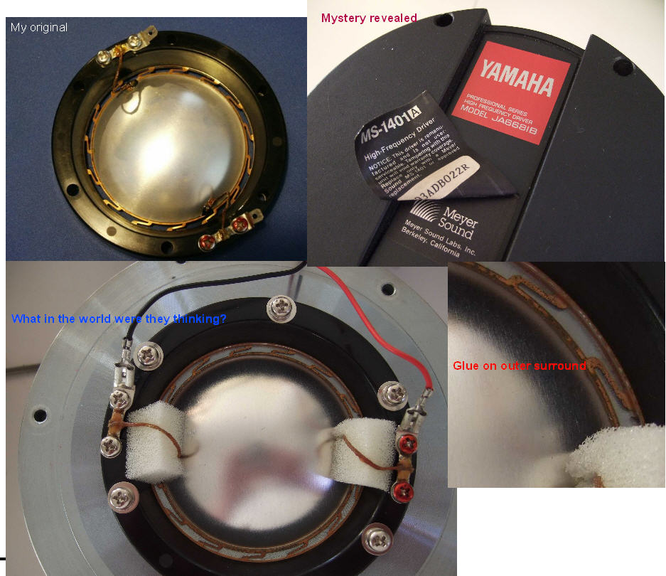

Meyer was using the original diaphragms but they limited the excursion by
applying epoxy or the likes to the surround fingers. This had a bit of a negative effect on the sound.
Look at the pic:

Radian, I've been inside a reasonably large number of these drivers. What I have seen is the foam blocks, foam all the way around (iirc), damping stuff painted on part or all of the diaphragm, but never anything at all on the the fingers.
I'm not sure of the point of the foam blocks...
As far as wood on the rear, too resonant for me. I would prefer something very very dead and solid.

Strange that you never came across one that had the glue on the surround.
The pic clearly shows some sort of epoxy material on the outer part of the
surrounds. Maybe Meyer tried different methods to make the driver more
PA reliable.
There have been lots of JA6681 drivers selling in the past that where
damaged. Although a very smart design, the beryllium copper fingers do not
only have advantages. The brittleness of that material mix was the cause
of many failures in low coupled hard driven PA applications. There was one
guy over at Audio Asylum who said he had six damaged JA6681 laying around
and did not find any diaphragms for them anymore.
The risky thing when purchasing JA 6681 drivers is that the seller can say
the drivers measure ~16 Ohm but they are physically useless because the
surrounds are damaged. This happened to me.
One of my drivers had seven fingers broken but it was electrically okay.
The foam blocks in the Meyer 1401A do certainly limit the excursion
and therefore protect the diaphragms from physical damage.
The foam blocks also raise FS and Q of the driver. Could be that Meyer
was using this approach to causes a stronger output in the lower region where the conical round horns that Meyer used are weaker than most
conventional horns.
