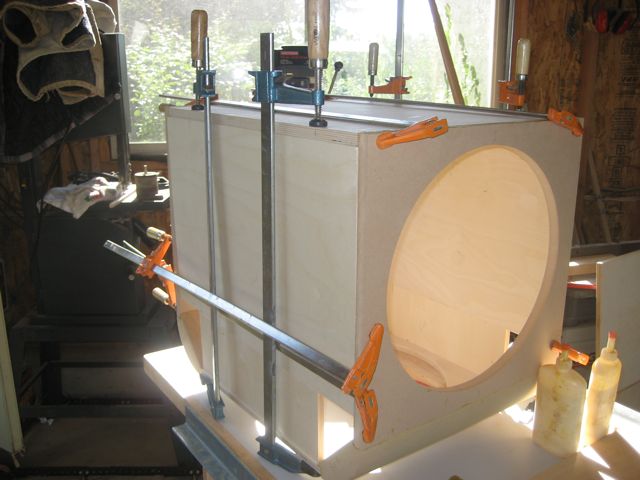

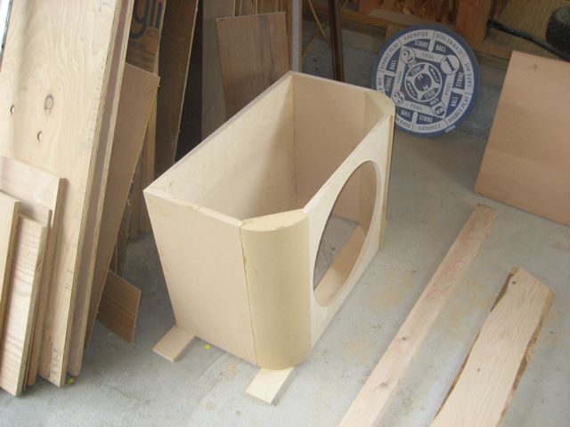

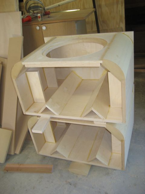

I am also indebted to past forum member Gary Dahl, who designed the Altec midwoofers cabinets for his Beyond the Ariel speakers. But Gary seems to have found lasting happiness when switching from the Radian 745NeoBe to the 6681B since early 2018. And given his long professional experience in music I felt very confident in doing likewise. https://www.bremertonwestsoundsymphony.org/gary-dahl-bio
https://www.diyaudio.com/community/threads/beyond-the-ariel.100392/page-724#post-5138781
https://www.diyaudio.com/community/...impedance-question.318749/page-2#post-5352494
Gary supplied all construction info for Jim Salk to clone the midwoofers boxes for me.
https://www.salksound.com/home.php# SEE attached sketches and a few of over 20 photos.
