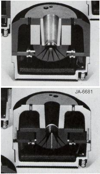

Hello,
I own myself 2 pairs of that driver.
But you should know that this driver IS NOT a 1 inch driver but is
1.375" in throat diameter ( diameter = 34.925mm).
So using it with an horn having a 1inch throat is questionable. (Also better to use another horn than the original Yamaha horn)

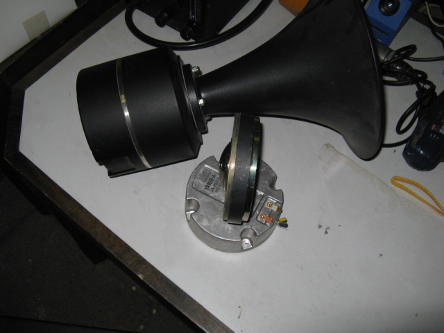

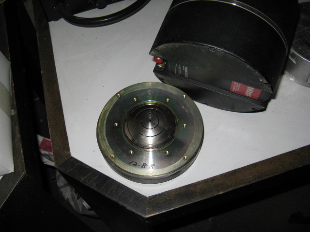

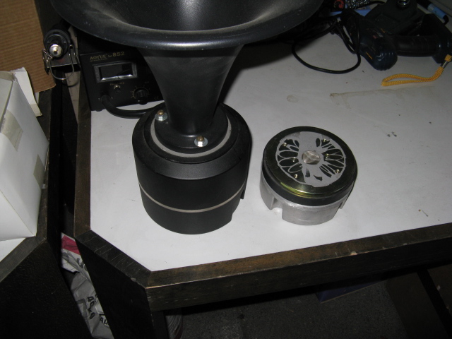

Hello,
1.375" in throat diameter ( diameter = 34.925mm).Hi Jean Michel,
You probably never took yours apart.
I could take it apart and show you but I am to lazy.
Instead I have taken some pics to show you.
If you take both black parts off you will have exactly
what you see on my 6603. A 1" throat driver but without
the screw holes.
Greets,
Klaus
Hard to believe but that's how cheap it looks if you take both ends off.
It probably did not cost more than any other 1” driver to manufacture.
