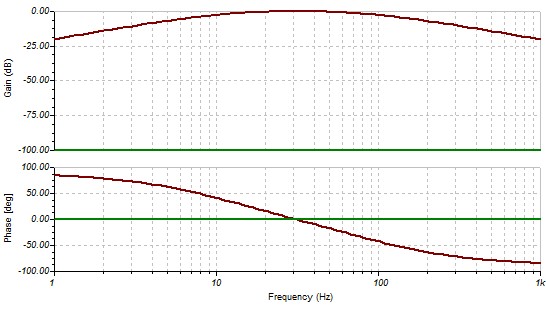

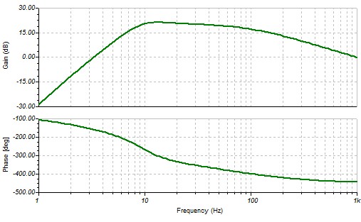

This is speed response of a speaker (Satori MR16) by a 0 impedance generator.

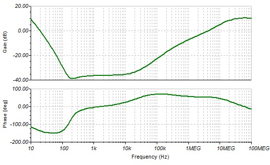

This is the output impedance of APEX AX6.
attachment.php
attachment.php

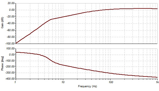

You can notice that at low frequencies the impedance is negative, I wondered How it can influence upon the speaker. Here is it, notice the phase shift.
attachment.php

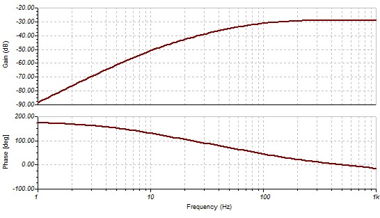

pressure response with generator
attachment.php
pressure response with apex ax6

I am not sure the output impedance is actually negative.
To ascertain that, you need to plot Vout/Iout with the input shorted and an external stimulus, for example using a current source instead of the load.
Less direct methods are certainly possible, but some thinking and maths are necessary.
Negative impedance or not, the two poles caused by the output and FB caps certainly cause some peaking in the LF region, straightening the frequency response

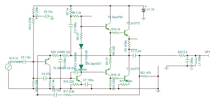

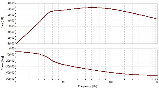

Even with a 2.2uf capacitor non feedback on the output, as JLH for example, we calculate low frequency cut with the load resistance 8 ohm. But, the LCR character brings the 2.2uf in series resonance, instead of decreasing, it increases the low frequency.
attachment.php
compare to generator driven.

In your sims I see and power amp, and I see some speaker sims. Could you be a bit more specific as to how these amp+speaker plots are generated? Some of the sims are clear, others not. E.G. how have you simmed the speed response? Have you integrated the acceleration of the speaker in question? And how have you simmed the JLH+Cap+Lsp?
Hello Kokoraintz,
A speaker is an electro-mechanical device which has a mechanical resonator (Fr, Q) activated by an electromagnet. The speed of the voice coil is proportional to the voltage, which results a pass band. The sound pressure of direct radiator, is the derivative of the speed limited in frequency by diameter above which it starts radiating . In sim you need to add a high pass RC to have the pressure response of a rigid piston and you get second order high pass with the same Fr, Q.
I did not simulated JLH, but I used the DUAL30cv that I diverted the ac feedback taking before instead of after the Cap.
