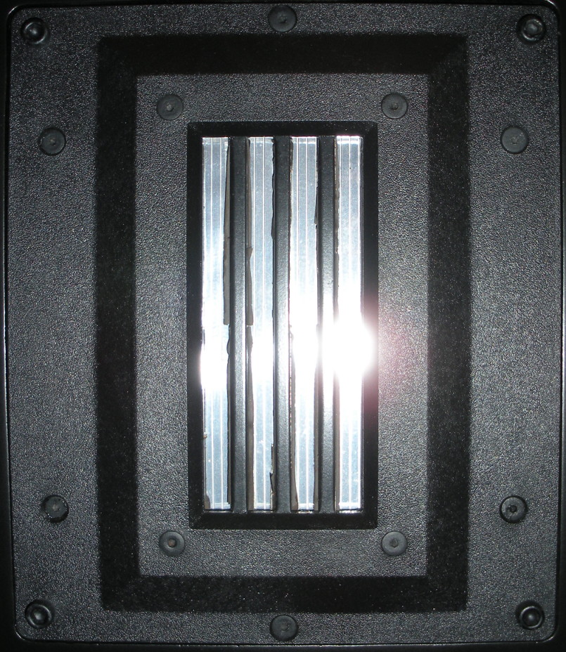

Based on all the input received I think it is best to start with the tweeters. I have opened an EMIT and found fluffy material between the magnets and diaphragm which I take to be corrosion as suggested by Greebster. I therefore propose strip and clean the 4 EMITS and 2 EMIMS. This will entail making jigs to manage the disassembly process and buying a heavier duty soldering iron capable of soldering the thick wiring so it will take a few days to get to the job.
Based on the amount of oxidised material in the tweeter disassembled I think that it quite likely that have found the cause of my problems. I will report back on the outcome shortly but in the meantime thanks for the helpful suggestions.

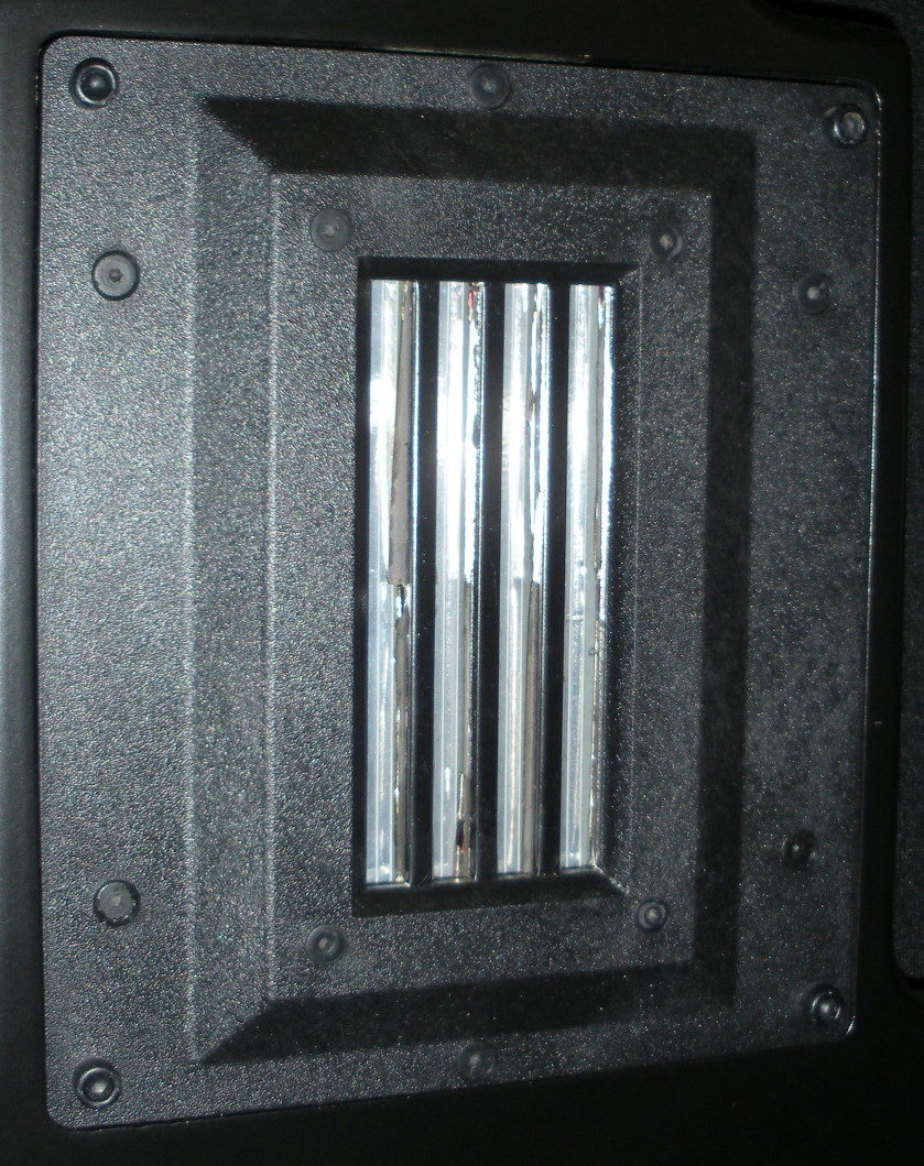

Checked mine and didn't notice any fluffy material on the drivers, but did notice this on my midrange units. There is no corrosion yet, but the plating is flaking off of the magnet strips, one more so than the other. Having that plating flapping / vibrating will degrade the drivers output.
Post some pics if you get a chance.
