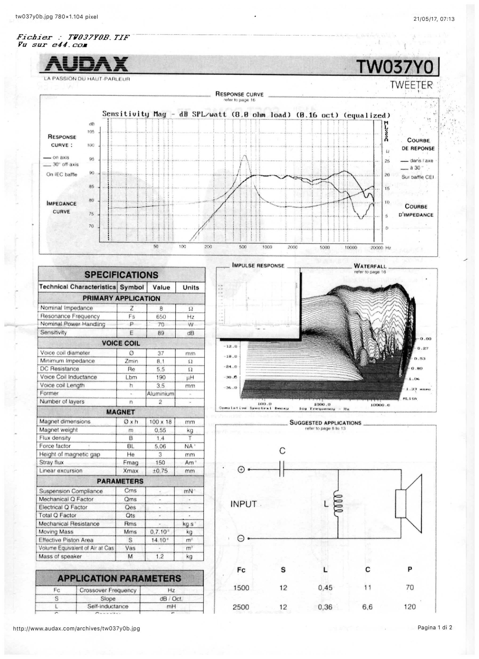

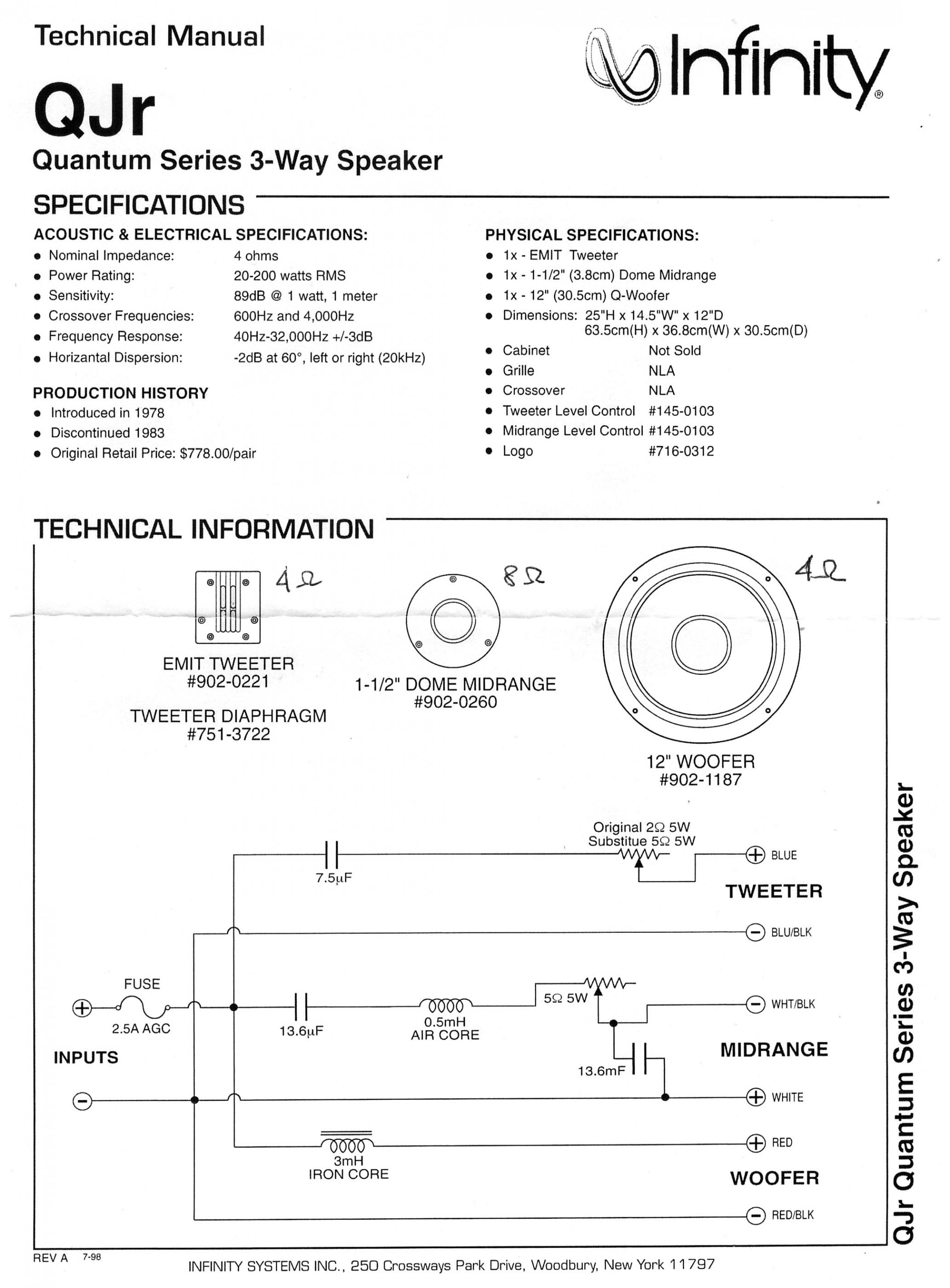

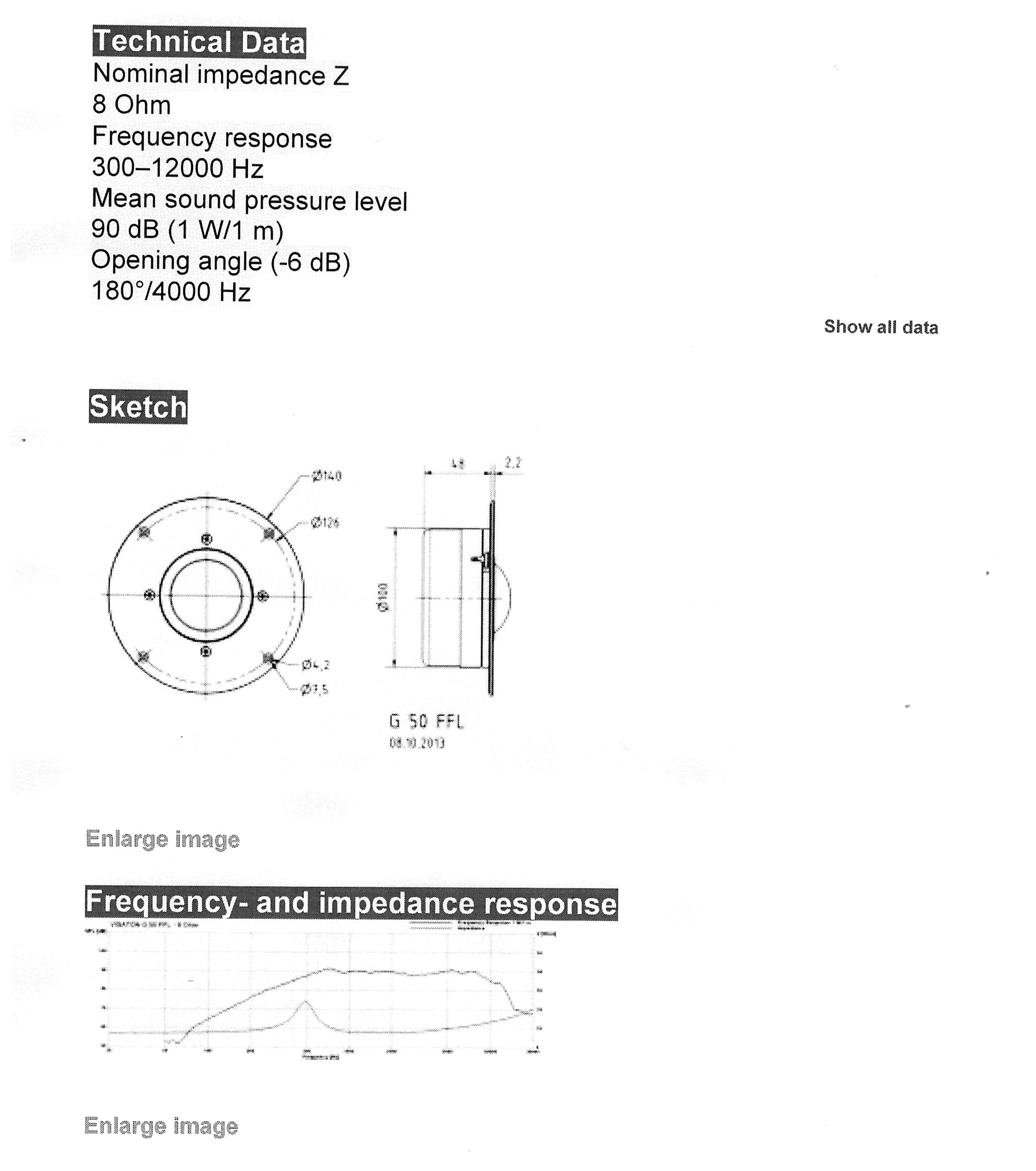

some suggestion on this matter. The QJr midrange (Audax) needs to be replaced.Audax stopped production so I have chosen a Visaton G50FFL that to me seems rather similar. Am I correct or do I modify the crossover?
Enclosed: speakers specs and QJr crossover.
