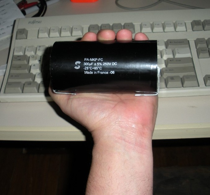

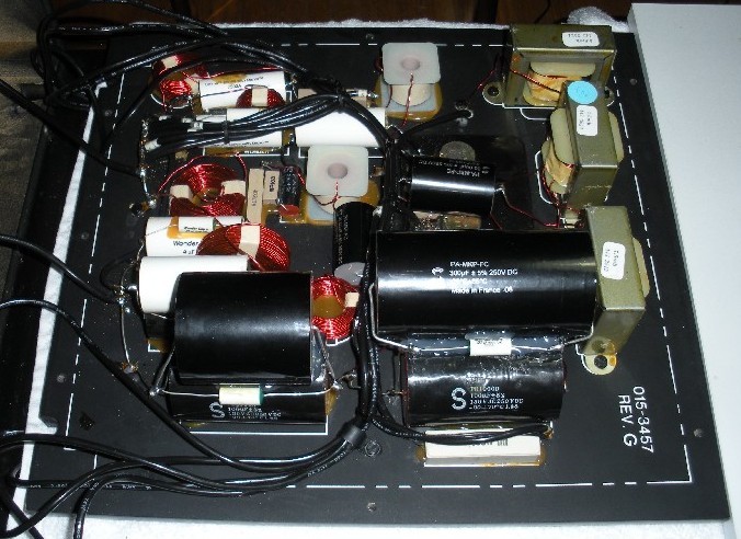

In regards to swapping out the NP electrolytics:
I checked the solen.ca site and the Yellow Bennics (metalized polyester) are almost unbelievably inexpensive, but it would be hard to match up to the exact values I need with what they have in those.
Another option that they do have though which I like is the Metalized Polypropylene Capacitors. I believe I read that the polypropylene is a superior cap, plus these have a higher voltage (250V), and there is an exact match for 3 of the 4 caps I require.
The one value that do I need and that they do not have is 35 mfd, but I could make up that value with a 33mfd and 2 mfd in parallel. They do have a 36 mfd capacitor, but that may not be the best option. Please correct me if I am wrong.
All of the Solen Polypropylenes I need for both sides would only add up to about $260 Cdn or so, a small price to pay for a decent cap/upgrade in my opinion.
I will see if I can track down some new NP electrolytics of the same value so that I can do an A-B comparison. They are not very expensive and I would like to hear what the difference would be.
I am also going to use the Solen caps to replace factory caps where I can and use for bypass caps in one of the Hafler amps I am modifying.

Hi msb64,
do not worry about 35mF or 34 or 36..........it is ok the same 😀
MKP normally is slightly better than MKT but not Because 250V versus 160V (and it is audible on the tweeter, not sure how you can expect
in a midbass............)
You can't have these high voltages on your speaker ! 😉
A-B comparision is the better thing you can make, imo experimentate
in first person is the way to go for learn.

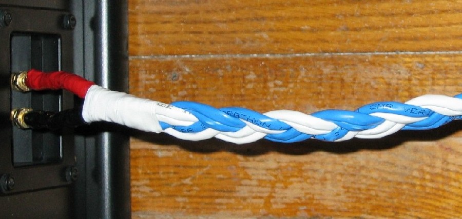

Here is a good braiding how-to that I found to help me make them. http://seriss.com/opcs/install/braid.html I am going to track down some 23 gauge cat6 wire, and give them a try too. Here is a photo of the braided wire, with you use different colors, they have a snake skin look to them.
I will stick with the Solen caps to replace the n.p. electrolytics on the Betas as you recommended, but will make a different choice on the Hafler components. I have already ordered a bunch of Vishay MKP1837 .01 mfd caps, and will also be trying Sonicap Gen I .47 mfd and 5 mfd to run as bypass caps. All are very reasonable in price, and certainly worth trying, at least for me.

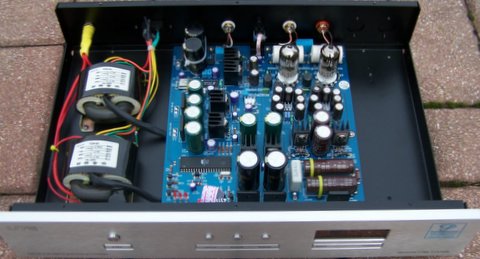

I ordered a Lite Audio DAC 60 Modified by Pacific Valve from the Pacific Valve & Electric Company, along with a pair of Jan Phillips 6922 tubes to try out. In this unit they upgrade some of the internal components, as well as make some circuit changes. It would be interesting to compare it to a stock DAC 60 unit to see what the circuit changes are. I will check to see if anything else can be easily tweaked, it looks like it should be very easy to mod.

I think Pacific Valve have made some modifications in the PSU and upgraded some caps, etc. Not sure if they have also modified the point of work of the ECC88 SRPP. 😕
IMHO, if the DAC has a standard 2V output levels, you can connect direct to the power amp by a 20K pot. ( threshold has 75K input and it is enough sensible).

I received my modified DAC last friday, and it is a nice looking piece.
It is also a decent sounding unit, even with the stock Sovtek tubes.
I never got to try the Philips tubes because I only received one of them, the other box had another Sovtek tube in it. They are sending me out a replacement for it.
The bass is very nice, solid, quick and low reaching. The mids are much warmer and more forward, but the highs are a little subdued, at least for my liking. I installed a couple of Vishay MKP .01ufd bypass caps on the Jantzen 4.7ufd caps and it helped quite a bit. I will probably install something better to replace the Jantzens though.
It is hard to judge exactly what has been modded in this unit, because I don't have a stock unit to compare it to. My best guess is mainly component substitutions as there doesn't appear to be any wiring or board changes. Besides the Jantzen caps, there are other polypropylenes and many of the electrolytics (if not all) are Elna caps. Plenty of space inside the unit too, makes mods much easier.
It would be nice to get a hold of a stock unit, and upgrade the various components with my own choices. A schematic would have been handy to help pinpoint key signal path components, and probably would have helped for design mod considerations as well.
I took a bunch of images of both sides of the board, if you would like to see them, I can send them to you. They are high enough quality that you can zoom in on them.

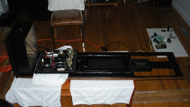

I took apart my Pooge modified Hafler amp, to start the whole monoblock conversion process.
I definitely need to spend a few $ on some large PS caps now, and maybe even some larger toroidal transformers later on.

I finally got around to ordering caps for the crossovers.
Ended up ordering Solen MKP PA series caps to replace all the oem NP electrolytics.
As you can see in the pictures, the biggest ones were huge, about the size of a tomato juice can.
The replaced caps were 300 mfd, 150 mfd, 36 mfd and 20 mfd.
Fortunately the mid/high tower bases had enough room to install the upgrade caps.
The change was immediately noticable and surprisingly significant.
The already "open" and "revealing" betas became even more open, it was like a blanket had been covering the speakers and was suddenly removed.
According to some sources, the sound/peformance should improve with time, it will be interesting to see if this actually pans out.
If it does improve, that would be a definite plus, but it is already a good return on invested time and funds as it is.
I can definitely recommend this mod, a substantial improvement for only about $318 Cdn (includes shipping cost) worth of parts.

I am also using a Lite 60 DAC modified unit from Pacific Valve, that I have also made some bypass cap changes to myself according to recommendations made by Tony Gee on his humblehomemadehifi.com website, well worth checking out.
I can also confirm that the Vishay Mkp1837 .01 mfd Mkp caps are real performers, after having tried them on various tube and solid state preamps as well as several solid state amps.
I ended ordering 60 of them from Allied Electronics (MKP1837-310-011) for only $1.47 US each plus shipping
