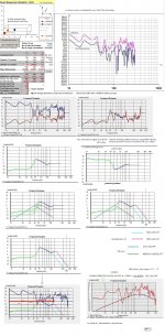

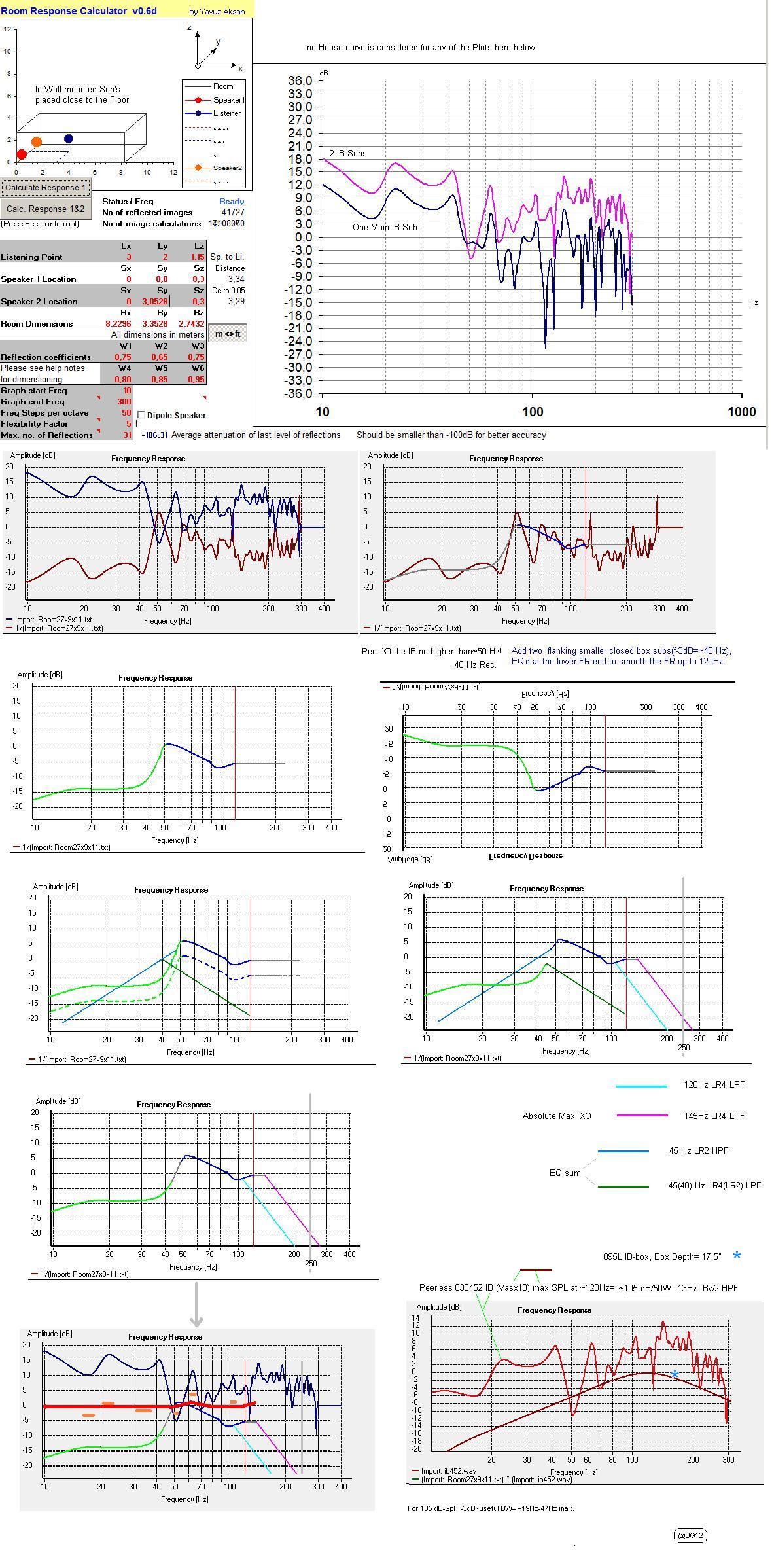

.. go down to 120hz and cross over there. This is for music not HT.. or if there are any issues I need to be aware of? ..
The Settings of the correct lower FR end Loudness is IMO crucial when listening to Music.
