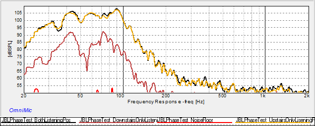

Admittedly, I have no idea about any of this, except one subtle observation about my own OB setup, which seems to provide "bass where you want it" i.e. the listening position and nowhere else.
When I was running an ordinary commercial sub, the bass seemed to propagate through the house in the typical "nothing can stop it" manner that bass does. Similar to the experience when a bass laden-automobile drives through the neighborhood; the notes seem to couple so strongly into the air around the car and then pass through structures like house walls with ease. (One just drove past, along an ajacent street as I write this...ba boom, ba boom)
I've discussed this with an engineer (far more reputable than I) without reaching a precise technical conclusion as to why this happens. He did remark listening to his system at a comfortable SPL - using 4, 18" in OB H frames - while his wife watched TV in the room below undisturbed. We agreed that this "polite" characteristic of OB speakers is beneficial for those living in closer quarters to others, at the expense of the steeped in it, in-your-face-gut-punch sealed and ported designs provide.

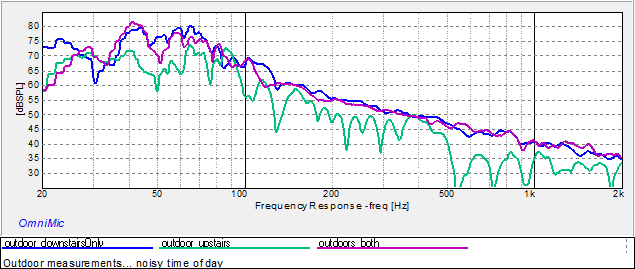

Your assumption is correct regarding the dipolar nulling of an IB sub outside and perpendicular to the space.
I've got a quad 18" Fi IB318 attic mounted IB serving our primary media room. The effect outside where you're exposed to both "box" surfaces does exhibit some nulling and certainly is beneficial toward keeping the peace during high dB exploits.
Biggest issue I experienced outside was addressing small rattles here and there. Un-correlated bottom octaves aren't much an issue. But when spectral energy higher up is added then it's more noticeable.

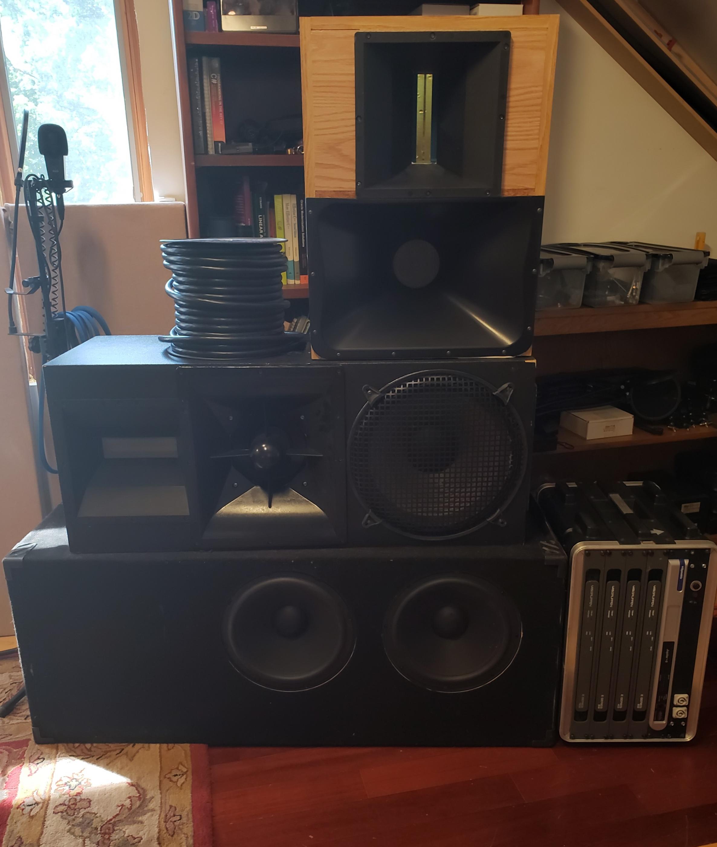

Re: my mains, etc... now I'll derail my own thread.
What's sitting in the end of the room right now is a crazy kludge three-way that I put together to test a new mid for an evolution of my current medium-room PA tops, and to start working my way through a FIR tuning workflow with rePhase, REW, and my Symetrix processors.
I wound up liking it so much that I haven't broken it down to build real cabinets yet... and with no gigs (sigh), I haven't had to. Really ugly looking (see attached), but lately there is hardly anyone here to notice.
The HF is a Stage Accompany SA8535, the mids are the JBL 8" CMCD in the 90x60 small-format PT horn, and the midbass is a JBL 2265HPL. The old mid (seen lying sideways in the photo, donating its midbass to the test) was a RCFMR8N301 in their H6000 horn. I like the CMCD much better. The MF/HF crossover is a semi-steep complimentary FIR implementation at 1800Hz. The MB/MF crossover is at 340, too low for the Jupiter's 512 tap FIR filters, but I do some phase flattening. I haven't lugged these outdoors for testing, but indoors, the MF/HF transition is pretty much lobe-less vertically, much better than anything I've ever achieved with the SA tweeter before.

Tonyman108,
I agree with you and FOH that the IB should result in less exterior propagation, but considering as you have plenty of gear (and unfortunately, time off), I'd suggest some actual tests to confirm the theory.

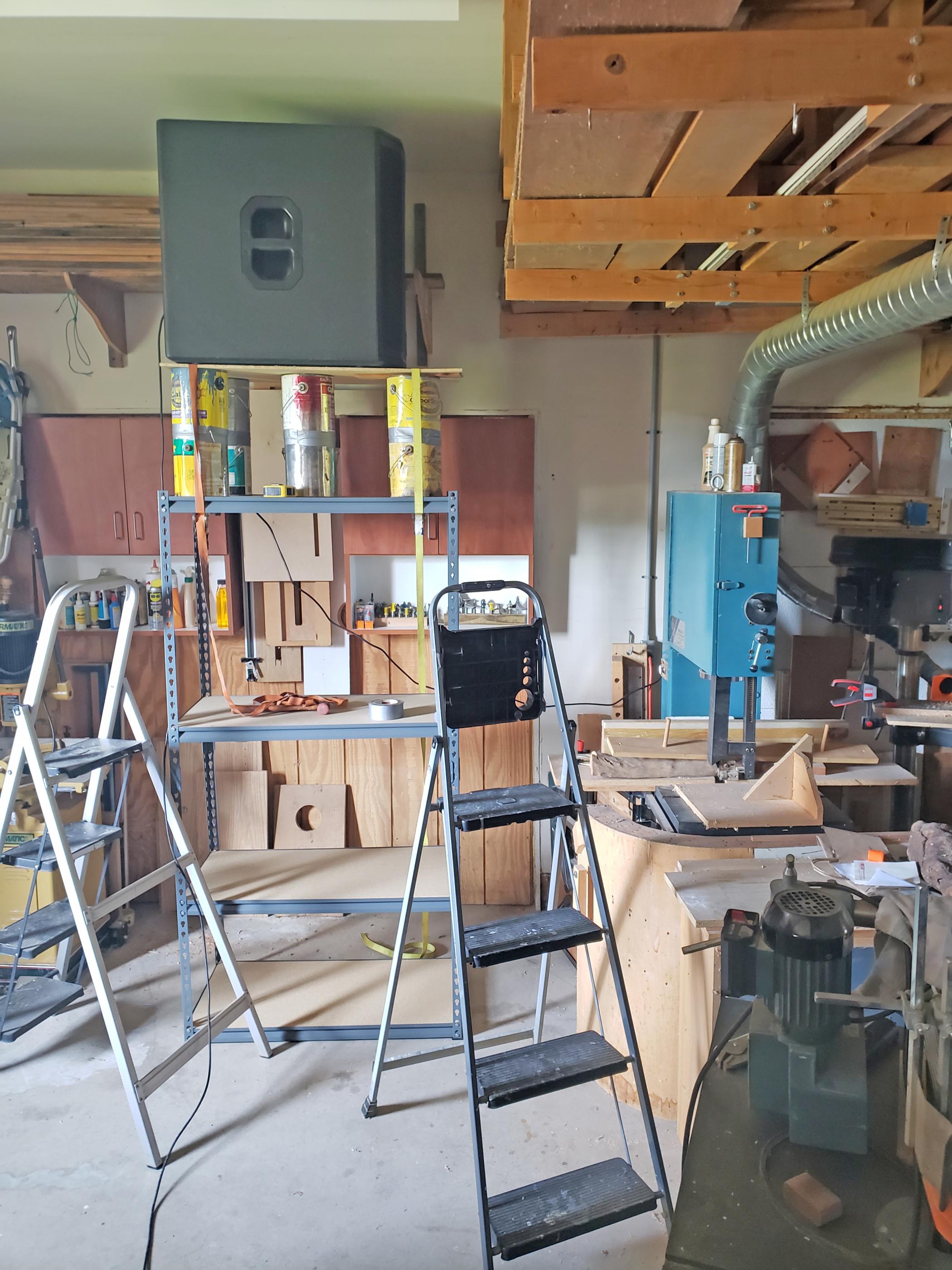

You could "simply" prop up a sub on a pair of ladders, (or a crank lift if you have one) in the position you plan for the IB, drive another upstairs in the same position in reverse polarity, and measure outdoors at various positions around the property line.
Also a good test to determine the best placement before cutting holes...
Pink noise is far more stealthy than swept tones for outdoor testing ;^).

Thank you, Art, that is a fabulous suggestion! I don't have an appropriate lift, but that doesn't kill the idea.
The NHT cabinets weigh 125 lbs. I could probably get that up on some ladders without dying, but it looks like I can rent a lift from my local Home Depot with a 12' rise and a 450 lb. capacity for $70 a day, or $49 if I can stage the test in 4 hours or less.
It might take a while to find the right time window, but that seems like a pretty good investment.

Tonyman, my mains are OB and delightful and I have more recently enhanced the low end (about 50Hz and lower) with a 6 inch driver in a tapped folded horn. The horn is coupled using approx 20mH air core "crossover". The value was determined empirically to suit my hearing. The result is almost as good as a live concert.

When I listen to music with the system as-is, I can see where my master fader is when I'm thinking "I really shouldn't be doing this to my ears", and also know how much I have to turn it down from that point when some bass-heavy program material comes along and I think (or smell) "I really shouldn't be doing this to my last 4 NHT 1259s".
Encouragingly, the spread between those two fader positions is about 6 db.
Yes, this is highly program dependent. +9dB worth of extra bass headroom may or may not be enough to handle a demo track with some crazy ULF content at arbitrary levels, but it will absolutely handle 99.5% of my music listening needs. If not, you have to admit it slots pretty firmly into the "first world problem" category!

As promised, I have done my best to run the experiment proposed by Art, where I stuck an out-of-phase sub up near the ceiling (directly below another copy of said sub in the listening room), and measure what happens, indoors and out.
I decided to do this with a pair of JBL618-XLF powered subs, as they are much easier to move than my NHTs, play much louder, and are less likely to be damaged by an errant button-push during the experiments.
Only downside is that they have much less LF bandwidth, being a vented design with an F3 of 38Hz. Still, kind of interesting results, and I'm glad I did it.
I've attached a photo of the precarious rig for the downstairs woofer (the one located where the back-wave of one of the IB sub manifolds will vent). The racking I had on hand was too short to get the sub all the way to the ceiling, hence the use of multiple, uh, "cylindrical height augmentation units". I couldn't locate sufficient chewing gum or baling wire, so I substituted gaffer's tape and ratchet straps.

I've attached a few snapshots from the OmniMic, with various sets of measurements taken indoors at the listening position, and some outdoors. The outdoors measurements are very contaminated by wind and other ambient noise... I'll try to get a cleaner set when the wind, traffic, and neighbors allow for it.
The JBLs, measured outdoors on the ground, are very flat in their passband. In-room response wasn't horrible, I didn't EQ out the lumps. Perhaps should have.
attachment.php
First, the indoor measurements. In the proposed IB setup, the floor of the listening room will be (anti-) excited by the IB's backwave. There are other possible transmission paths as well, as the first floor is above-grade with wood framed walls.
I have been wondering whether the leakage from the first floor up to the listening room would do anything measurable to the response. Short answer... yes. But it is fairly subtle, and isn't all negative.
Looking at the 'upstairs measurements' snapshot, the yellow trace is taken at the listening position with only the upstairs sub active. The red trace is with only the downstairs sub active, and the black trace is with both active.
By ear, the difference in tone when muting the 'downstairs' subwoofer is audible with pink-ish noise playing, but hardly dramatic, especially at the main listening position. While the response varies from place to place in the room, I haven't found any spot where activating the downstairs sub makes a hugely audioble difference.
I find the giant suckout at 55 hz on top of the ca. 20 db of attenuation of the 'downstairs' signal (the red trace) to be quite interesting. The shop ceiling has 5/8" sheetrock on RC, I'm wondering if 55Hz is the resonant frequency of that system. The ceiling of my listening room is similarly constructed, and i happen to have a lot of weirdnesses in my room at 50-60 hz. Might be an area for further study; I'd assumed it was all due to room dimensions, but perhaps my celling is acting like a giant 55Hz bass trap as well.
Anyway, the outdoor measurements were the motivation behind this experiment, and I have to say... my initial fears were well founded. The studio was built (at least after the fact) with sound isolation in mind. The shop was not. It shows.
attachment.php
The 'outdoors' measurement set was taken from a point about 15' away from the gable end wall of the building, with the mic about 10' in the air, approximately at the studio's floor height. This happens to be in the same direction, and the same height, as my neighbor's first floor living room windows.
The green trace was collected with only the upstairs sub active, roughly equivalent to my current system, minus the bottom octave. The measured SPL (not show) right at the inside surface of the wall was 125db, and was 105 db at the listening position, 13' away. Outside, it averaged 68db. Not too bad.
Unfortunately, as can be seen from the blue trace, the leakage from the downstairs sub taken alone, is 10db louder.
And... with both of them running, you can see (and just barely hear) that some cancellation is taking place over some of the frequencies of interest, but not huge. This makes sense as the two signals aren't the same amplitude.
As far as what this extra leakage means to a human inside a nearby building... yeah, you can absolutely hear the difference, and it is about as un-subtle as you'd expect 10db to be.

Have to say that finding the leakage from the downstairs sub being 10db louder than the upstairs was a surprise to me, had you tested that first, could have eliminated the reverse polarity Darwin Award lift portion of the test.
You have scientifically confirmed you are building the wrong choice regarding LF sound leakage to the neighbors :D .
Art
I was a somewhat surprised myself... I was guessing 6 dB. I built the building back when my wife and I still owned the property with another couple. There were substantial budget compromises made; as we were splitting the cost. We were mostly focused on the shop space's size and function (we had a paying tenant in hand).
