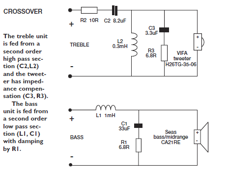

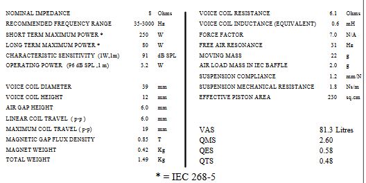

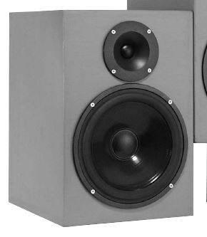

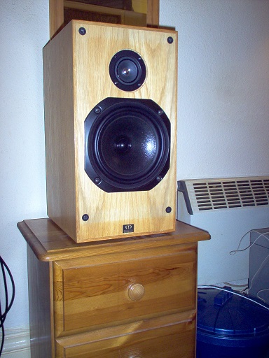

Some years ago I built these KLS14 World Audio speakers which were designed for small rooms; see attached pdf
Been pleased with their performance in my small home office room, just 8x9 ft, but as the cabinets need refurbishing , thought it might be time to look at upgrading, but have yet to find a modern infinite baffle design , at a reasonalble cost , that uses drive units that are still available , partic here in the UK / Europe.
Is there still such a design around , seems most diy designs and ready made units are all bass reflex which would probably give problems in such a small space ?

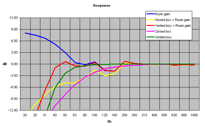

I don't know who told you that vented boxes have problems in small rooms, but any speaker could have problems in any room, if its implementation is inappropriate.
The main thing, since you like these but want new, is to keep the baffle step correction low as in what you have, so that when you put them in the same place, the bass doesn't kill you. The design you have has about 1/3 bsc(2db).
Just look for designs where the system output is 2db less than the woofer's own.
That said, XRK's low-crossed 2 way has its crossover near its baffle step, so it is very easy to adjust for a room and placement by adjusting the high range level, and the basic design makes it very easy to use a different woofer, it's simple to stay out of trouble when you cross that low.

Generally have read and been told by dealers that vented boxes are not ideal for small rooms, being told rear vents need to be placed well away from the rear wall and front ported ones can flood with too much bass and blocking the ports can result in a poor sound ....??
Thats why I thought the above KLS14 infinite baffle speaker was a good compromise, and it does seem to give a pleasant even sound though the drive units are a 20 year old design.

Because either they are ignorant, or the boxes were intended for freespace positioning. That does not mean that vented boxes are inappropriate for small rooms, just that you need one that is properly designed.
Not true. It depends on the alignment of the enclosure, the exact positioning, and (to a point, although in most cases secondary to the first to) the construction materials of the room.
Utter drivel (not by you, by whoever told you that)
It can. But so can doing a heck of a lot of other things. Alternatively, it can improve things. This is entirely circumstance dependent, and if anybody claims a blanket 'yes / no', you would be well advised to ignore them as they are not competent to be passing comment on matters of acoustic design or behaviour. Likewise, the actual box loading is only one aspect of whether it will be well suited to near-boundary positioning and / or use in a smaller space.

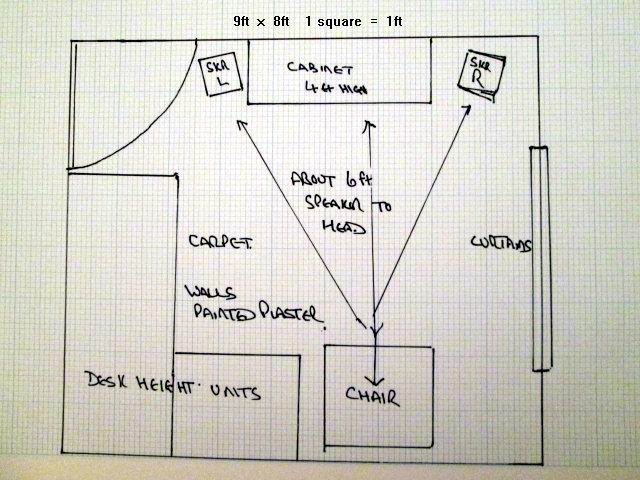

The question is, are you going to put your new speakers in the same position as the old, or are there options? Placement options give you more choices. Tell us about your room and possible placements, we can maybe give you more kinds of choices.

My current speakers are on sand filled metal stands as the diagram hopefully shows.
Cannot really see any other practical position and the tall cabinet top has the amp etc.

I'm sorry, I wasn't clear, when I said stand-mounted I meant away from other boundaries as well as the floor. That said, there is nothing illegal, immoral, or unethical about turning down the bass a little.
You may also find that it all works out, as one is near a corner, which will boost bass, and one is by a door, which will cut bass. Which is probably what's going on now.
If you have too much for you, stuff first the port of the corner one. Try three levels, rolled sock(total), rolled fiberfill(mid), and 'as it comes' fiberfill(least).
If you prefer the lighter plugs, lengthen the port. This will lower the tuning(and volume slightly) which will make the rolloff earlier and gentler(more like sealed). On the other hand, you may only have to get the edge of the boxes in front of the corners of that central piece to make enough difference.
Remember, the room is the gorilla, and we're only talking about a couple db bump, so don't hesitate on the Classix2s, while I have heard more originals than 2s, they both give you that byproduct-consuming grin.

How it works... why big speakers sound terrible in small rooms. Room gain. 😎

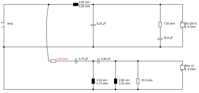

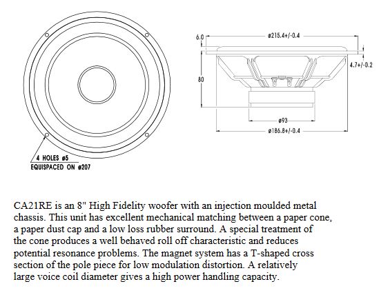

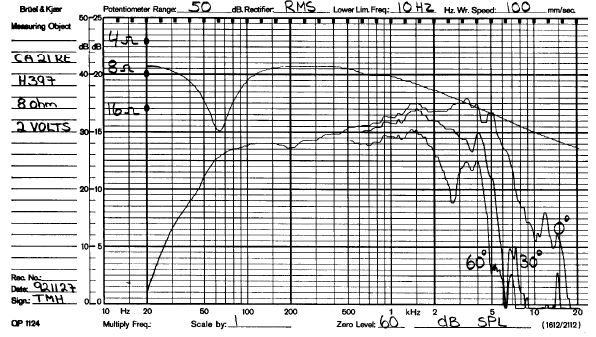

Upgrading these speakers. Well maybe a a 12dB/octave bass filter might sound better than the 6dB/octave current one.
I do stuff like this. Last image. Not a million miles away, eh?
We could do that. Anyway, my friend, upgrading is often just a question of swapping one set of problems for another. Here's something about your tweeter. Raven-TA (Dayton RS180s with Peerless H26TG45-06) - AmpsLab
