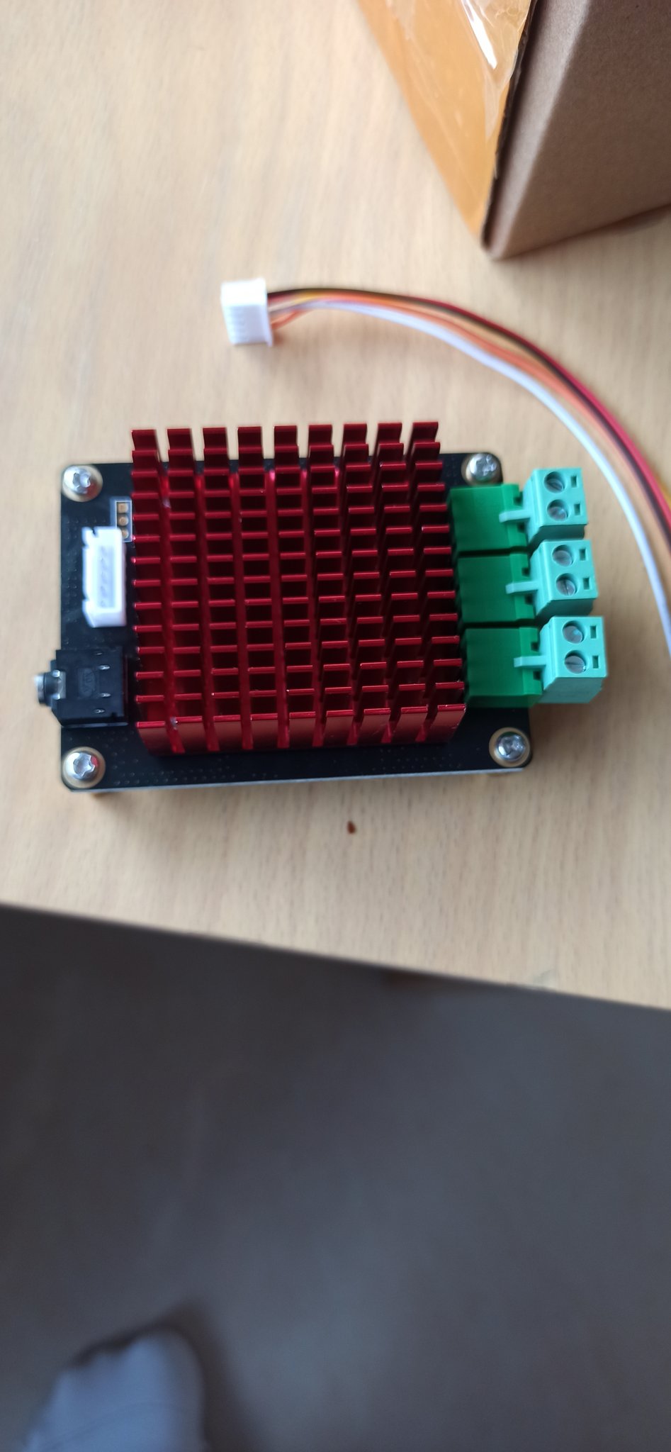

Hi all! After getting one of the Shenzhen Pillor PL-ADP-160 (V1.5) from AliExpress that were also discussed on this thread "a while ago", I naively hooked it up to an old Odroid C1+ that was lying around, while still waiting for a Raspberry Pi to arrive in the mail. Currently, for testing purposes, the amplifier is powered by a 20V Lenovo laptop brick.
The Odroid was a nice SBC, which, unfortunately didn'd get any support beyond Ubuntu 18.04 with kernel 3.10.107. My thinking was that I2S is I2S and perhaps I might get some sound out of the amplifier using the PCM5102 driver that ships with the Odroid's image. Unfortunately, just silence.
My wiring is:
BCLK - SCLK
LRCK - LRCK
GND - GND
DATA - DATA
MCLK - MCLK
(EN and MUTE are unconnected)
Assuming the wiring is correct, is there just no way without a kernel new enough to run https://github.com/Infineon/merus-audio-amp-hat-zw/ ? Or does perhaps something generic exist that could be used?

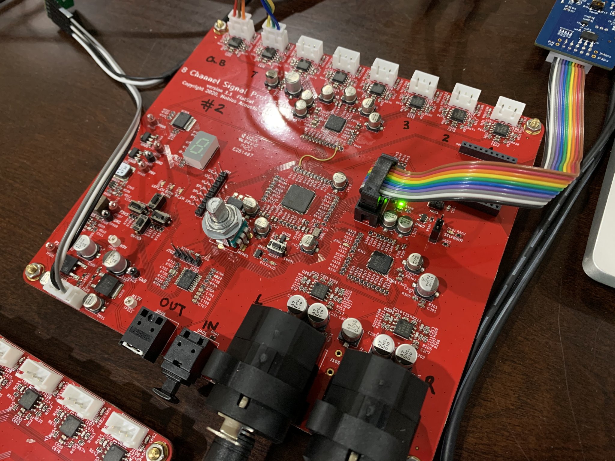

I bought the ADAU-1452 EVM board and used its USB to SPI dongle to connect and program in SigmaStudio.
Here was my DSP connected to the blue Linear Systems dongle:
Regarding Chinese ADAU boards, you might find your answer here: https://www.diyaudio.com/community/threads/low-cost-adau1452-china-board.309680/page-10
The EVM boards with Dongle were $250 vs $100 for plain Dongle. This was a company expense and very reasonable for an EVM board.
That’s my DSP board and Rev 1 so plain and simple error in failing to see that the AKM DAC needed its Mute pin actively controlled by the DSP. I chose a conveniently available spare digital output.
In rev 1 boards I would highly encourage diagnostic probe point pins for reading the logic state of all inputs/outputs data and clocks.

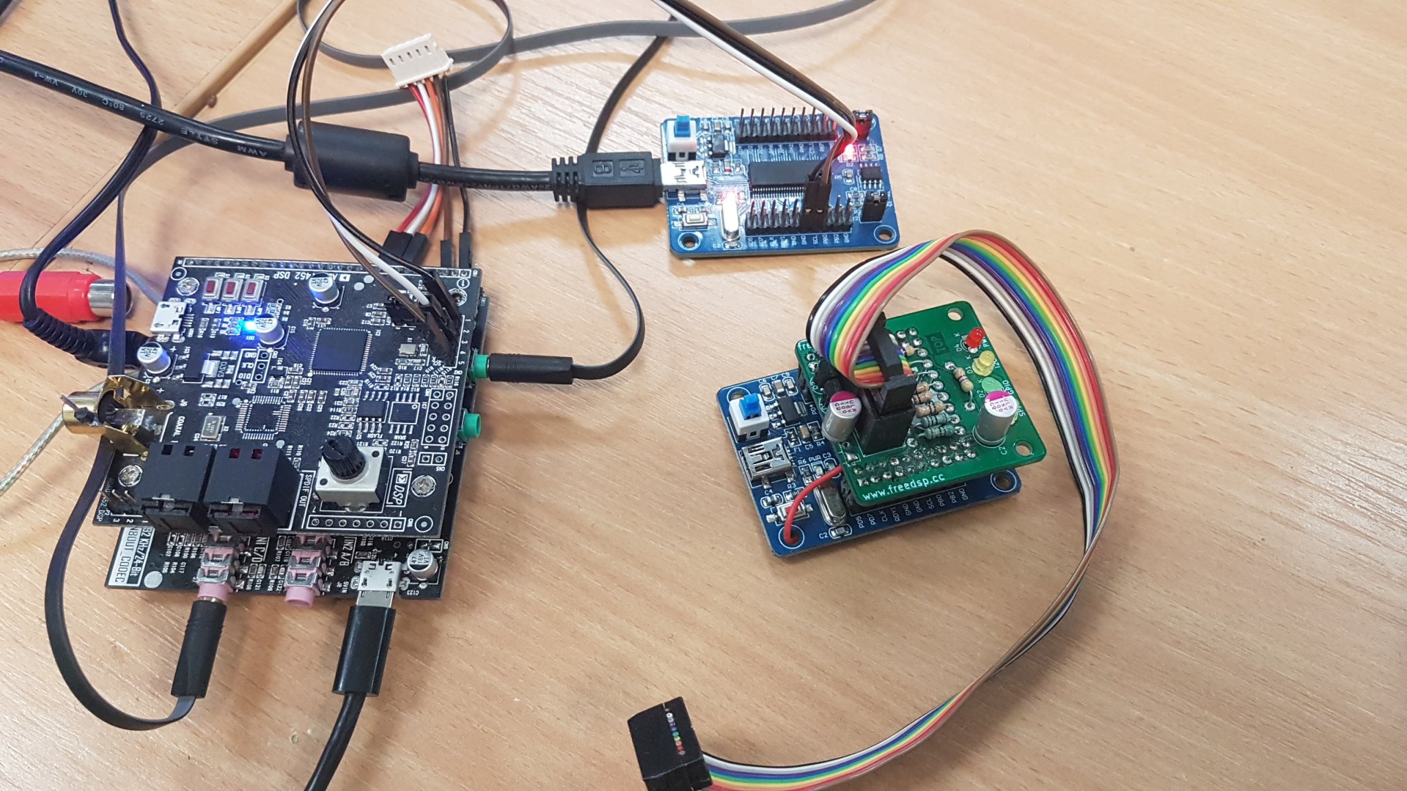

I successfully use two of them, one with freeUSBi board to program ADAU1445, second one bare in SPI mode to program ADAU1452 board. Little problem was with driver installing, but finally works perfect.have you ever succeeded in programming an ADAU using one of these cheap CY7C68013A boards with freeUSBi firmware?

Is there a thread that shows how to do this step by step with cheap Chinese made ADAU DSP boards?I successfully use two of them, one with freeUSBi board to program ADAU1445, second one bare in SPI mode to program ADAU1452 board. Little problem was with driver installing, but finally works perfect.

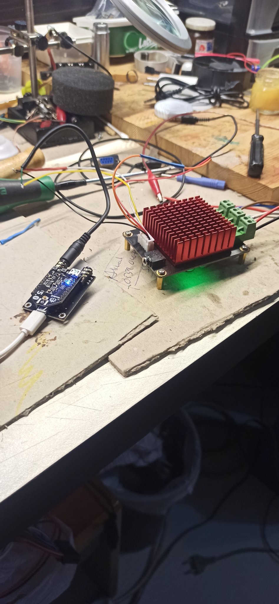

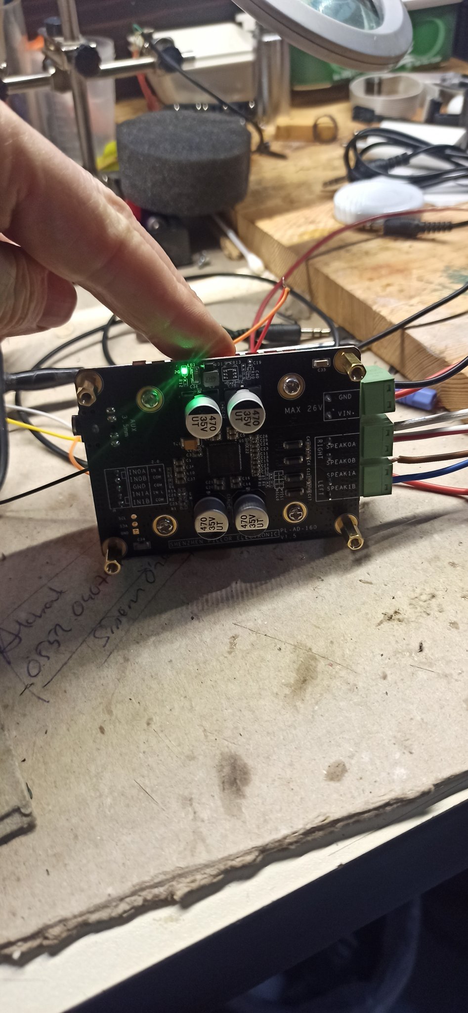

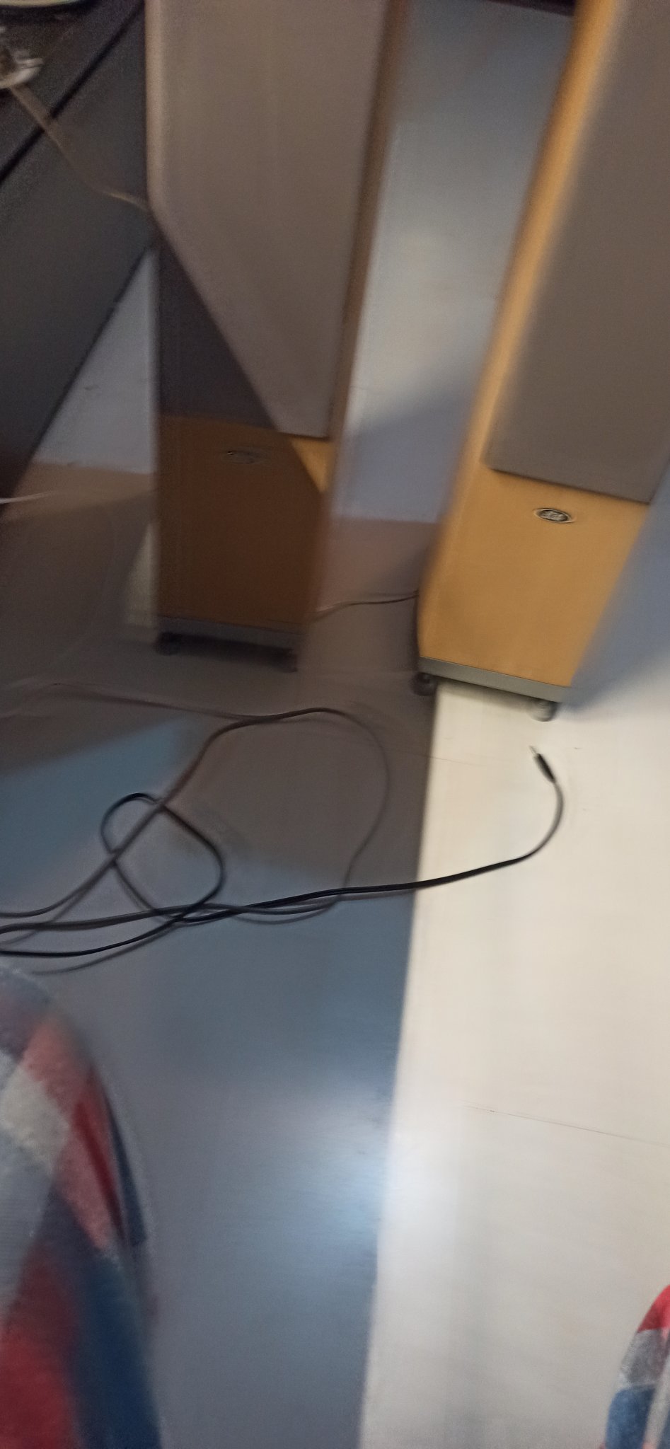

As I expressed in my previous post. ma12070 1.5v cards have arrived. I made the connections as seen in the pictures. The result is perfect. I had no problems.
frobek: I have the same question as what xrk971 is asking:
Is there a step-by-step guide for the Chinese boards? Driver installation for the CY7C68013A board went fine. My problem is that I need some hand holding with SigmaStudio. Where to click exactly? I'm fine with anything CLI, but complex GUIs like SigmaStudio always overwhelm me a little...

Porsuk, congratulations! It seems you got the analog boards?
My board is this one specifically (if it matters):

CY7C68013A installation guide:Is there a thread that shows how to do this step by step with cheap Chinese made ADAU DSP boards?
https://www.3e-audio.com/wp-content/uploads/2018/12/FreeUSBi-Driver-Install-Guide_Rev1.1.pdf
Thread about cheap ADAU1452 chinese board:
https://www.diyaudio.com/community/threads/low-cost-adau1452-china-board.309680/page-19#post-7569239
My testing setup:
Hi. I have v 1.5.
