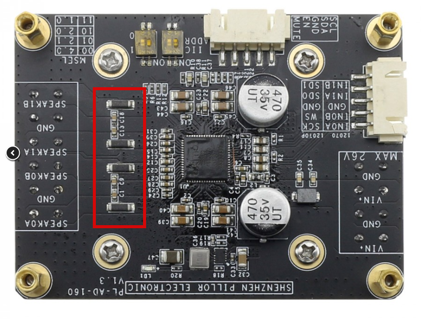

To be more precise, you need to connect speaker wires in that way
Each set of outputs has their own emc filter. To do mono parallel, do we need to bypass the emc filter of output1a and 1b on the board?
886656d1603385336-infineon-ma12070-class-clip2net_201022194807-png
All you need to setup in Mono mode it is to connect speaker wires in the right way, nothing more ) It is a RTR module, easy to configure.
IN0A and IN0B - for the left channel of the mono amp
IN0A and IN0B - for the right channel of the mono amp

This amplifier board also uses a multilayer ceramic capacitor for the audio signal coupling capacitor. Is there any discomfort in the sound quality?
I also ordered two of these amp boards. If the input is an unbalanced connection, connect IN0A-GND and IN1A-GND, and do IN0B and IN1B connect to NC or GND?
Thank you for your advice.
Recently, I started to see amplifiers using multilayer ceramic capacitors, and I was studying by reading the technical information of several Japanese companies.
Thank you for pointing out the problem of unbalanced input. For the time being, I will make an XLR balanced connection and combine it with the SMSL M500.
Toku
That s true Toku. Indeed it uses Ceramic caps and I have to admit that the amplifier sounds great )
Take care : I tested it in unbalanced mode and did not work. Seems that you really need to use it with balanced XLR inputs only....
Unbalanced mode must work.
The only important thing is to connect the negative input through a decoupling capacitor to GND.
See reference schematic how they did it.
