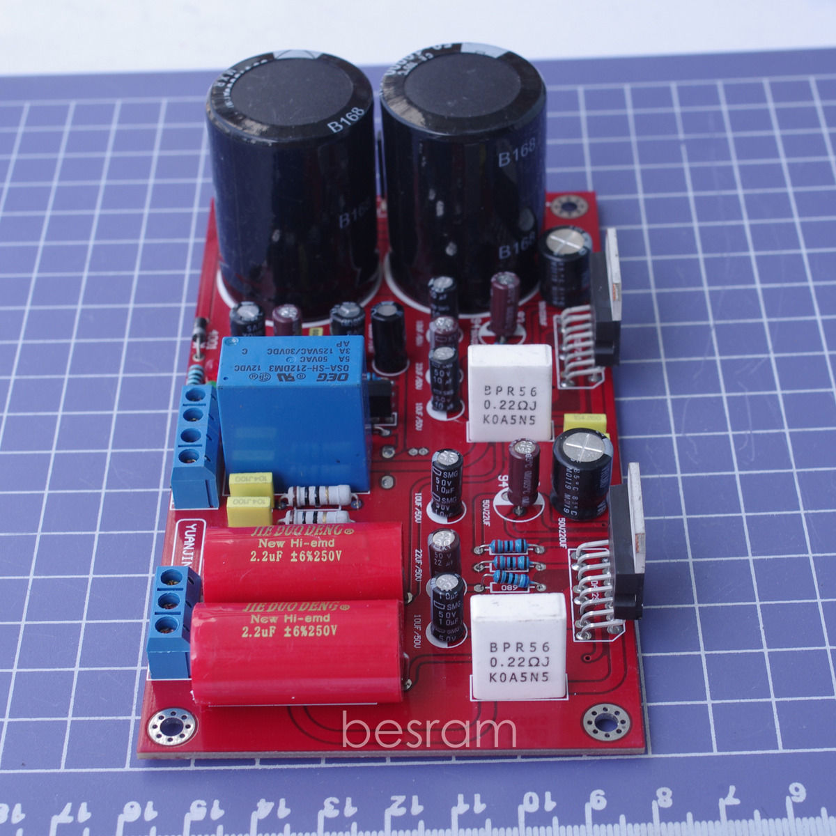

also interestingly it uses 5W power even when silent, and hence (with the smaller heatsink) runs a lot hotter.
The reason for this dissipation is ferrite core of the output inductance. It probably runs into saturation and allows dissipative leakage... Toroidal iron core is better in this range of switching frequencies. Above few megahertz ferrite is better.
This dissipation does no have influence on sound, just dissipation (and may lead to frying the chip, not only making it run hotter).
Bigger PSU caps, with lower ESR (important!) can bring distorsion down.

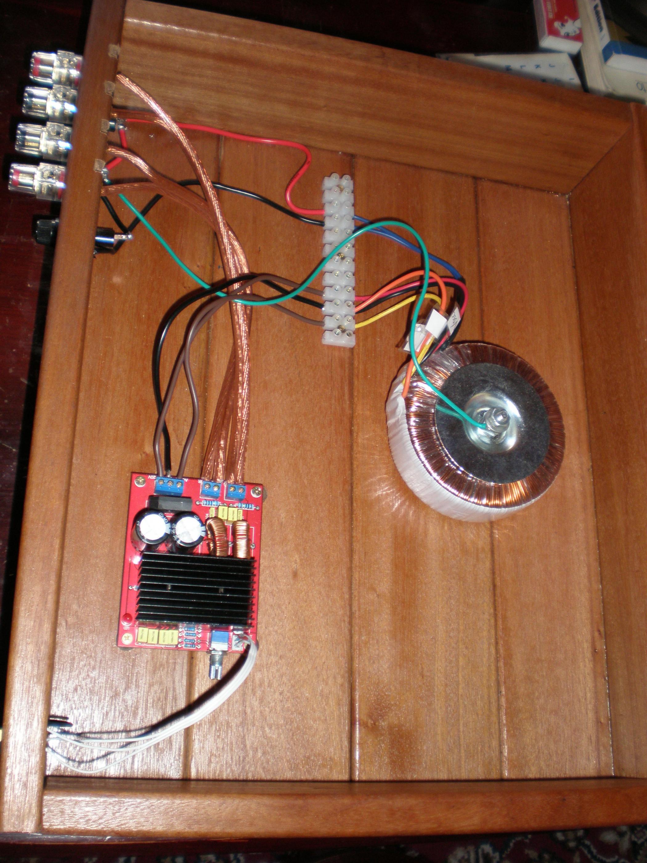

Well i had an cheap board but the cheapest one for like 18$
It sounded pretty damn sweet even with terrible output inductors and even worse supply filter.
The chip were genuine, now what i have done is i made new board for output, bigger inductors, gigantic ferrite cores, new input filters removed resistors and made new input stage with alps pot rk27
New panasonic ultra low ESR filters 35v 6800 each, dint fit well yet it works out
Abit bigger copper heatink from old graphics card and so on...
It sound neat indeed and output is super clear sounds very strong but yet the output power isnt as high as LM3886 gainclone but sounds similar, but 8950 is totally different

TDA8920B DC Offset
I notice the TDA8920B datasheet quotes dc offset at 150mV (maximum). No 'typical' figure is quoted. Can anyone tell me if 150mV is typical?
Is if there is any way to null the offset?

20-0-20 is what this board calls for do you think it would work or could be modified to take 24-0-24 at 3A

Do these little amps take a while to warm up?
They seem to be quite cool (heat wise) until you actually start running the volume. After which about 10 minutes, the thing sweetens up 🙂
