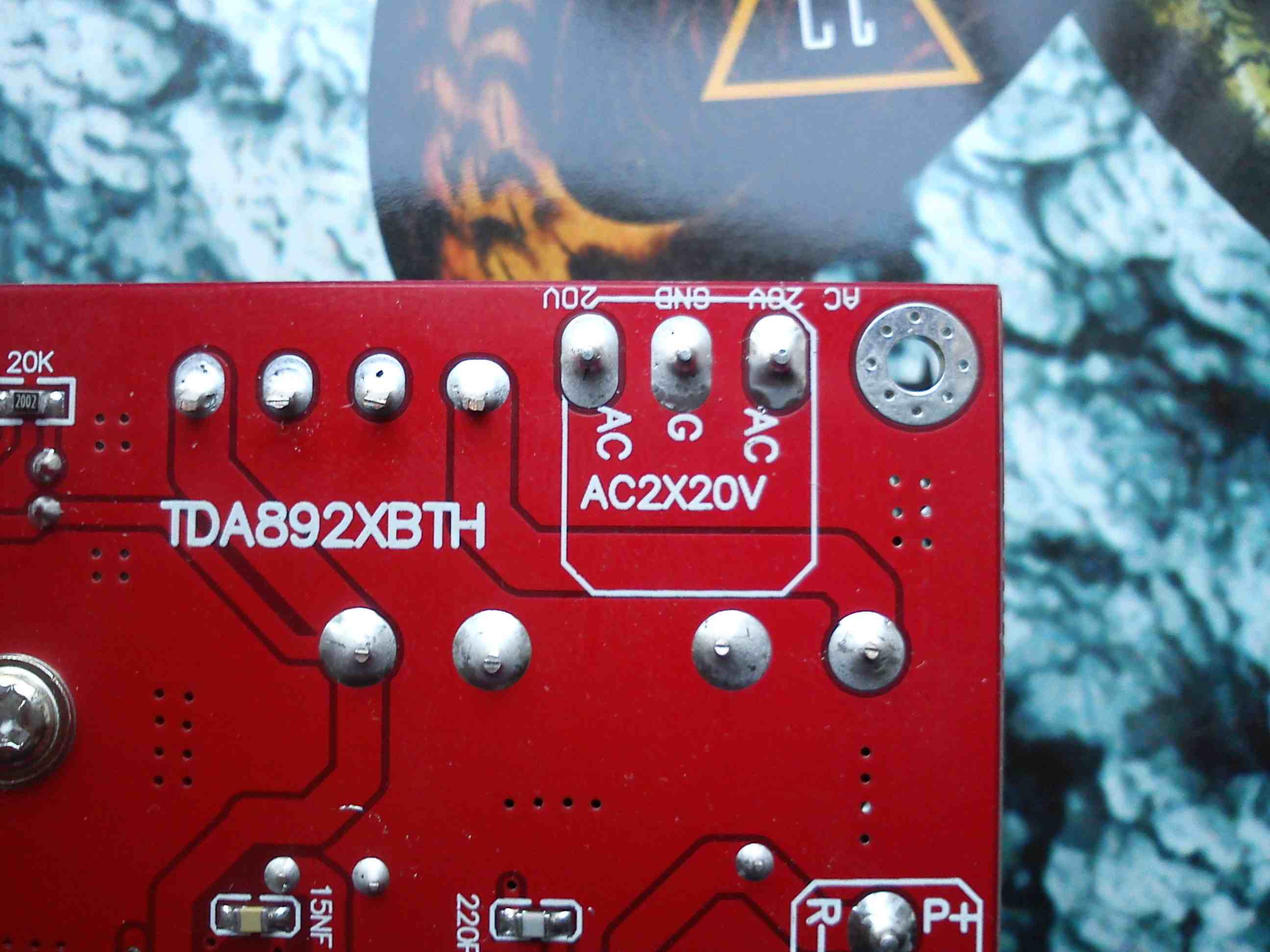

Hi.
I bought the same amp on ebay for a portable soundsystem that needed a new amp.
Unfortunately im a newb in this field and cant get more than some very small hums out of it.
Im most confused about the powersuply as im using 12v batterys to power it and I don't really know how to connect the power to the amp.... It says ac2x20v(se attachment).... How do i connect it when im using 12 v batterys????
sorry for being a newb🙄
