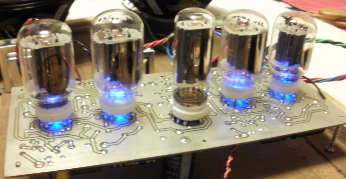

If you scrounge you might be able to do a 6LU8 PP amp.. Toner transfer etched in Ziploc bags....

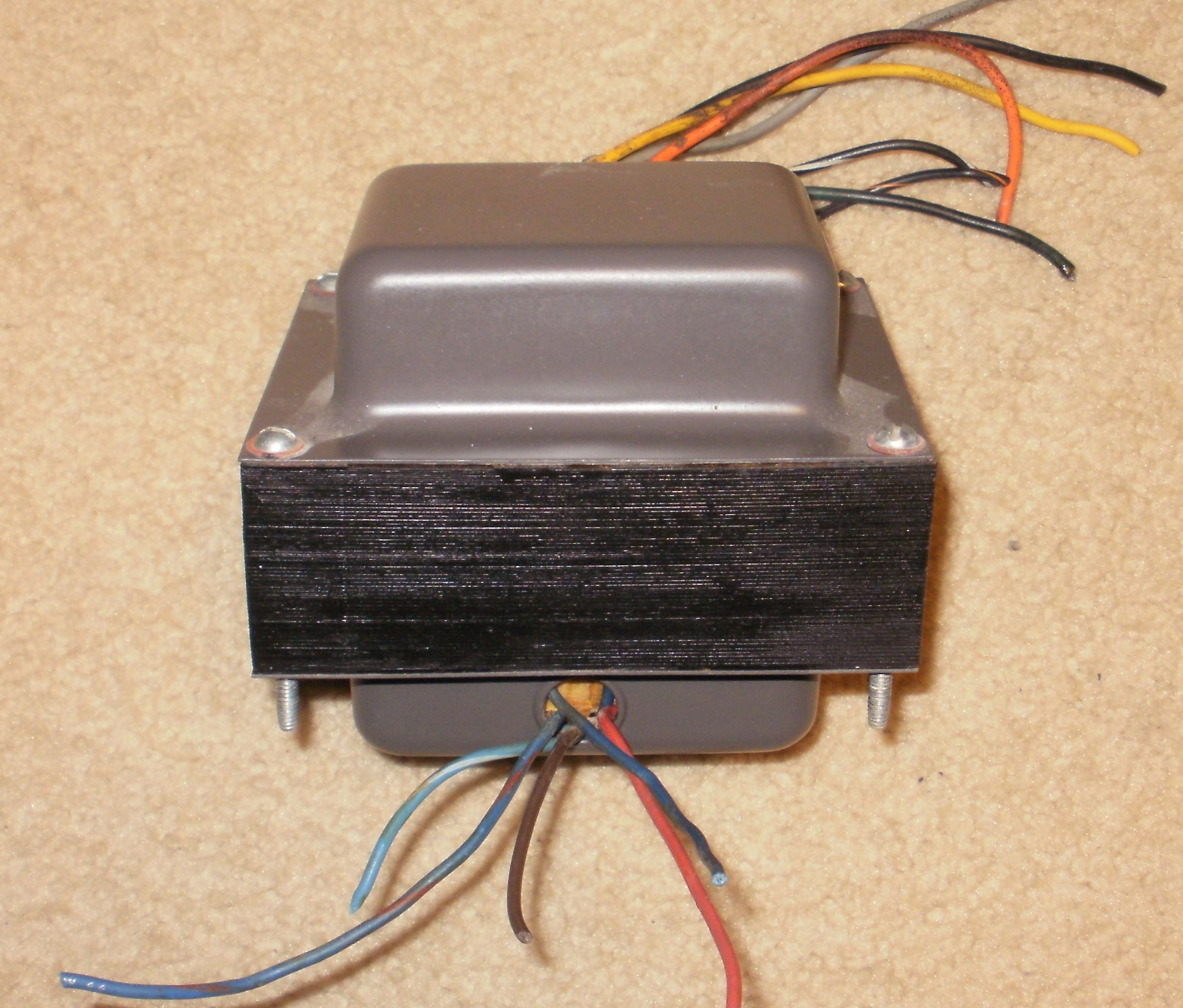

Output iron was $80 for 3, Power transformer was $45, tubes were 5 for $25, 6CG3 was $3.... I took my time in finding a lot of the parts from crags list and fleebay. I sandblasted the bells and painted, extended the leads. The outputs were from a Bogen amp, last pic..

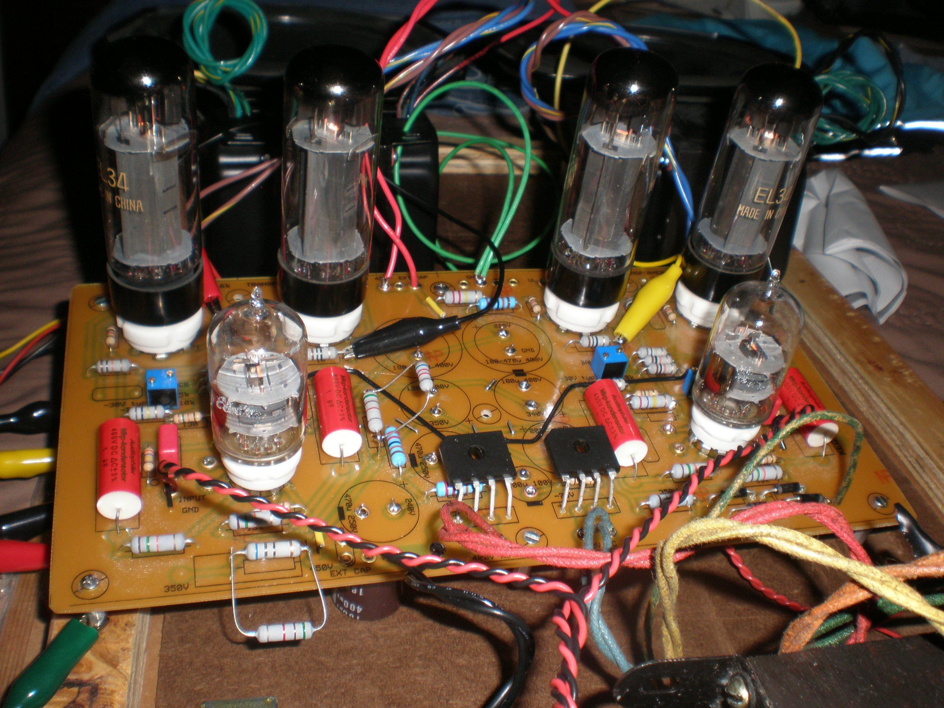

The KEG-EAR pcb was designed for the 6L6 family of tubes and the 6P3S Russians worked well especially for the price. Currently working on a mod of it using cheep 17JT6 output tubes, Edcor has a PT for $85 that should work, Output iron should be in the 25-40watt size, 6.6KRaa....

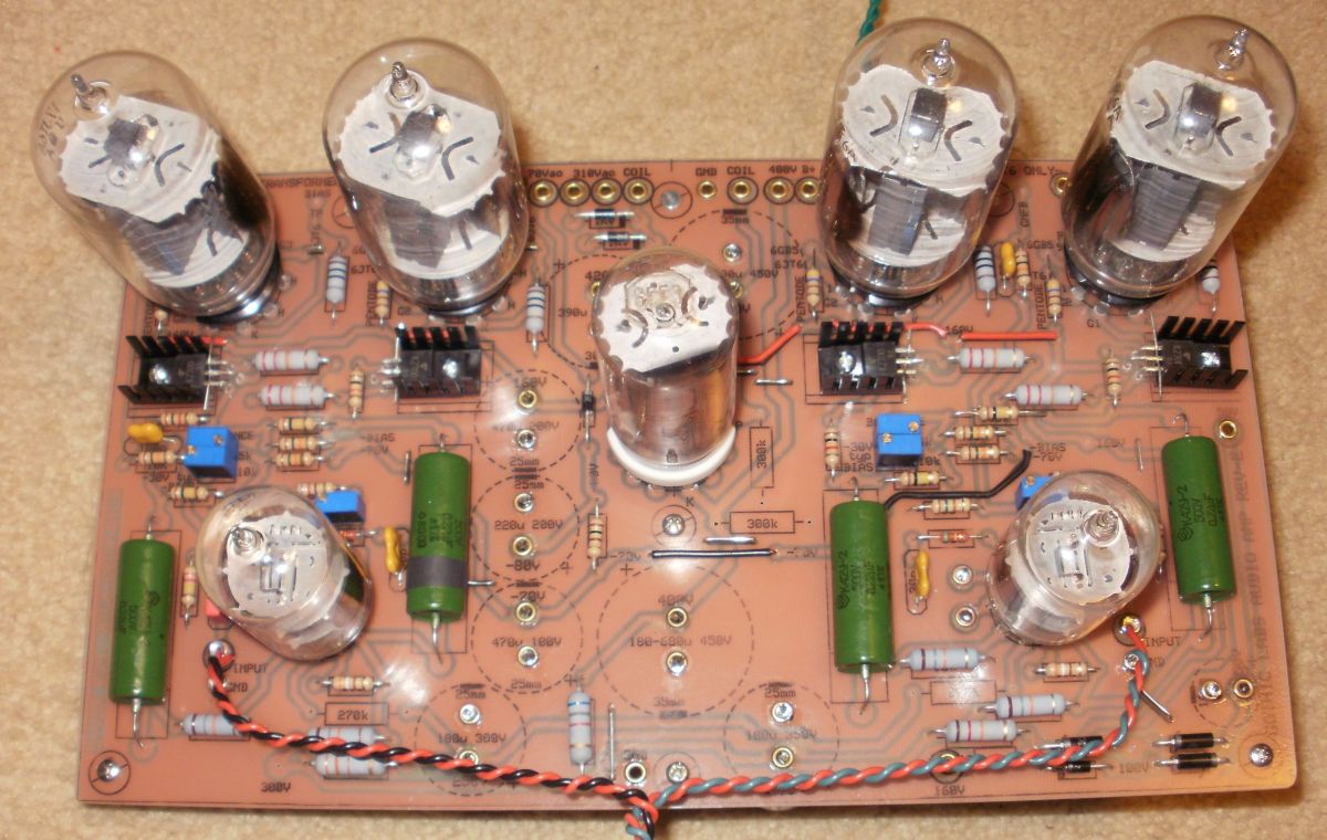

Pete Millet's big red PCB using 6GV5 will give you 25watts/channel with the $160 tranformer set from Edcor.
