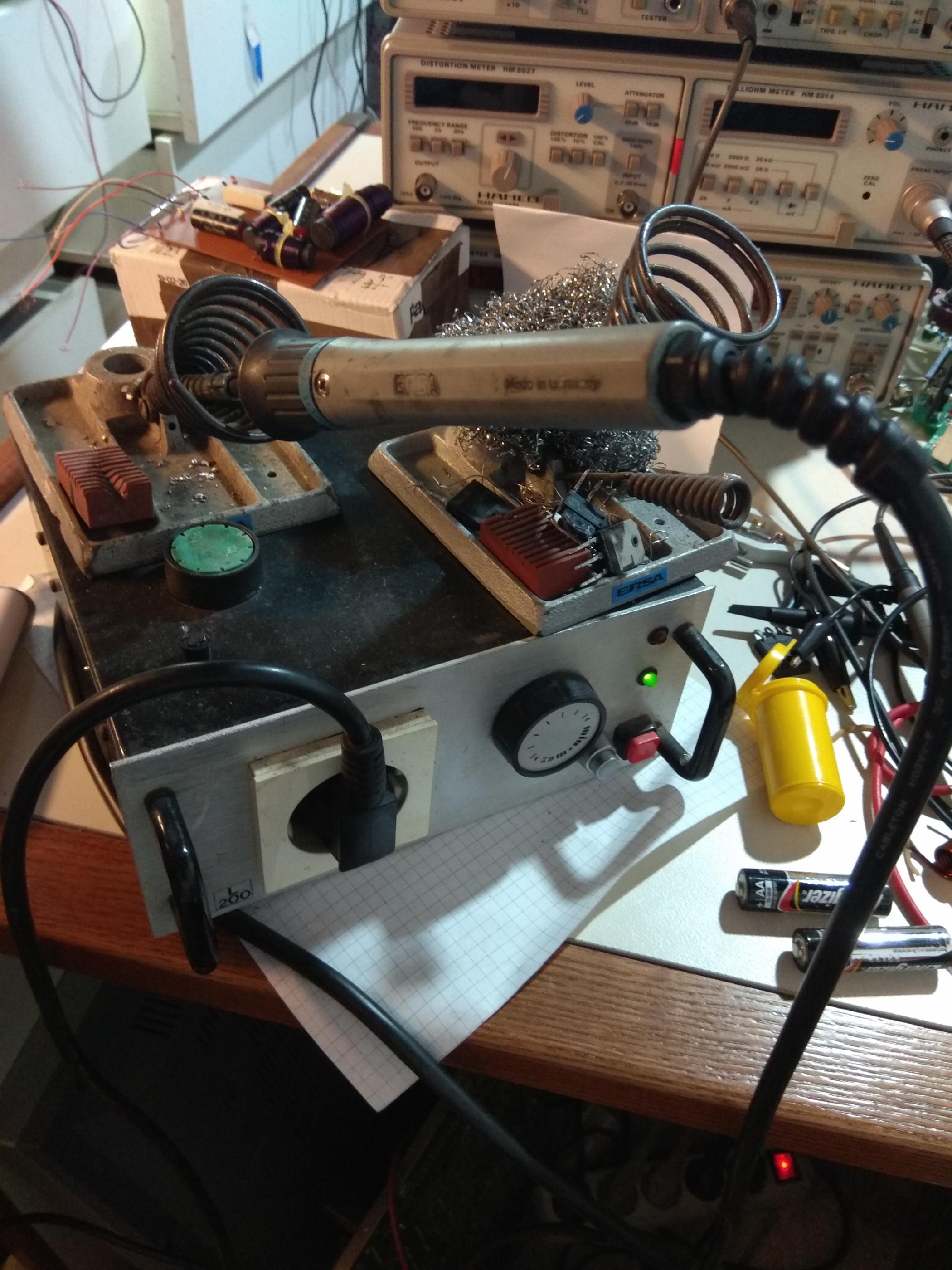

My own cheap soldering station.
A light dimmer for temperature lower, a start switch, a dimmer bypass switch.
A timer with a blinking led and sound reminder that end time is close enough and a button for time expansion.
Ersa soldering gun of course!
The best that i tried , nothing better than ERSA.
