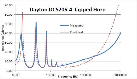

Okay I was able to do a quick impedance sweep. Which took two hours, because Praxis was being weird. My thoughts:
1. It's even closer than I expected...even up to the higher order modes.
2. Looks like some bracing around the mouth might be in order...even for this sub.
3. Looks like the copper pole cap is doing it's job on inductance, though the higher than predicted impedance in the 300Hz to 2kHz is a bit weird.
Scott
That looks pretty good IMO. Did you do a t/s param check on the driver? Perhaps actual Le is a bit higher than spec'd, which would account for the higher than expected impedance above 100 Hz or so. It also looks like the resonance frequency for your horn came in just slightly lower than the sim, which isn't necessarily a bad thing :).
No I didn't do a T/S check, I was just too impatient. I'm very happy with the agreement, closer than many I've seen. Though I did check and re-check dimensions in the model and in building it a bunch of times.

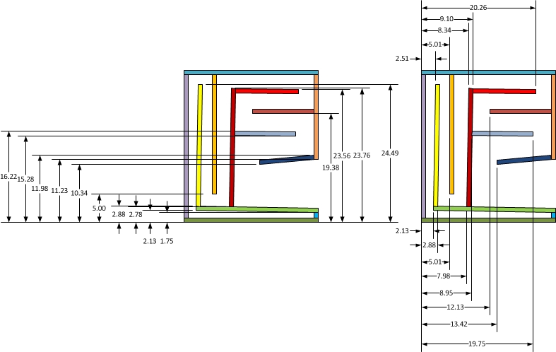

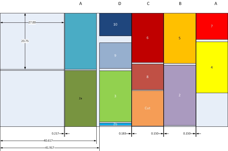

Scott,
Do you happen to have a list of the sizes of the pieces illustrated in your cutlist layout diagrams.
The illustrations you provided are great, but unless I make a full size layout with pieces positioned as in your "relative position" illustration, there is no way for me to know (as an example) the size of the piece labeled as "9"
Thanks in advance... Joe L.

I purposely have not provided the dimensions since I think it would be a mistake to pre-cut all of the pieces. Tolerances stack up way too quickly and pieces won't be the right length, especially with the oddball angle ~1.8 degrees of the expansion. I have a Delta Unisaw and I wouldn't attempt it, only with CNC. I did it by laying out the lines on the two pieces (as shown in the photo) and then transferring the dimensions from the lines to the actual pieces. Most pieces got 2 or three trips to the table saw. I also made a jig to reset the blade angle for the bevel cuts. I think this method contributed to my measured results matching the simulation so closely.

That said...I see the need. I've attached the dimensions. The fold angle is 1 degree except for the last mouth piece which is 5.3 degrees.
