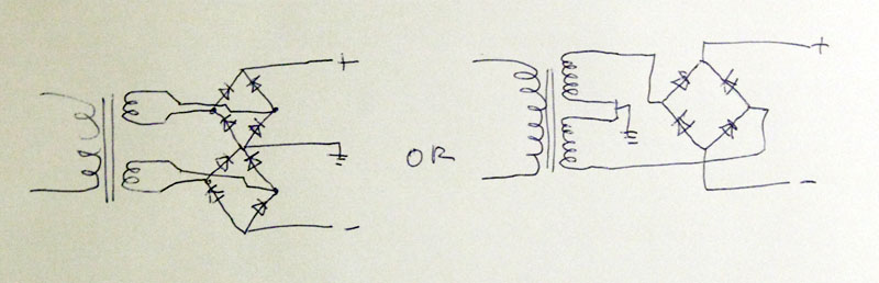

Consider using two bridges in stead of one and generate a ground between the two bridges. Posted this quick drawing before in another thread:
You would want the first option. Use snubbers over the bridge diodes or small CLC after to get rid of switching noise.

Andrew, fully agree with the discussion in this thread on earthing points of smoothing caps, but my drawing is just on two different setups for rectification, one of which is better than the other. Did so because the Hiraga drawings show the least preferred option.
