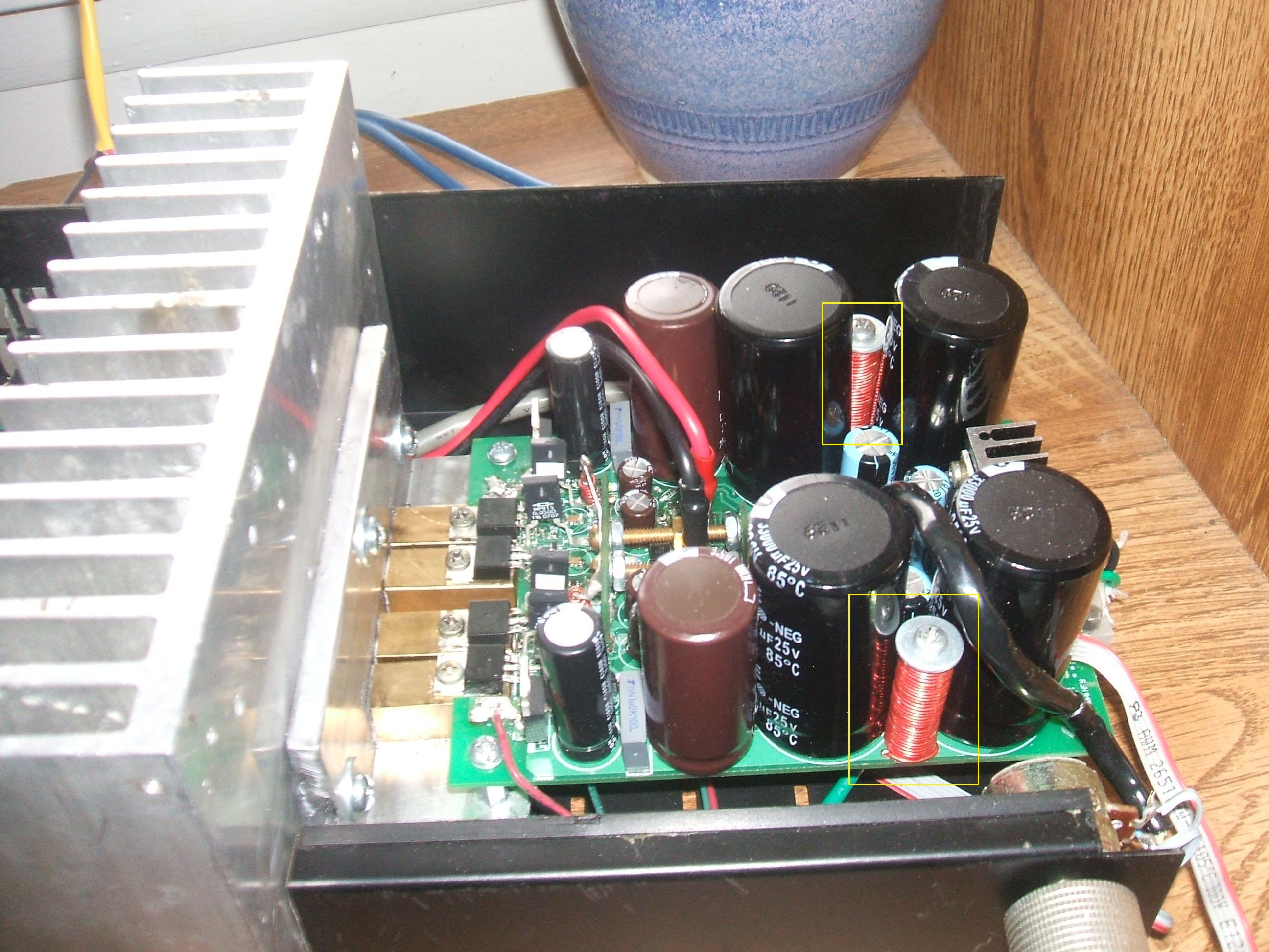

I was searching around online and I came across this schematic for an Aleph CLC power supply clone board being sold.
Web Sample CLC - My Photo Gallery
This is pretty much the exact same schematic that I was sent in todays email. It looks like he got it off the internet. I changed it slightly to this.
CLC websample2 - My Photo Gallery
Would this actually be the correct way to wire this with each section coming back separately to the loop breaker that's connected to earth ground?
