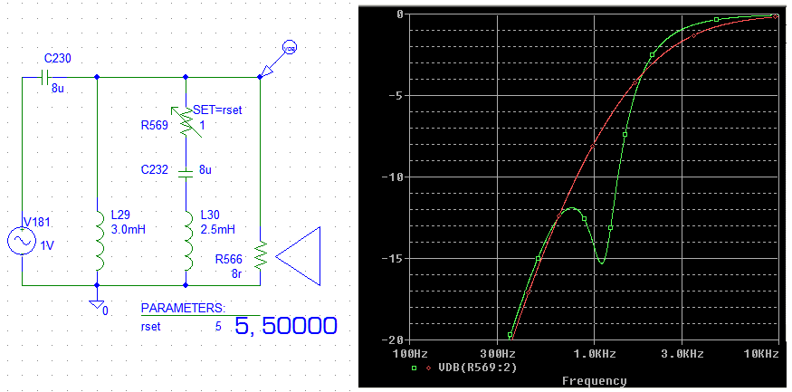

Red is the simple 8uF+3mH C/L filter, a smooth roll-off.
Green adds the 8uF+2.5mH+5r notch filter, working in context of the 8uF+3mH filter. It sucks-out around 1.1kHz, and incidentally bumps-up 3kHz.
Since the woofer is likely to be a bit strong at 1kHz (cone diameter), this keeps the tweeter off-stage in a key part of the vocal band where the woofer is still strong.
Parameter 'rset' is '5' for as-designed value, much-much-much bigger (50000) to defeat the notch for comparison. (Easier than a simulated switch in this software.)

Level in dB, here shown as a Voltage but it's sufficiently equivalent to sound pressure.What does the "Y" axis represent?
I would tend to expect what daqvin_carter has said. Impedance peaks tend toward response peaks so you remove them.

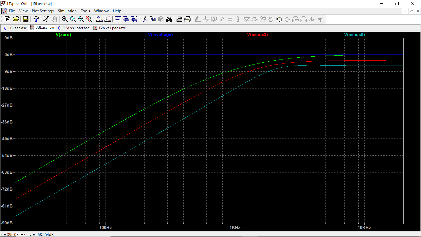

I believe the resistor switch and the autotransformer switch are to be used in tandem. I'll assume the tweeter is 8 ohms.
When connected to the autotransformer -0 db tap, the resistor switch should be open.
Since the autotransformer has no affect on the reflected impedance the load on the 8uf resistor is 8 ohms.
When connected to the -3 db tap, the resistor switch should connect the 20 ohm resistor. Since the autotransformer's reflected impedance is now 16 ohms, this parallel resistor brings the load on the 8uf resistor back to 8.9 ohms.
When connected to the -6 db tap, the resistor switch should connect the 10 ohm resistor. Since the autotransformer's reflected impedance is now 32 ohms, this parallel resistor brings the load on the 8uf resistor back to 7.6 ohms.
I modeled the circuit (without the 1125hz notch) in LTspice. The load on the capacitor does seem to be consistent.

The autotransformer is an inductor, and is part of the second order high pass to the tweeter.

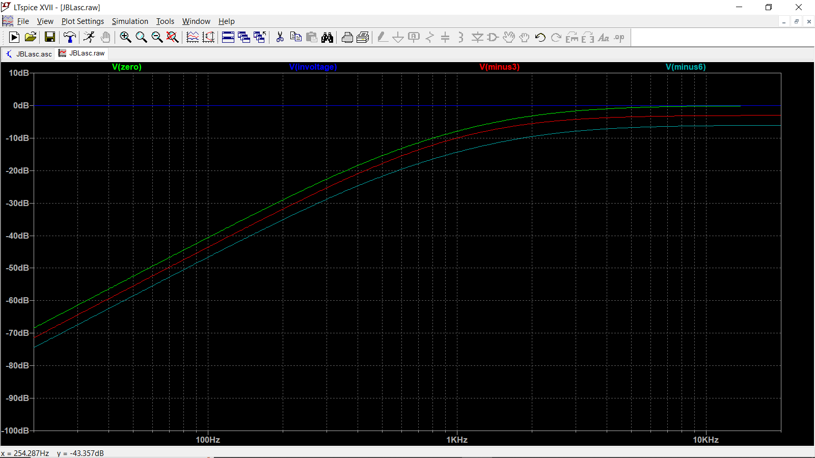

Without the resistor, one could switch to a lower value capacitor with each tap. 8uf for -0 db, 4uf for -3db, and 2uf for -6db. Then, when you use the -0 db tap, the entire 3mh of the "inductor" is the shunt part of the filter. However, when you use the -3 db tap, only 70.8% of the inductor windings are used,, or 1.5mh. With the -6db tap, it's half the windings, or .75mh. Since the inductance is not increasing at the same ratio as the capacitance is decreasing, the transfer function differs.
For reasons I can't seem to figure out, the parallel resistor will actually keep the inductance close to the full inductance regardless of the tap used. That's why the curves above are so symmetrical.
I attached a graph of what changing the capacitance alone would look like.
