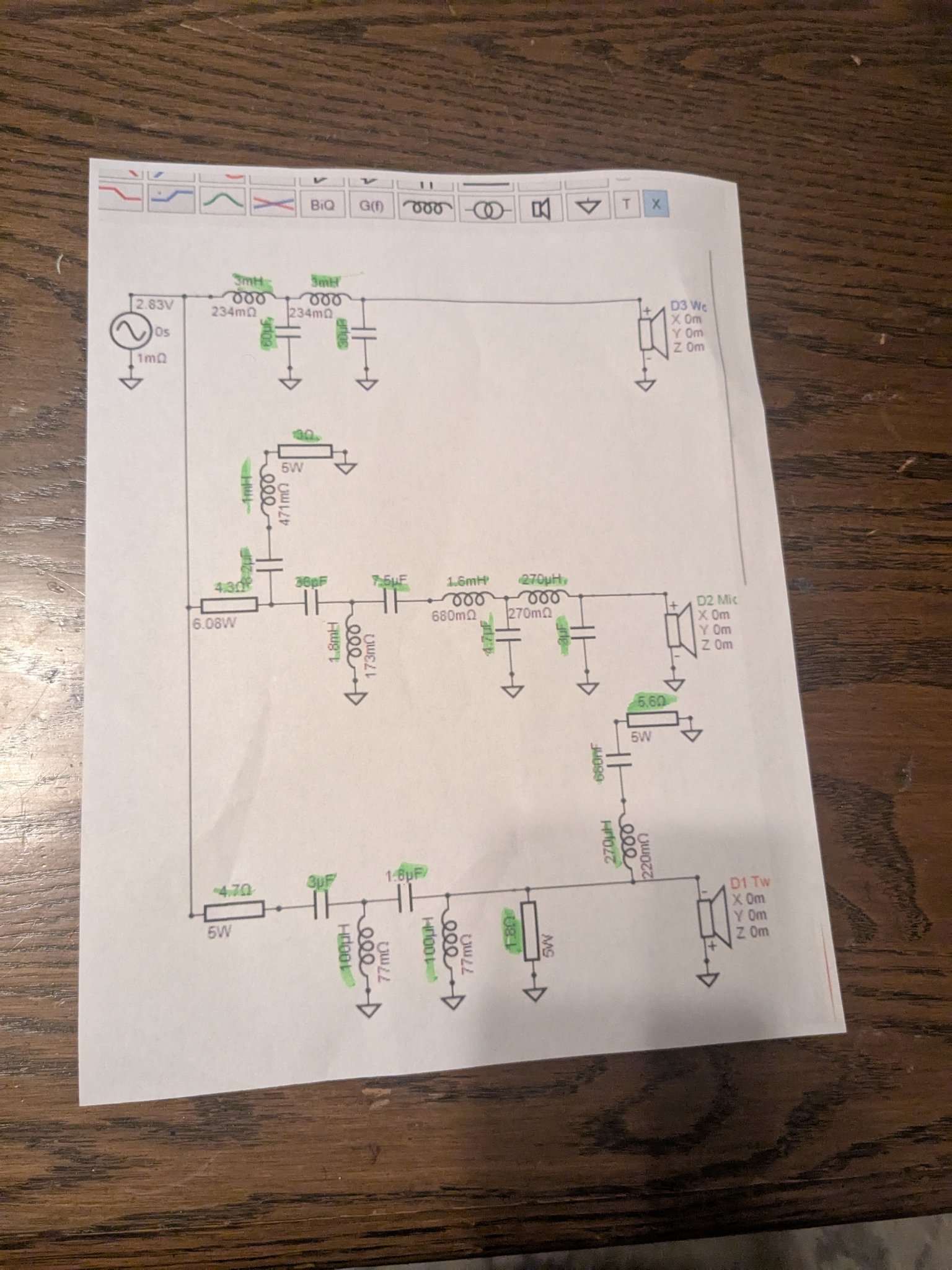

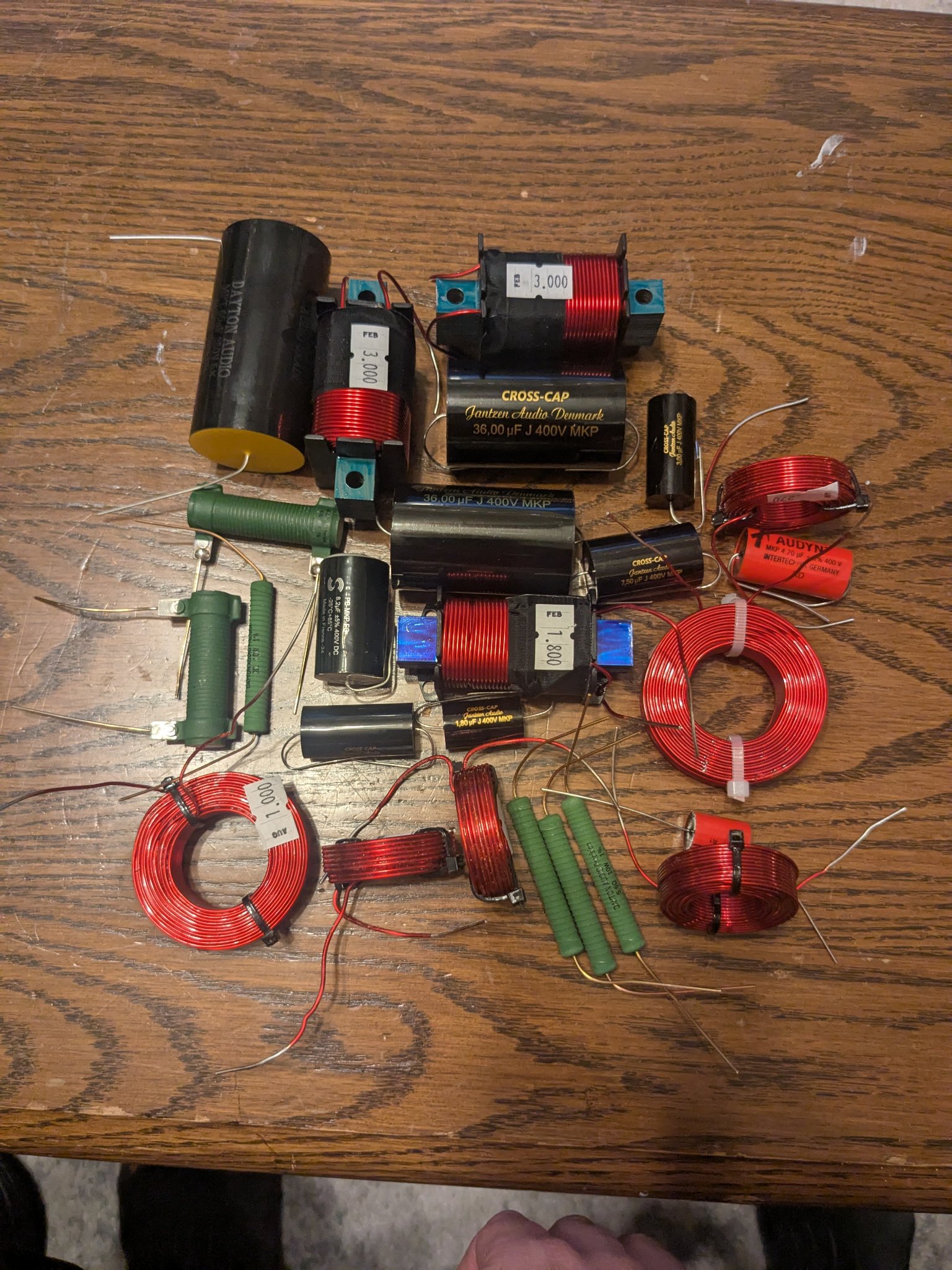

Right now this is arranged in it's circuit so the components are as close to where they go next in series.
I'm wondering if I'd be better off putting the caps more in the center and all the inductors on the outside. Then I can run some wire underneath the plate to link parts where their leads are not long enough.
I understand the concept of inductor interference. I also understand having them in different planes eliminates most of that interference. That said, these inductors feel really close together
I want to keep it tightly packed for personal aesthetics. Both filters are mounting in the wall.

That does help. I think I might hook up my LCR meter to an inductor while running current through another and see it's affects in different orientation. Should give me a better idea of what works and what doesn't
Yeah. Note the comments from Troels about not seeing a coil thru the hole of another coil. That said, even when pretty close, coils in different orientations are only minimally affected by interaction. I would worry most about the smaller coils in the tweeter.
I think I might spread them out a bit more just in case. This XO in particular is inordinately affected by a variance in inductance. 0.2 variance on one of the mid inductors can toss a wide 3-4 db dip through 3/4 of my mid range band.Yeah. Note the comments from Troels about not seeing a coil thru the hole of another coil. That said, even when pretty close, coils in different orientations are only minimally affected by interaction. I would worry most about the smaller coils in the tweeter.
With film caps, I believe you can get inductive coupling from coil to cap as well as coil to coil though not as pronounced. I'm sure several moderators will jump in if I'm completely off base.
Also avoid any large copper lands under a coil.
No, they won't. Moderators don't offer technical opinions, they're just amiable policemen who want to keep the peace.
Nah, not yet. I measured all the components today to pair them up. PE sent wrong cap so I cannot hook it up yetI may have missed it, but have you measured, and listened to this x-over yet?
I would connect individual sections with jumpers and see if they match the sim. For me it would be quite a bit of listening before I was ready for a final x-over design.
My last 3 designs have been within 2db of their sim. I just full send them now. I leave the rest as character. Perfection is the enemy of completion.I would connect individual sections with jumpers and see if they match the sim. For me it would be quite a bit of listening before I was ready for a final x-over design.
