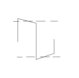

However, what I'm seeing is a distorted square wave. Granted, it's not music, but, music is not a (1) sinewave either. Herin lies the falicy of relying on, or comparing specs with, a standard THD test, which uses a sinewave as a source. Atually, a square wave is the sum of a fundamental frequency, a third harmonic of 1/3 the fundamental amplitude, a 5th harmonic of 1/3 the 3rds amplitude, a 7th harmonic of 1/3 the 5ths amplitude, and so on. A whole group of frequencies that magically, thanks to mother nature, sum to what we call a square wave. Incidently, this could be looked at as 33.3% distotion of the fundamental sine wave. This is not so unlike music. A group of frequencies summed from many instruments and or vocals to form a very complex, constatly changing wave form.
But, when I put a square wave in, a distortion takes place in the circuit that makes it change into a half sawtooth looking wave??? It extends all the way up to about 1k decreasing in distortion as frequncy climbs. Actually I would also expect a gain change as the inductors impeadance goes up but, I do not see that. Can anyone explain this phenomina?

Whats the bandwidth of the amp? Will it produce the higher frequencies? If its not to high, you won't be seeing a square wave. It won't be able to reproduce the high frequencies and it will wind up looking like a saw tooth wave.

Well, that I beleive is at least somewhat correct. If the bandwidth was "cut-off" between the fundamental and the 3rd harmonic frequency, I would see a sine wave of the fundamental freq. Without all those odd harmonics in the progression I suggested (or something close to what I suggested) there would not be a square wave. However, most of us have experienced the square wave rounding off due to limited bandwidth and it generally does not look sawtooth. But something inbetween a square and a sine 😀
To answer your question davidallancole, I'm not totally sure what the bandwidth is. It does a good job up to 200kHz. After that the positive portion of the waveform starts to become higher in amplitude and looks distorted. I became somewhat "afraid" of bad things happenning beyond 300k so I gave up on going any higher.
O.K. Between 200k and 700k there is a little peaking, using a sine wave input. The actuall -3db point is 1.05mHz

Sounds like the bandwidth is excellent, the only other thing I could think of without being there is are your probes calibrated for the square wave? You know that little square wave that is generated on the scope you can use to calibrate the probes so they don't over shoot or slope to much.
I got myself thinking 😱 with that square wave, harmonic post up there. Actually describing this stuff is pretty difficult even if you do know what your talking about 😕 But, I think I stumbled in my own mess here...
Trying to use a load as low as 8 ohms on a common source amp like this reduces optimum gain. I have used bulbs and big Rs on this design several months ago and this is true. That's why I said I expected the gain to go up with frequency due to the inductors Xl going up with frequency. But it's real flat, gain wise, from 30Hz on up to a Meg except for the low Q peaking. Like I said, lower -3db @ 6-7Hz! But, the square wave is full of multiple frequencies. And down low, the fundamental and low order harmonics of the Sq Wave could be operating in lower gain while the higher order harmonics are operating in a higher gain... Hence sq wave distortion
The average peak level of the sq wave is the same as the sine wave would be. I'll show a pic... Does this mean there is some frequency dependant gain variation causing the distortion, due to the rising Xl???
