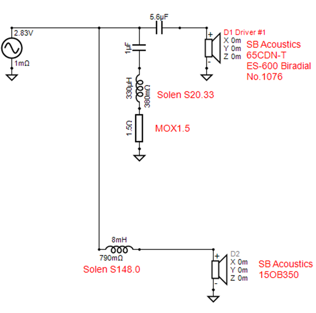

If a crossover design calls for an 8mH / 0.790 Ohms and the two closest options are 8.2@0.800 ohms (Solen) or 8.0 @ 1.75 ohms (Janzen), which would be better or does it even matter? Actually I've already purchased the 8.0/1.75 Janzen which I suppose I could return. Any issues with either of these? If it matters, this is for a first order XO on the woofer with only a single inductor. Thanks

My apologies. Meant to say 790 mOhms (0.790 ohms) vs 1.75 ohms. Original post has been corrected. The design is for a first order 600 Hz XO point on the SB Acoustics 15OB350. Basically, I have the correct 8.0mH Janzen coil, but it has twice the DCR of XO spec. The other available option (Solen) is 8.2mH with around 800 mOhms DCR....... Will I have any negative effect with higher DCR of the Janzen, vs lower DCR but slightly higher Henry's of the Solen....or am I overthinking this?

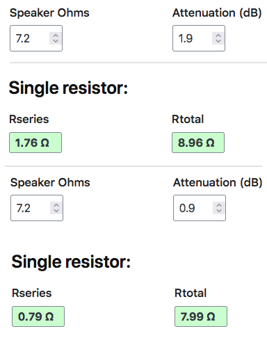

Considering just the resistance part of speaker impedance (8ohms), the loss if using 0.79ohm is around 0.4dB and if using 1.79ohm is 0.9dB.

As well as reducing the available amplifier power output due to the higher impedance, the 1.75 ohm inductor would drop nearly 2dB of available sound output to heat, the .8ohm inductor less than half that loss.

You'll want the one with the 0.8 Ohm DCR then. If you don't like its 8.2 mH value, you can take of a few windings to get down to 8.0 mH (and slightly lower DCR even closer to the value shown on the diagram).

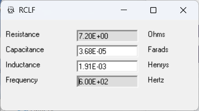

And 5.6uF into 8 ohms doesn't give 600Hz either. More like 3552Hz. It should be 33uF.8mH into 7.2 ohms doesn’t give 600Hz.
