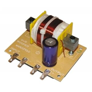

The short answer is yes you can use an inductor after the 7R series resistor
and in this case it will work far better than using an overall series capacitor.
The 7R series resistor is undamping the fundamental resonance and using
a further series capacitor will make it stick out even more, even if it rolls
off the upper bass somewhat.
The place to start is with a 4ohm (that is the correct impedance in this
case) car subwoofer crossover inductor, 7 or 8 mH for around 80Hz.
Place it before the RLC.
rgds, sreten.
