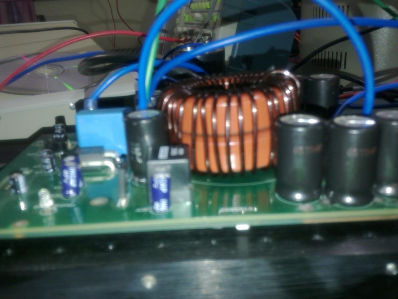

29 turns on two stacked T184-2 micrometals toroids, does anyone know a simpler or more compact approach? I don't. That's 100mJ energy storage! 😀
Actually i saw ferroxcube gapped toroid and it has very less windings, they compared it with micrometal core indeed.......stacking the cores surely offers alternative solution.
Workhorse,
What is your load impedance? (8 ohms, 4 ohms, etc. speaker?)
2ohms and sometimes 1 ohm
But gapped toroids in the usual sizes don't get close to 100mJ, this is a lot of energy and trying to store it in a small gap results in problems. Remember that the biggest gapped toroid from Ferroxcube (26mm O.D. and lowest permeability) does just 1.5mJ 😀😀😀
I usually prefer large OD cores like T225-2 which can take thicker wire for winding for high current applications and still compatible with 1U rack space height requirements, which cant be met with double stack cores due to incresed height.
Gapped Toroid offers EMI infernos from that "GAP" as a bonus also😉

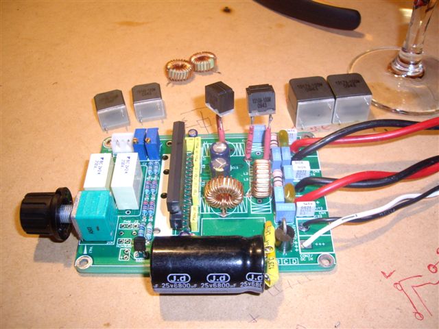

I've been looking for some decent output inductors for my PBTL TAS5630 build, so this seems perfect.
http://focus.ti.com/lit/ds/symlink/tas5630.pdf
The switching frequency is 400khz. According to the data sheet a 10uH coil would be fine. And although I'm not entirely sure as to the absolute current requirement, the 1D14A-100M looks like it should do fine. Of course if you can recommend something else based on your expertise in this field, that would be great.
I would require 8 inductors for the stereo pair that I've built and I should be able to offer a subjective opinion. But I'd be more interested in the measurements I'd be making also.
The couple of inductors I've tried haven't been particularly good when it comes to distortion and higher power levels. So It would be great to try something built specifically for the job.

I notice that gapped ferrite shielded core (used for classD filter) produces more heat than -2 material toroids, especially at area around the gap (it get hot around this gap area).Gapped Toroid offers EMI infernos from that "GAP" as a bonus also

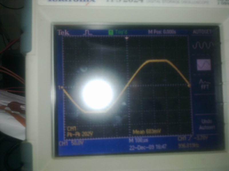

Check the clipping at 1Khz @ 2 ohms loaded

This is very nice clipping behaviour - without the slightest hint of rail-sticking.

Yeah..!!!
Actually the good control loop and some trick is at the work😉

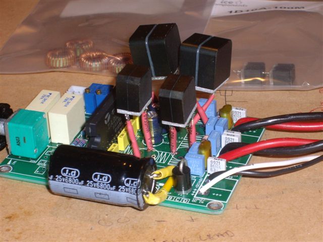

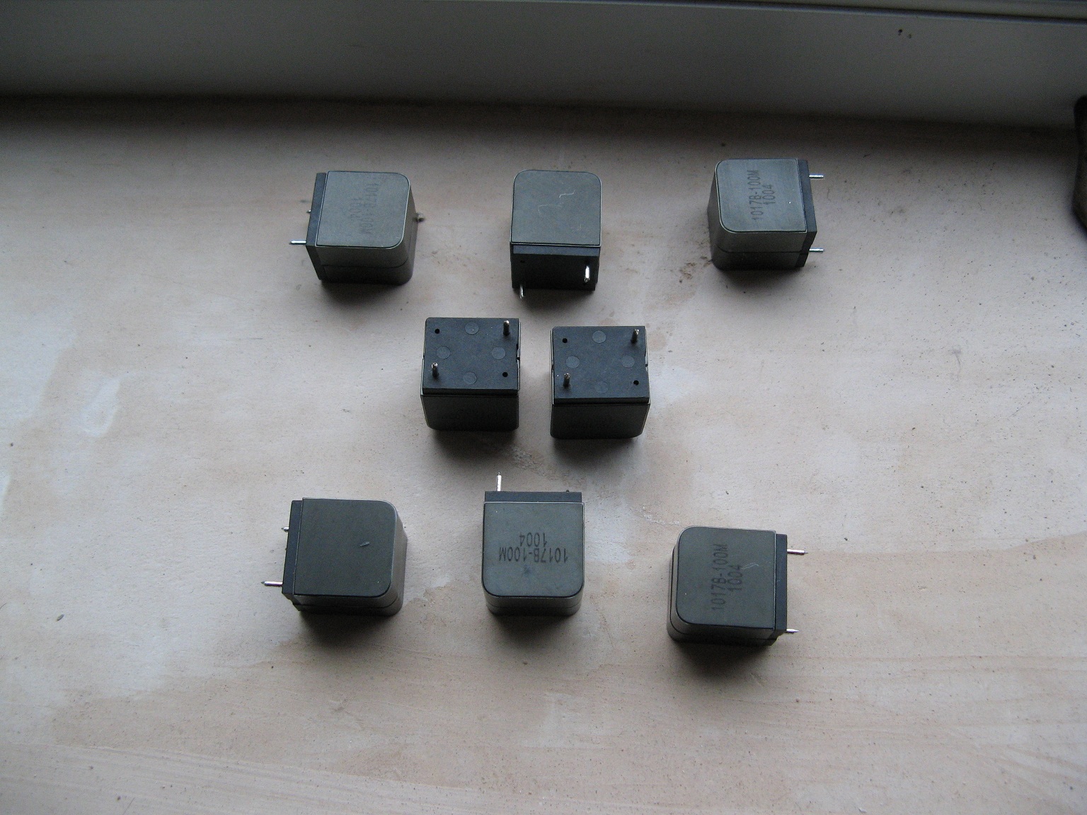

My samples arrived a few minutes ago. I shall most likely get around to testing them out in the next few days.
Edit, Darnit linking to pictures in your gallery gives nothing but trouble. Open the link in a new window and it should show up.
Edit - sorted it.
Edit - sorted it.
some results

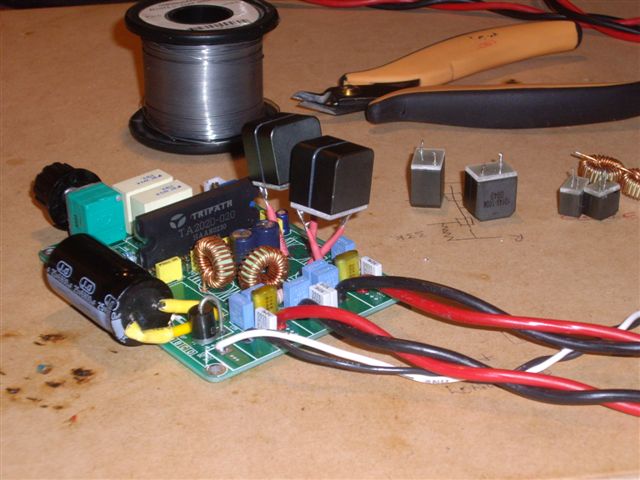

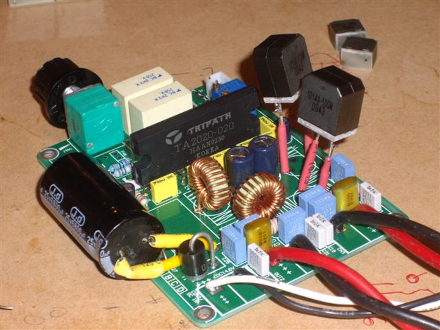

Its been about a week now of evenings swapping inductors sent to me by Ice Components for evaluation. I have got through the three pairs that they sent, objectively testing them.
I started with the smallest (physical size) units the 1D10A-100M, these I noticed a slight signal attenuation compared with the stock ferrite toroid inductors, but otherwise all three test samples were sonically very very similar.
I have no measurable results, purely audible. I think I was pretty thorough with my listening tests, playing many genres of music at various listing levels. Throughout my listening I found the sound produced was very transparent with no apparent colouration.
In my personal opinion, I would have no hesitation in recommending the use of this product.
PS. I am still considering winding my own air cores or air core toroids, unless of course someone has four in their junk box (10uH) that they would like to sell or trade???

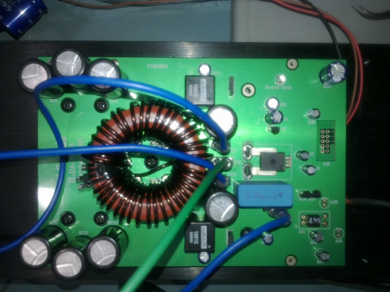

Hi Workhorse
Looks super cool .. very compact 😎😎😎
Like the way of putting all the leaded components on the ground plane side and ll the SMDs on the other ... makes for good ground plane and very compact design ..... by the way plane her is ground and not Vss, right .... have seen the advice from IRF on using Vss as plane for the outout secetion and GND for input ..... have been thinking about sot of doing both, meaning full GND on one side, and pouring as much Vss on the other side as possible ...
We're talking half bridge here, +-100V PSU and 5kW into 1 ohm .... right

Baldin, its multi layer board, top layer full GP i.e. GND and switching area is covered by VSS plane on middle layer, rest of middle and bottom layer being used for routing traces. Its +/-180VDC rail half bridge and 5KW in 2ohms.[😛]
Yes its post filter feedback topology and clocked at 270kHz.😉 and not self oscillating because the application demands sync, its not a diy oriented, its for serious high power pro-audio apps.
