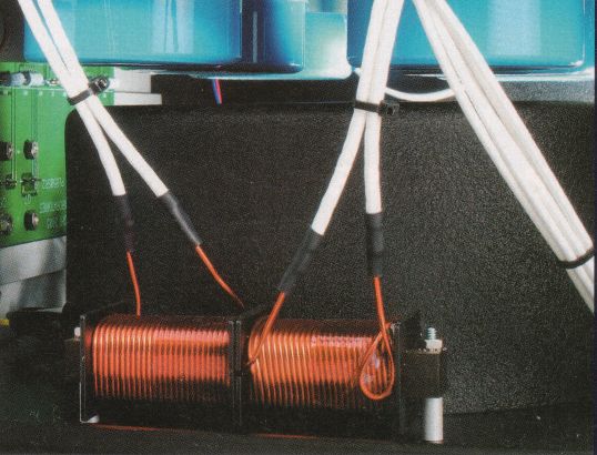

And what did the Master do? Post #22
This is what Mr Nelson uses himself in the XA 160 amps.
A ferrite core. And it looks three times as small as the air core I use myself.
They look like standard iron cores. Those will be good enough for me.

I recently bought a few 250va toriodal autoformers to play with.
Just for fun I hooked one up as a choke in a choke input filter.
I know it wasn't suposed to work but under a 1A load it preformed just like a "real" choke. Then I removed all the windings a real pain in the *** . The 3" core I uncovered was
wound from a continious strip of steel. Then I wound 58 turns
of #16 copper wire around it and measured ~10 mh.
Using a 18v center tap transformer, a pair of Shokey diodes, this
10mh inductor and a .25F cap I measured 7v into a 1ohm load.
When allowing for the voltage drop in the diode and sourse resistance in the inductor this matches the 9v X .88 = 7.72v
expected. The #16 wire did get slightly warm at this 7A load
them hot when loaded to 12A. but not bad for a salvaged
transformer core and ~ 8 feet of #16 copper wire. This may not
work with othe transformer cores.
