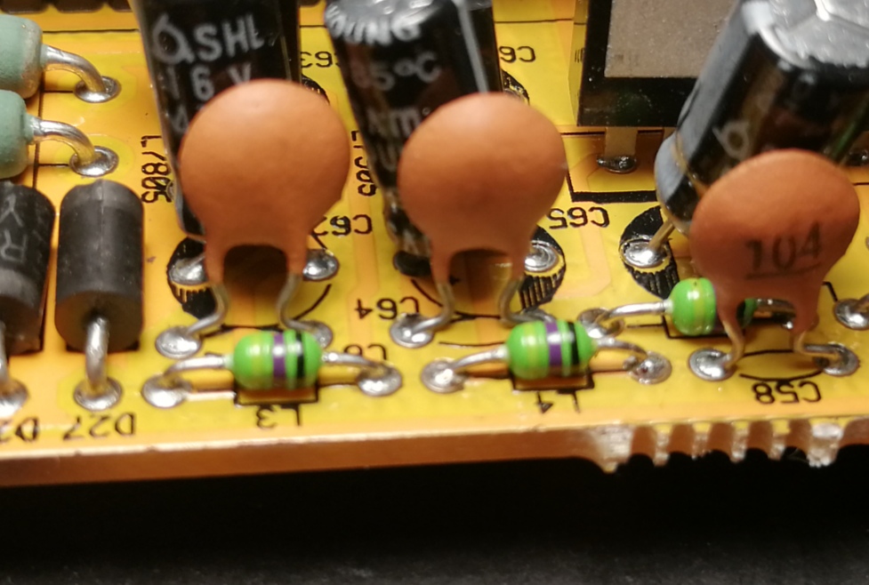

Mouser or digikey electronics stocks those
The part number is .
78F470J-RC
78F470J-RC Bourns | Mouser
78F470J-RC
The originals are 5 ohm .
The replacements are 2.7 ohm
I’ve used these in multiple amps and have never had a problem .
The original 5 ohm ones are very hard to track down and unless I’m mistaken I haven’t heard of anyone finding a source for the originals .
But like I said the ones I listed have worked perfectly fine in multiple amps I’ve used them in
The resistance is just a product of the resistance of the length of wire. It's not critical to the circuit. Ideally, the resistance would be 0 ohms but copper wire has resistance.
