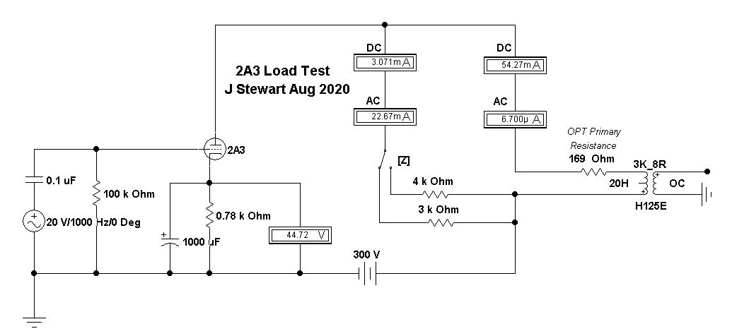

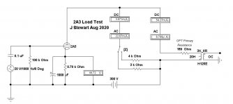

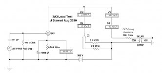

Some Info On Load Testing
Hope this helps to understand the simple method I referred to for load line testing. The test resister is simply in parallel with an unloaded OPT. The resulting current and/or the voltage in the sample resister can be measure to obtain the information required. No load resister should be attached to the secondary.
From the test data in this simulation the audio power dissipated in the 3K resister is ~1.54 Watts. Power in the 4K resister is ~1.28 Watts. And rp of the 2A3 calcs out to 723R.🙂
Driving the stage to clipping will give the max audio power available.
For a PP pentode stage driven to clipping there will be a maximum. The audio power will decrease on both sides of that load condition.

That also eliminates a bunch of the available power from the output stage too unless the resistor is so large that it is only really defining a maximum load impedance.
Yes! No, no, no! Try to stay on the road, folks.
The TUBE factory needs to specify the TUBE, without transformer flaws and losses. Assume a transformer can lever "any" final load impedance. THE way to test the TUBE is a large choke (to pass DC) shunted by a variable resistor. Measured mid-band so choke parasitics are "small".
Say the optimum load for the tube is about 5k. And the application load is nominal 8 Ohms. Then over-wind the choke for a 25:1 turns ratio.

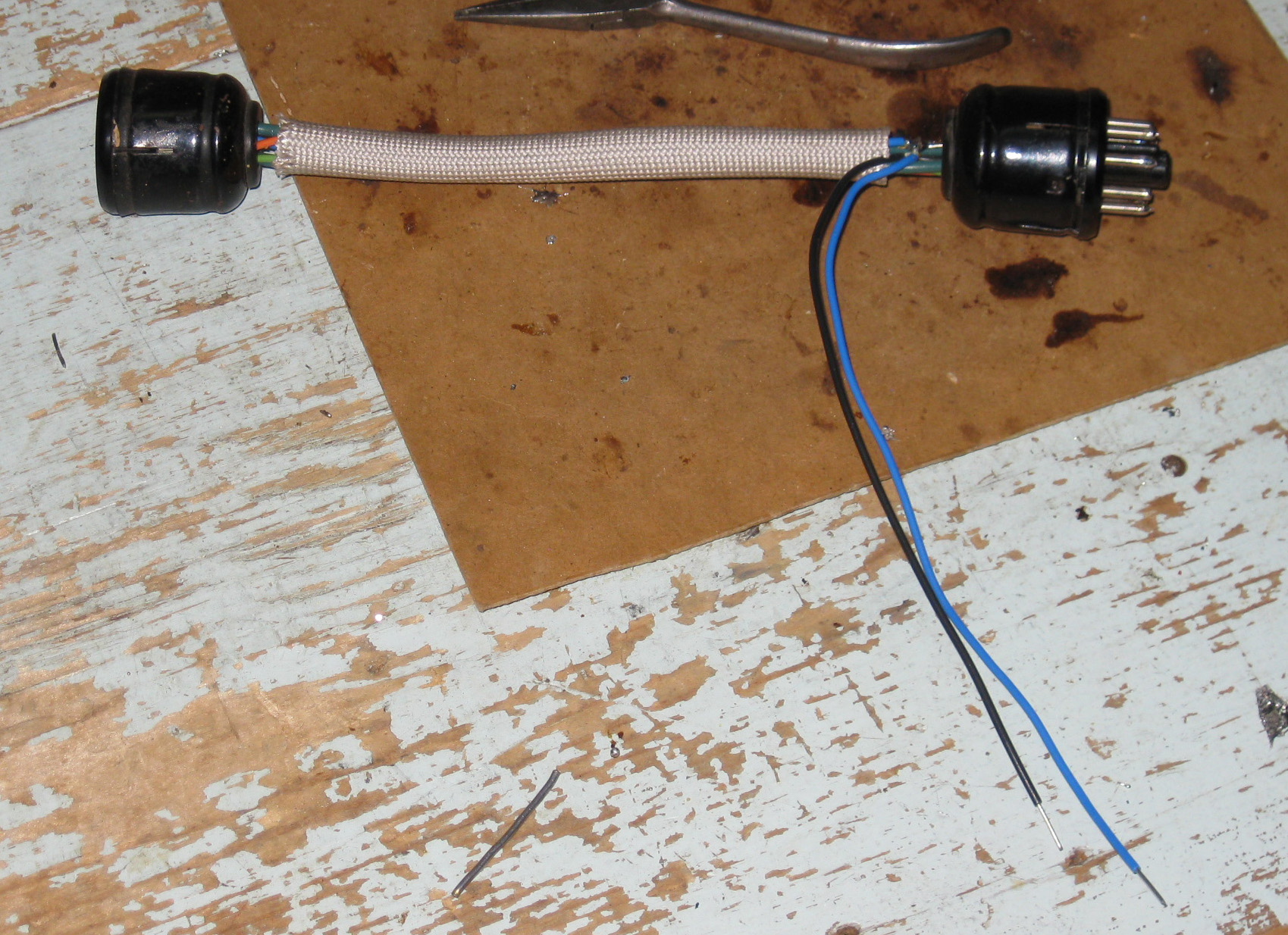

I worked on my Grandson's Peavey JSX in 2012. The build & performance are top notch. Results attached.
In 1965 I built a PP 6L6GC amp for a friend to use with his guitar. And another circa 1956, PP 25L6s for use as a practice amp. The front ends were not HIFI but the rest of those amps was.🙂 Hammond had no replacement OPTs in those days & I didn't go looking. What was available worked OK.🙂
