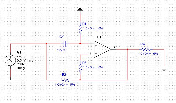

I think what he means is some type of circuit that could "multiply" the value of a given inductor. This would be especially useful when trying to build an inductor-input power supply filter. Normally the required inductor is so large and heavy that it roughly doubles the overall cost of the power supply. If there were a clever way to use a "small" inductor and "multiply" its action, then you could make an inexpensive amplifier that had inductor-input power supply filtering.
Unfortunately, this is just a wild goose chase.
A "capacitance multiplier" only mimics one aspect of a capacitor -- it's tendency to oppose a change in voltage. However, a "capacitance multiplier" does *not* multiply the energy stored in a capacitor. (If it did, then we could get rid of all the big capacitor banks typically found in high-quality amplifiers.)
So the analog to a "capacitance multiplier" would be a circuit that tends to oppose changes in current -- i.e., a constant-current source. However, this circuit doesn't increase the energy storage. You would still need a big inductor that would store enough energy to supply a constant charging current to the filter caps.
I think the confusion begins with the misleading term "capacitance multiplier".
Hope this helps,
Charles Hansen
Disabled Account
Joined 2003
this is what I had in my mind, conceptually.
you can certainly work out the math to see how this whole thing looks like from V1's point of view and compare that to an inductor.

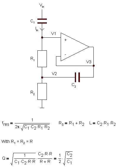

passive to active or active to passive does it really make much difference. The circuit I posted acts like an RCL series connection, with the component sizes as noted.
Well I use it in a voltage devider and in the feedback of opamps as a frequency dependent resistor, This creates an EQ..... works great too
\Jens

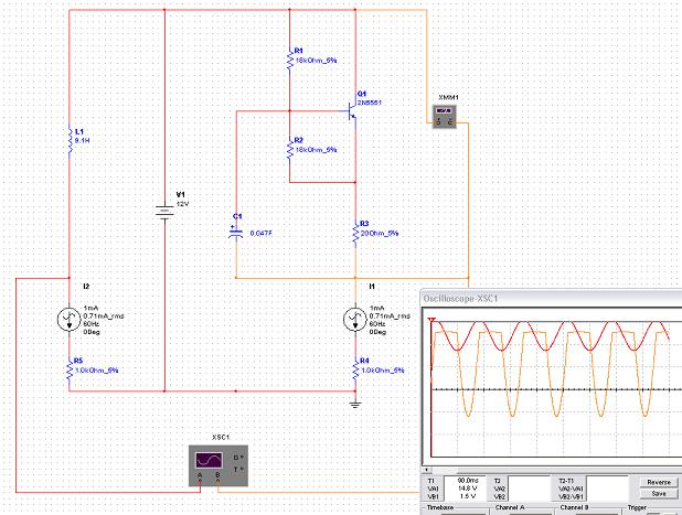

it seems to have worked in my simulation.
the left side is essentially a traditional L/C circuitry and the right side the "inductance multiplier". one big draw back for the inductance multiplier is its heavy internal resistance (thus voltage drop).
