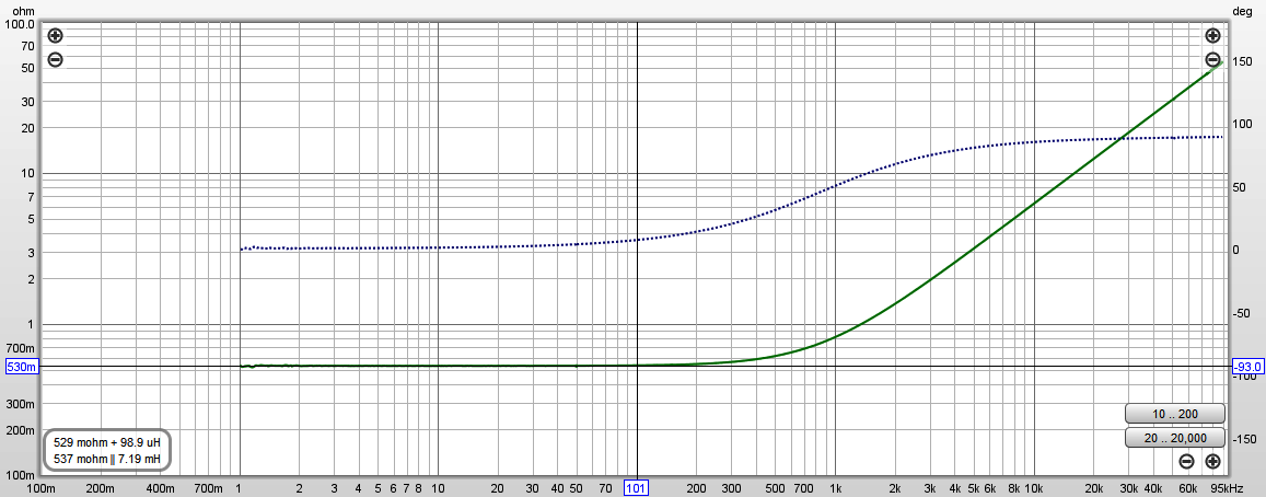

I luckily have two reference air-cored inductors of 10.5uH and 99uH (vintage 2nd grade Sullivan-Griffiths), so can confirm that the impedance measurement tool of REW (where I use a 0.05% resistor for a reference) adequately measures the value of the 99uH inductor (spot 98.9uH measurement at 100Hz shown in impedance plot below).
Similarly, the REW tool also confirms the same accuracy with the AC+DC measurement tool in the link:

Jesper, apart from the 99uH reference inductor in post #41, I also have a 10.5uH reference inductor which the REW based system measures as 10.5uH.
With the 99uH inductor the impedance starts to rise from low frequency 0.53 ohm at about 500Hz, and the phase from about 100Hz, and REW calculates 100uH at spot frequencies from 100Hz up (99uH at 20kHz when phase reaches 90 deg). The 10.5uH inductor impedance starts to rise from low frequency 5.3 ohm at about 20kHz, and the phase from about 5kHz, and REW calculates 10.5uH at spot frequencies from 100Hz up.
I'd anticipate similar accuracy down to at least 1uH, but without a reference you won't be able to tell no matter what method you use, so perhaps looking out for a 1% reference at 1uH may be your first hurdle to jump.
