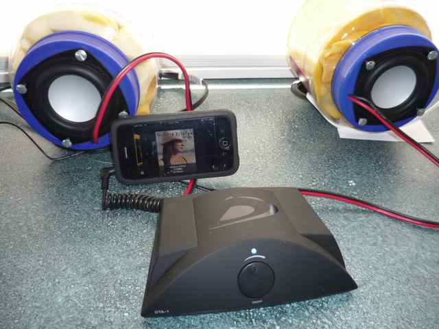

I bought a pair of Aurasound NS3-193-8A from Madisound to make a speaker bar for my computer (to be built real soon now). The Dayton driver is listed as a replacement for this. Madisound recommends 2 to 3 liters, sealed and stuffed. So that is what I am going to do. Should work for you too. -Tom-

2 to 3 liters stuffed and sealed. Now that I can figure out. Thanks very much for your help! The ear will have to do on this one. Testing materials and software...maybe next time.

Aurasound 3" NS3-193-8A speakers in Kirkland Mixed Nut 2 liter enclosures, semi-sealed and stuffed with rotting foam bed pad, driven by the little Dayton DTA-1 T amp.
Seriously this was just a little test of concept for a computer sound bar I intend to build. Sound was pleasant and balanced, and best on axis in this nearfield application. The wife said "I can hear bass!", but then she was comparing to her laptop's built in speakers.
