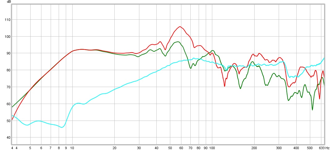

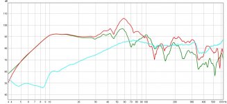

Here are some measurements I did; a 12" in a closed box, levels are at 2V.
- Blue is outside, 1 meter, 2pi, same as the models predict.
- Green is measured at the drivers head, sub in the trunk.
- Red is measured near the windshield. This is where spl is generally measured in dB drags.
The flat to 10Hz is caused by cabin gain.
The boost at 58 Hz is caused by a resonance related to the length of the car.
As you see, output is about 20dB higher at 58Hz.
If I were to make a ported box that would do peak to 100dB at 1watt at 58hz, it would do 120dB in this car. Add 1kW of power and you're at 150dB.
Offcourse, in real life there would be some losses, and obviously it would sound like crap. But i hope you understand now how they get such high levels in cars 😉
Hi carneoleon,The boost at 58 Hz is caused by a resonance related to the length of the car.
Could you explain what you mean with "the length" in relation to the "resonance", you referring to?
Djim
The interior of a car can be simplified to a tube with both ends closed. In such tubes the lowest resonance occurs approximately at the frequency at which 1/2 wavelength = tube length.

If car interiors were behaving like 'resonant tubes' (1/2 or 1/4 wavelength resonators) they should have at least one end open! It should also leave the evidence in the impedance plots.
However, I do agree partly with carneoleon in post#22 about the cabin gain. They are very small rooms that do act like pressure chambers. Instead of the distinguish resonances of a ½ wavelength resonator you see an almost chaotic and overlapping resonances. Doors, dashboard, metal sheets all resonate at their own frequency and act like vibro-acoustic resonators. Therefore the idea that car acoustics can be explained with simple 'room-modes' by length, height and width or act like a tube resonator is way too simplistic, in my view.

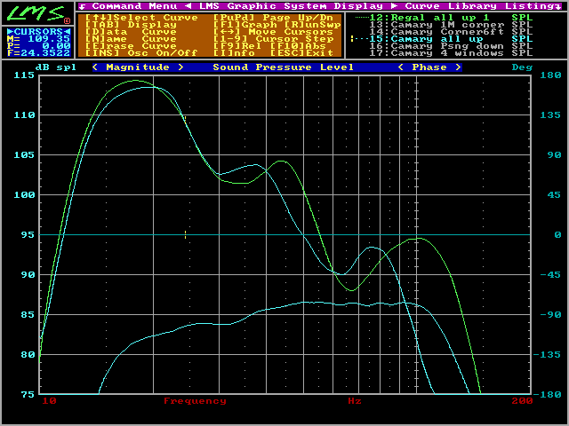

Actually you can see the resonances quite clearly. There's resonances due to the length of the cabin and due to the width. The width is approximate 72" (47hz) and the length is approximately twice that. (23.5hz)
All of this is complicated by the fact that resonances cut both ways, and the null produced by the width of the cabin is fighting the peak caused by the length, because they're right about the same frequency.
If you wanted to find the ideal car, you'd want one that was smaller than average, and one where the length was particularly short. Not coincidentally, some of the loudest cars out there are old Hondas, which are particularly short and small.

Thanks for the plot. Like I said, they behave like small rooms (that have room modes too) that also act like pressure chambers. Since the length is not an consistent value because the back and the font are sloped & complex shaped, the acoustics cannot be simplified with just length, width and height, as if walls are perfectly parallel. In addition, the walls are also not rigid but act like vibro acoustic panels that release acoustic energy, which makes it even more complex.
