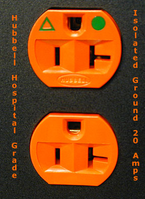

At the local hospital here the outlets are orange, the green mark on them signifies that they are on the generator in case of a power failure.

Some info...
I glanced through this thread, and it seems no one has mentioned this, so I'll take the bait.
These orange plugs are orange for a reason. Any orange plug with a green triangle next to the ground slot is an Isolated Ground (IG) receptacle.
In a normal receptacle, the ground prong is connected to the metal mounting tabs, which in turn make contact with the metal box that the plug is mounted in. This ensures that the box, the ground plug, and the centre screw that holds the receptacle cover are all grounded.
In an IG receptacle, the ground prong is not connected to anything else. This must be taken into consideration when using these in household situations. Normally, these are used in commercial and industrial situations, where all wiring is in metal conduit. In this case, the conduit is also grounded, and provides the safety ground for the receptacle box and cover plate. The ground prong is connected to an isolated ground wire which goes back to the building's main ground, to reduce common mode noise on the ground prong of the receptacle.
When these are used without conduit, in a household situation, one of two things can happen. If the ground wire is connected to the receptacle box, then the ground prong will not be grounded, which causes a safety hazard. If the ground wire is connected to the ground screw on the receptacle, then the outlet box and cover are not grounded, which, although not as bad, is still not good. When IG receptacles are used without an isolated ground, a jumper wire should be added between the ground screw and the receptacle box.

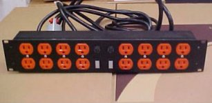

these are not isolated ground, i am pretty sure, but i will measure to verify. there is no green triangle on the sockets.

dorkus said:these are not isolated ground, i am pretty sure, but i will measure to verify. there is no green triangle on the sockets.
If they are IG receptacles, it is likely that the ground prongs are wired to the metal chassis, effectively making them regular receptacles.
ok. somehow i doubt it, as this power strip is intended for standard computer/telecom equipment, electronics, etc...
