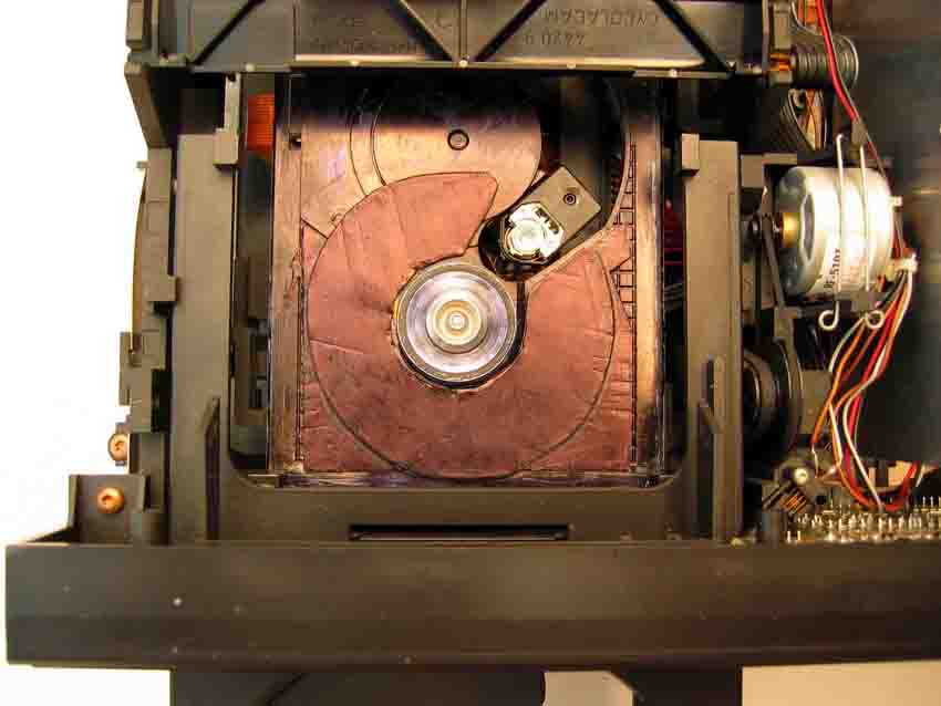

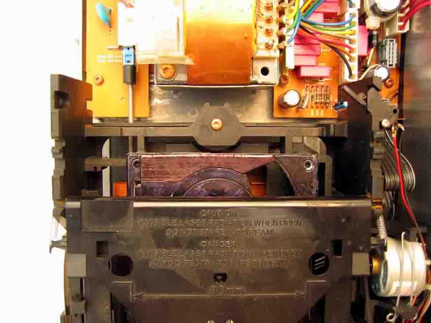

CD drive mod
I did add some lead to my drive of my Marantz CD 80 (CDM 1 mk2)
See pictures. Basses are much better after that.
Peter
