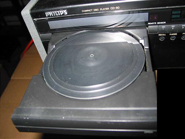

Here's a pic of an ISO-DRIVE disc damper. It's a machined nylon(?) disc , the same size of a cd , which is placed on top before closing the tray. It's fairly high in mass , so I guess there is some flywheel effect. It's also suppose to reduce disc flutter(vibration) so there is less error correction necessary , thereby less servo induced noise. These were sold in the late 80's.

Increasing the rotating mass makes it much harder for the motor to change rotation speed which it must do continually as it plays the disc. You'd have to size-up the motor and control electronics along with the mass, but other posters have already pointed out that there is absolutely no point to doing either.
