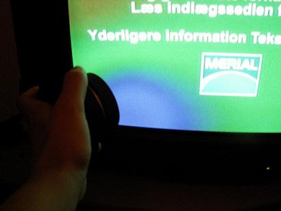

Sorry sreten im very interrested... but not in a debate about it being a sheilding or not.... when I have pointed out Its not a sheilding after shinobiwan har rasied that question I really don't see why that debate must go on
As I recall this was my answer and that would be enough!:
No the magnet is not there to cancel magnetic strays
That kind of clear answer should stop a very unimporten debate if it is or is not a sheilding!!! I know its not a sheilding so there fore no more people posting their very "cleaver" answers about its a sheilding or not!! -havent any one noticed i have written about it sounds like it's 2 db higer?? still the debate runs on...
Now I have ****** up my tv just to prove and to stop this debated about something totally useless...
The xt is being held about 40cm from the screen!!!!
If someone accidently should be color blind and still wants to debate sheilding.. I can tell you it has made a huge blue dot on a green background!!!
Ps. shinobiwan it really wasen't your fault, im glad people ask questions, it was other people that just kept your question going, even if I would say I had pointed out its not

Now why would you go and do something stupid like that? 😀

Man that's a lot of typing up there. I just wanted to interject that you can fix most CRTs that have been damaged this way by degaussing them. You can do this with a degaussing coil (like a computer CRT monitor has) (Don't know it would work to put a computer CRT up to the TV and degauss the monitor, if it would degauss the TV as well? )
OR you can do what I have done (had to do) a few times. carefully, slowly, move a magnet in circles, from close and slowly moving backwards away from the TV, and you may be able to neutralize the magnetic field you JAMMED on there with the speaker magnet.
BTW, keep that magnet away from the cassette tape collection ok? HTH
/edit: you may have to give it the treatment several times if the imposed field on your TV is very strong. I have not yet had a TV I couldn't fix good enough to enjoy watching again this way.

stocker: don't worry was just a joke would never have done it if I hadent had a degause coil just by the hand😀
