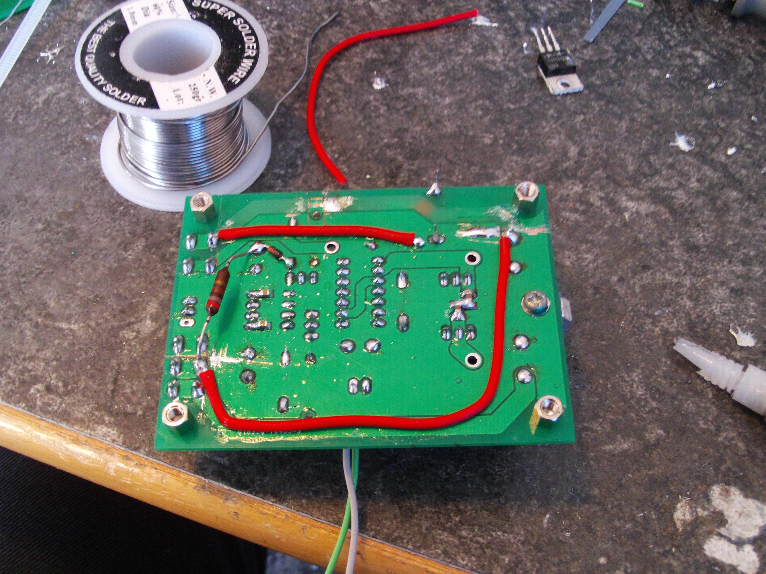

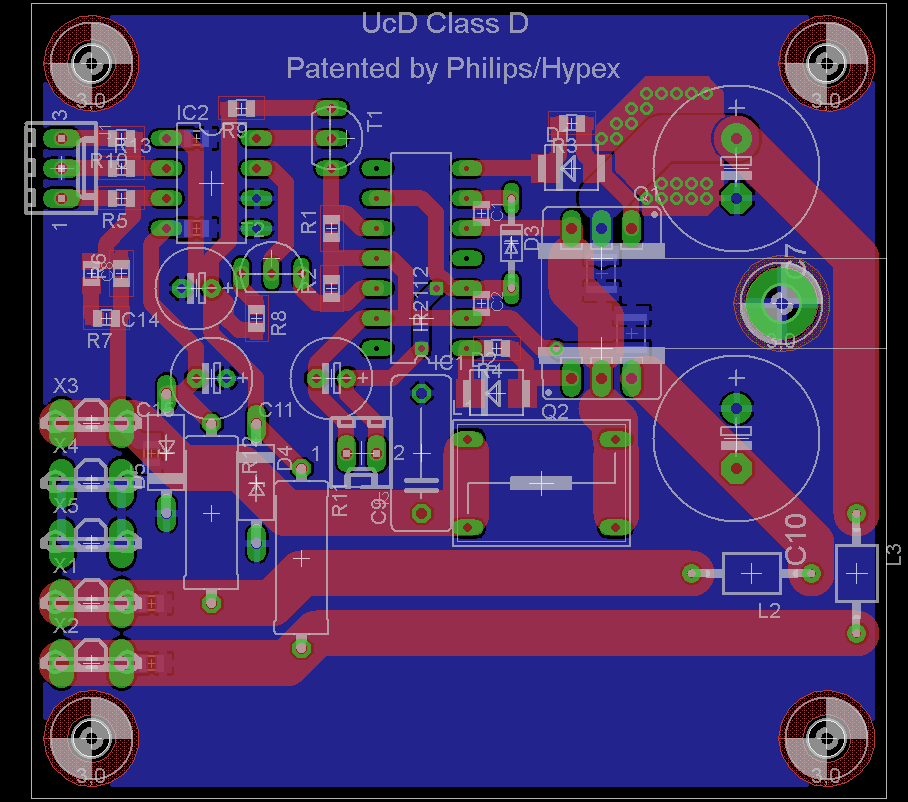

Just like suggested, this change in the layout has no effect what so ever on the AM interference. I guess this means it could actually be the output filter inductor alone.
I bodged it up on one of the modules for testing:
Like i said. your output inductor is sitting perpendicular to your signal processing section.
The leakage flux from a toroid is not like a solenoid. Well it is, but like the solenoid core axis was rotated 90 degrees, to align with the toroid diameter and in 30 positions at once. (for a 30 turn, even, single layer winding, that is). .. mainly canceling at short distances if the winding is even.
I don't think it is the position of the inductor that's his biggest problem, although as I said, I would hand wind it very evenly and fully shield it just because it is possible.
He doesn't have any signal lines running right under the inductor or anything.

I replaced the toroid inductor with one of these that is used on the L25D modules by LJM/sure/IR, also this with no change or even more junk on AM, its almost as if the original unmodded version produced the least amount of interference, as i can now find the thing on even the fundamental and several harmonics up as where the original only showed up at second and third harmonic.
Now we do not have any stations on AM anymore where i live so i do guess this might make the tuner extra sensitive as there are no stations to dilute AM reception/drown out the EMI from the classd module.
But as the Hypex and Abletec modules can run right beside a AM tuner without any kind of interference(wouldent pass EMC testing otherwise), this is the goal for my diy as well, ie pass EMC testing if i had such money to afford it.

I'm trying to help, not ask boring questions, but have you looked at all your switching waveforms to first make sure the the thing is actually operating as you imagine? No shoot-through, no ringing.. With all the radiation it's likely something unusually fast and high current is going on, because you don't have much of an teansmitting antenna to work with.

Shoot through issues usually also manifest as alot of heat in the mosfets.
