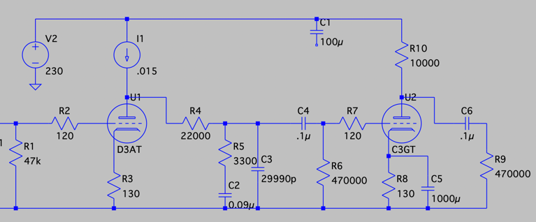

Increase size of cathode bypassed cap?

Nominal of katode cap depends to nominals of plate resistor and interstage cap.
There is diagram for depends. It is small, I tried to photo, but picture is bad. If You tell me nom. of plate res. and interstage cap, I will answer you.
Sorry for the delay - this is the schematic I'm using. This version has 1000u in the bypass position (C5), but the built version has 470u.
