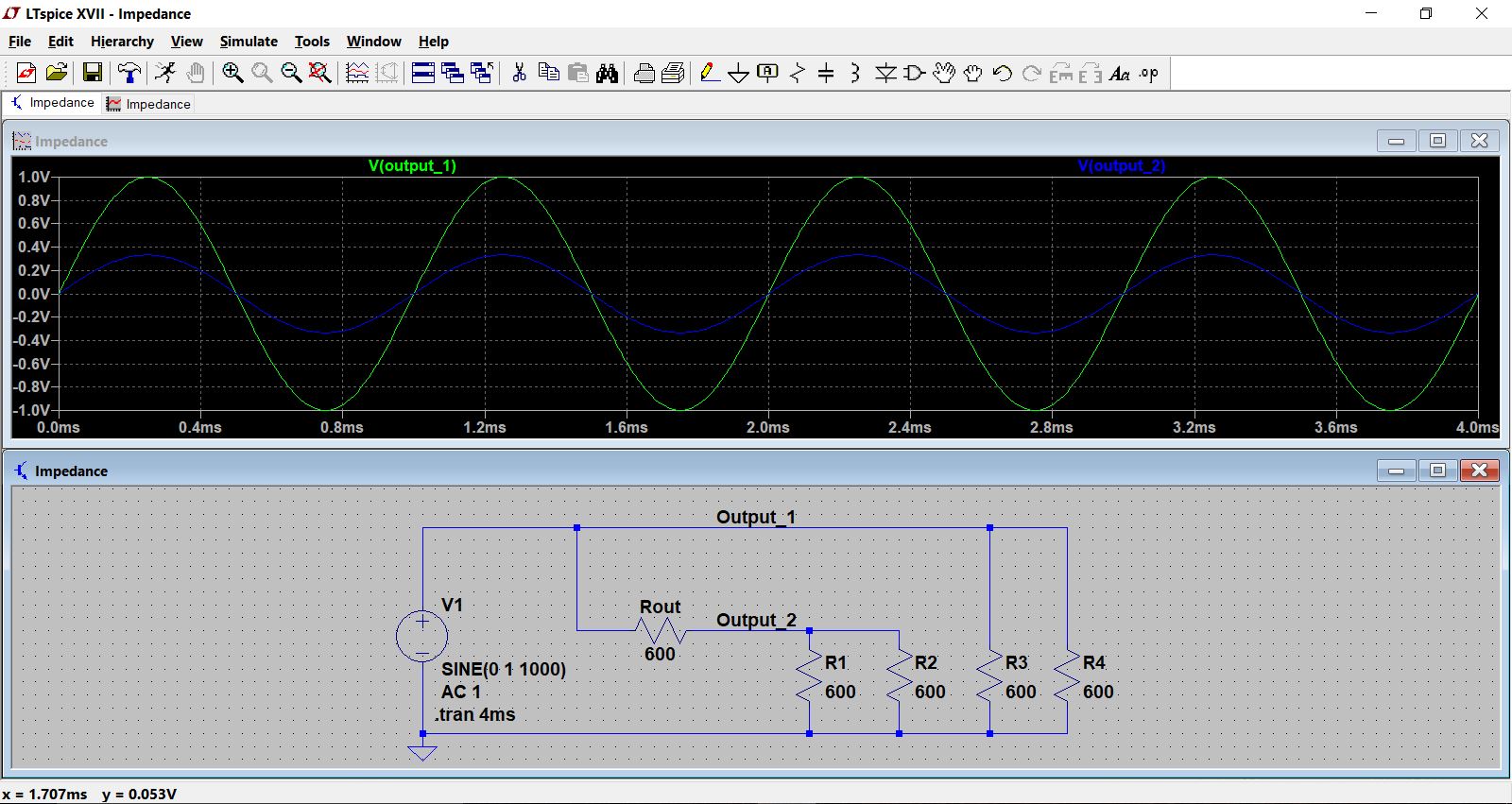

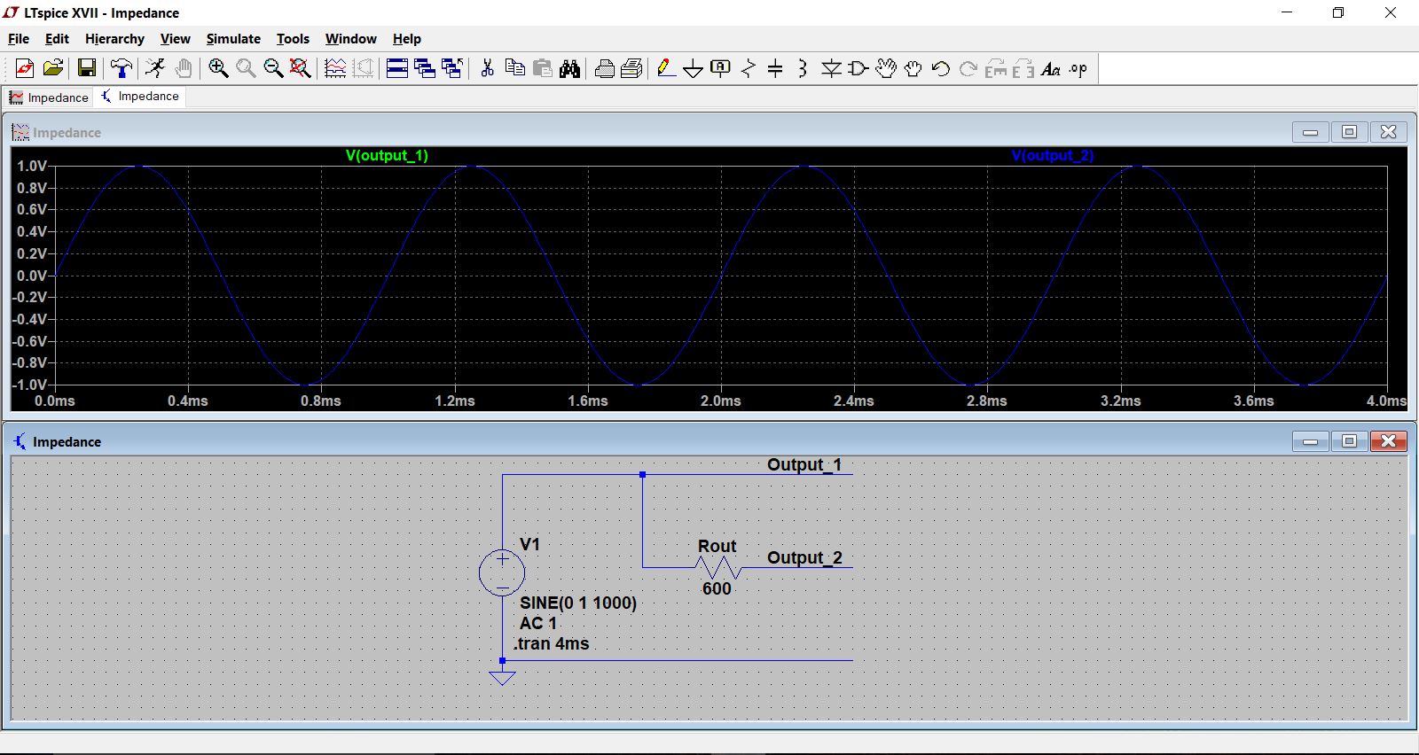

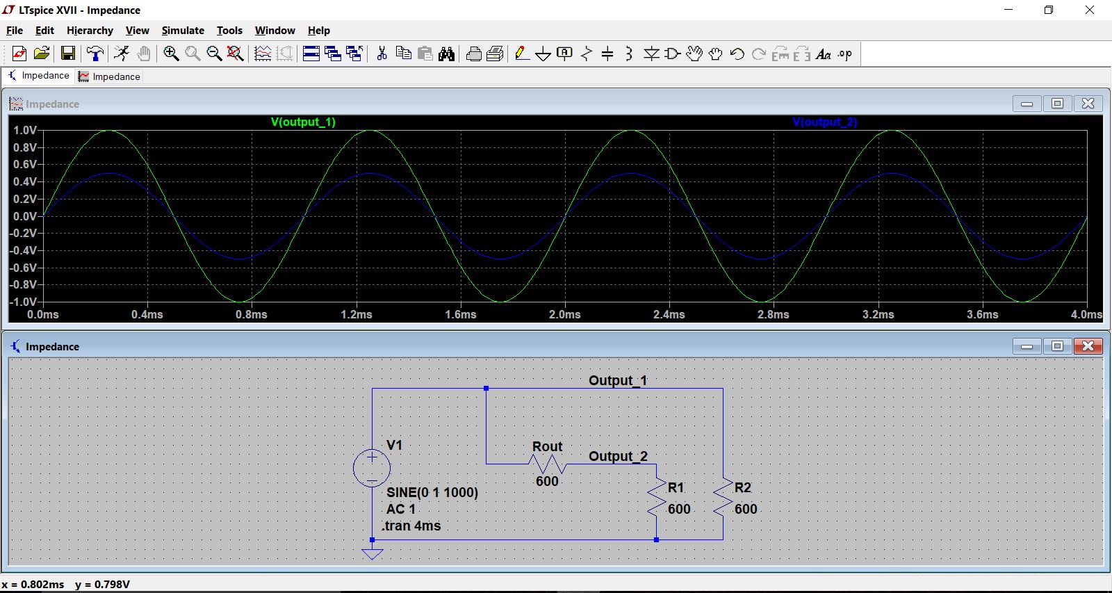

This is how impedance works in very simple terms.
The preamp output stage may be either a 'perfect voltage source', which most preamps come close to, or it may be configured to have a true 600 ohm impedance. The first example (the perfect source) may be described as '600 ohms capable' meaning it can drive 600 ohms without issue. That is really the most likely scenario.
If the preamp is giving 1 volt output we see that both outputs also have 1 volt present. The two traces overlay each other as both are the same.
Now we connect a 600 ohm load to each. The first output, the 600 ohm capable doesn't change, the true 600 ohm sees the voltage fall by half as the voltage is split equally across the two 600 ohm impedances.
Now we add a second 600 ohm across each. Again the 600 ohm capable output simply maintains the level. The true 600 ohm output sees the level fall again as now two thirds of the signal are across the 600 ohm and one third across the (now) 300 ohm load.
So the big question is what the output of the preamp is. Is it a true voltage source capable (as most preamps are) or is it really 600 ohm.
You could check this with a test tone (around 400 Hz) and measure the AC voltage at the output pins of the preamp. Set the volume to give say 1 volt AC and then add a resistor load (say 470 ohm or 680 ohm) and see if the level drops. If it drops a lot then the output really is 600 ohm. If it maintains level then its more of a perfect voltage source.
